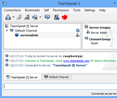

To be able to play x86 games on your Raspberry Pi you will need to get some special software - ExaGear Desktop. It will let you run not only your favorite games, but also lots of x86 apps (like Spotify, Teamviewer, Skype, etc.) on your RPi. You canget it from the corresponding website.
