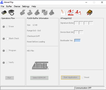

Step 3: Convert Arduino Into an HID Device
The Arduino UNO and Nano boards cannot use the 'Keyboard' library natively for keypress actions because they lack the necessary USB HID capabilities. To enable this functionality, you need to flash the Arduino with modified firmware to convert it into an HID (Human Interface Device).
Instructions:
I've found a helpful YouTube tutorial that walks you through the firmware flashing process. You can follow it here.
Important: This process will temporarily change your Arduino's firmware. You can revert it back to the original firmware later if needed.
