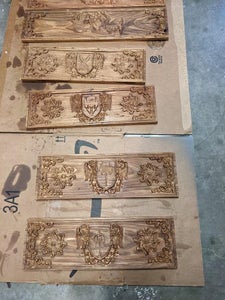

Step 5: Designing and CNC of the Faceplates
The CNC faceplates for this table took a lot of trial and error to get the look that I wanted. We are sharing the base design needed for you to replicate the framing style that we used. Because we used a lot of paid models we can't share the completed designs, but have linked below many of the 3D models we did use.
We used the same base frame for each piece, sized appropriately, and traded out the inside designs. There were a significant number of sizes of plates created. Your exact sizing may vary. These were then carved using a 1/4" endmill, an 1/8" ballnose and sometimes a V-groove bit.

Step 6: Assembling the Faceplates and Hinges
Next on the assembly list was getting the hinges just right. Drilling down into plywood was not the best choice we could have made. Given a second chance we would use solid wood for our hinges. The main trouble point here is that the screws wanted to drift slightly and not go in completely straight because of the lamination. This pulled a few hinges off to the side. Overall it still worked, but this was definitely the hardest part of the entire build.
Once the hinges were in place we could glue on the fold out portion of the player station. We added a thin piece of plywood to the underside of our wood so that the plywood would become the writing surface. We did this because our wood was wormy wood, and the holes didn't make for a great writing surface. The stations are just long enough for a sheet of paper. Upon testing this size is working well for us. If all your players bring laptops, dice towers, and books it may not be enough for them.
The faceplates were relatively easy to glue on. We didn't cut the exact width of these until we were ready to assemble. We wanted as tight of a fit as possible. This meant adding a few fractions of an inch here or there. Would definitely recommend slightly oversizing and shaving down. Expert woodworkers might not need this wiggle room, but we definitely did!
