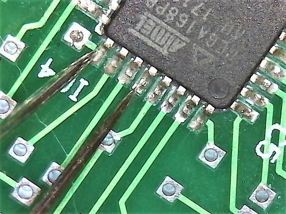

Figures 17 and 18 are of the receiver’s PCB. Figure 19 is the schematic I developed by tracing the PCB connections. The TSOP31238 is an IR receiver for a 38KHz carrier frequency using OOK, On Off Keying, modulation. The output of the TSOP31238 has a high to low transition when a 38KHz IR signal is detected. The circuitry connected to the VOUT pin is a pulse forming network that uses transistor Q2 to short circuit the 6 volt supply to ground, from the controller, for about 440 microseconds. This is the signal seen by the controller to determine if there is an obstruction.
Step 7: Reverse Engineering Continued:
Figure’s 20 and 21 are of the transmitter’s PCB. Figure 22 is the schematic I developed by tracing the PCB connections. In this circuit the LM393 implements two relaxation oscillators. IC1A generates a 250 microsecond pulse every 6.4 milliseconds. This pulse enables IC1B, which oscillates at about 38kHz for about 250 microseconds. The 38kHz signal drives the transistor Q1, which drives the IR Emitter. The resistor R17, a 47 ohm resistor, limits the current through the IR emitter. Figure 23 is the voltage across R17 displaying 10 current pulses of a 38 kHz carrier signal. Figure 24 is the timing between the 38kHz bursts.
