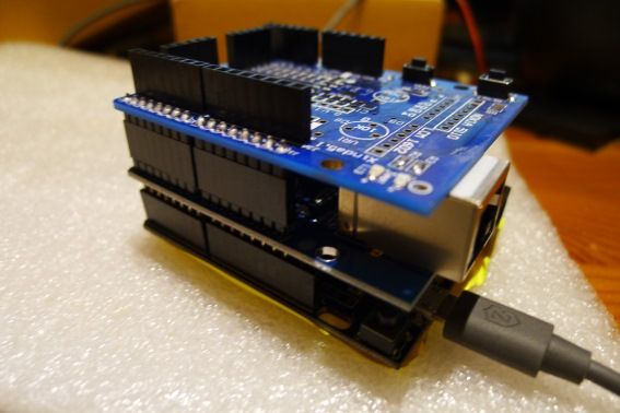

The initial hardware preparation involves putting the Arduino together and getting the garage door remote ready for wiring. I've combined these tasks into this step.
Once you have the parts, assemble the Arduino components (Arduino, ethernet shield, prototype shield) into a stack like this. Pretty simple.
