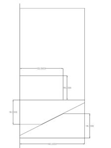

Step 1: Cut List
so you just need to cut away the stuff that does not look like a golf caddy,...see the cut list
I used a straight edge and a skill saw and then sand down all the edges smooth.
you don't need to be really exact on the dimensions just make sure that both sides are the same and all will be good
I used 1x3 pine for the cross supports but you could cut these out of plywood ...get creative
