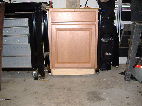

I used a piece of PCV pipe just laid across the two pipes to serve as a hangar for this paint project.
The size was 7' x 4' paint booth. It's small, but I had smaller pieces to paint.
Some thoughts about this.
I found the smell of the paint was still everywhere in the garage. I am sure particles find there way around the garage. However, it was much better than just spraying without it.
In that confined of a space, even half a can of paint can become overwhelming. Proper safety is paramount!! Full respirator, clothing, etc.
I imagine humidity could become an issue in there. I was painting in the evening and it didn't seem to be an issue.
The tail left on the floor was a very helpful thing. I would come out of the booth, take off my protective gear and leave it. I was able to immediately escape inside without spreading paint throughout the garage or tracking it inside.
Wrapping up the plastic wasn't difficult, but I think unwrapping it without giving the paint time to dry will cause me issues.
Anyways, this worked out great for me. Took me 20 minutes to setup, 20 minutes to take down. Nothing compared to the time it took me to sweep up and clean the garage when I sprayed without it!
