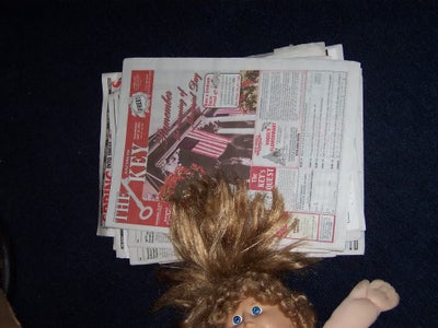

Smelly Sally is basically two parts...A doll and a sardine can. Much of the doll portion is made of newspaper. I like to use "The Nazareth Key," which is a free weekly newspaper that comes in the mail. I don't read it. But I save all of the issues in a bin for times just like this. 'The Key' isn't really a "newspaper" since it doesn't actually report any news. Mainly it is just full of advertisements and announcements for Kiwanis club meetings, Dean's list, etc. But since it is printed on newsprint, I will call it "newspaper" from here on. Let's not get stuck on semantics. The sardine can is constructed of wood and cardboard.

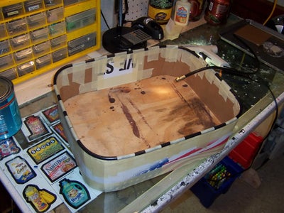

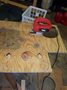

While my balls were drying I set off to construct the sardine can that Sally would spend most of her time in. Using the proportions determined from the sketches, I made a template out of cardboard for the bottom of the sardine can. The stuff that most people refer to as "cardboard" isn't actually cardboard. It is called "corrugated paper." You know when you buy a notepad or notebook there is usually a stiff piece of board in the back to give the pad some stiffness so it is easier to write on? Well that stuff is "cardboard." The material that makes-up a "cardboard box" is actually "corrugated paper" and a "cardboard box" is properly called a "corrugated carton." "Corrugated paper" is a piece of convoluted paper (i.e. it looks like a wavy line) sandwhiched between two pieces of paper. I learned all of this while I worked at a corrugated box factory for two summers during college. But since I am calling 'The Key" a newspaper and a 'paper layering technique' papier mache I have no problem calling 'corrugated paper' cardboard from here on. Why break precident? I found some scrap plywood in the garage and, with the help of a jigsaw, cut out the bottom of the sardine can.
I used some more cardboard to form the walls of the sardine can. I made a double layer to create a good thickness (plenty of glue between the layers) and attached the walls to the plywood with a staplegun. I covered the staples with masking tape so they would not cause any unusual texture after paper mache-ing. To create the rolled lip around the edge of the sardine can I used an old section of coaxial cable. I taped this to the edge to hold it in place until it is covered with paper. On the Smelly Sally card, the sardine can is open which creates a torn-away feature on the inside of the can. I used more cardboard to do this by tracing the perimeter of the sardine can and making a jagged-edge. This piece was then glued and taped into place.

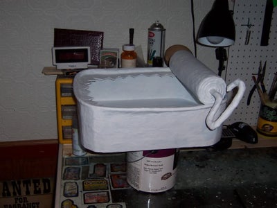

To make the roll I used a piece of posterboard rolled-up and taped. Then I used more wire clothes hanger to create the key. I covered the wire with newspaper and lots of tape. I closed both ends of the roll with a circle of cardboard and inserted the key into one end through a hole that I cut. The key was glued and held in place by lots of tape. Now I could determine the length of the arms by positioning the body inside the sardine can and holding the roll in place.

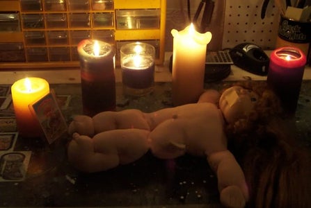

Step 6: Ritualistic Decapitation
At this point it was time to remove the head from the original doll’s body. To do this, I like to light some candles and turn the lights down. I then lay the doll upon the alter (my work bench). The actual head removal takes only a few seconds so it is best to draw it out as much as possible with theatrics. Put a piece of tape over the doll's mouth. The heads of these dolls are attached with a regular nylon zip-tie. So a quick snip with a razor and the head is removed.

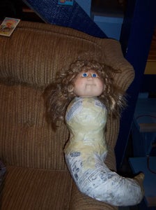

Since my balls were now dry I could attach the body ball to the tail. With a razor knife I cut a hole in the tail piece to accept the body ball. I used some glue and lots of tape. It was important to give the body a nice hour-glass shape. Next, I marked and fit the hole for the head. I couldn’t make the arms quite yet because they needed to be a specific length so that the left arm would touch the sardine car correctly. So I had to work a bit more on the sardine can, particularly the roll and key.

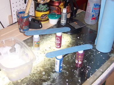

At this point the body and sardine can are ready for the paper mache skin. For this I like to use wallpaper glue and paper towels. The best paper towels I have found are made by Kimberly Clark. They are called Shop Towels and they are blue. The reason I like these is that they are very strong, flexible and stretchy. They can easily traverse any corner without causing a crease. I like to use wallpaper paste that is specifically for bathrooms and kitchens because it has anti-fungal agents in it. I tear the shop towel into little bits and discard any of the edges. Using a paintbrush I coat the entire piece in paste. Then, as I apply them, I coat each papertowel piece with paste and smooth it on with the paintbrush. Each piece overlaps until the enter sardine can, arms, and torso are covered. This dried overnight and then got a second coat of papertowels.
Once the second coat of papertowel dried I brushed on a coat of straight white glue. Thinned white glue will not work here because the water causes the papertowel to swell, potentially disfiguring the work. Once that coat was dry, a second was applied in the same manner. The glue acts to seal the paper and also fills-in any uneven blemishes. The paper towels have a definite texture that is unwanted. The glue fills that in and makes it smooth.
