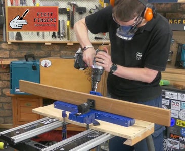

Step 4b: . Flip everything over, the pocket holes will go along the long edge of 4 of the 5 slats and in the back naturally. Mark the spots on the back where you are going to drill the holes with a pencil or chalk so you don't get confused later. I space mine every 200mm (8") or so starting 50mm (2") from each edge. (I alternate my spacing but there is no real need to do so).

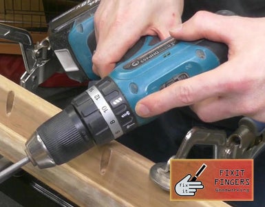

Step 4c: Set up your pocket hole jig for your material thickness (19mm / 1 1/4" in most cases but check your decking thickness carefully).
Step 4d: Drill out your marked pocket holes using the jig. I used an incredibly tough Aussie timber called Spotted Gum. 95% of decking out there will be much easier to drill, I had to take it nice and slow. Don't forget the dust extraction, it really helps.
Step 4e (Optional): I applied a thin coat of polyurethane glue along the edges of my boards before screwing them together.As usual with pocket holes, this is not really needed as the screws are more than strong enough. However, as I didn't joint the edges of the boards and I wanted the top to be very waterproof, I decided to take this step. Spotted Gum is very oily so regular wood glues are not as effective. In most cases, regular waterproof wood glue will be fine.

Step 4g: Set the clutch on the drill and drive in your pocket screws to secure the slats together. Don't forget to use "C" (Course Thread) screws for pine and "F" (Fine Thread) screws for hardwoods. If you used glue don't forget to remove the excess squeeze out before setting aside the panel to dry. (Polyurethane glue especially as it expands and is hard to get off once dry! If you can keep the panel in the cauls while the glue dries all the better.
TIP: If like me you are using ridiculously hardwood, you may be at risk of splits. Normally pocket hole screws are self-tapping. However, if your test pieces split like mine did, it is worth the time pre-drilling with a long 3mm (1/8") drill bit after clamping up and before driving your screws to help avoid this.

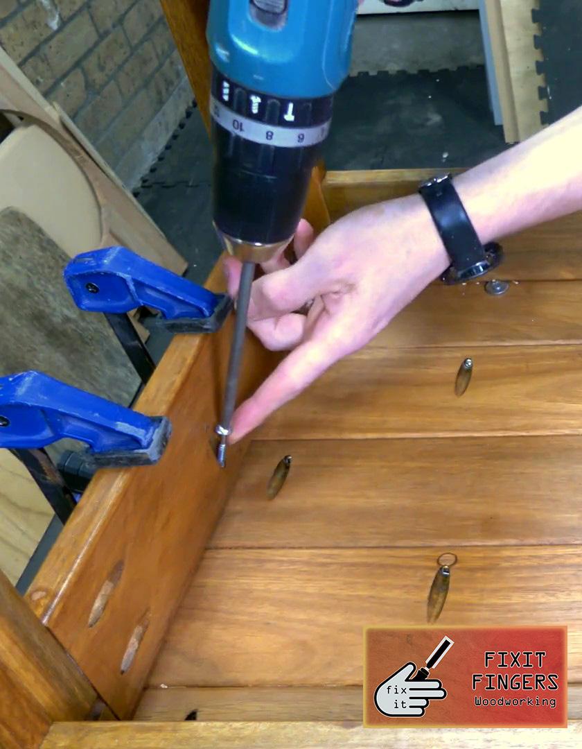

Step 5a: Assemble 4x L-Shaped Corner Legs by drilling 4 pocket holes in each and securing them together with pocket screws. Ensure the bull-nose (rounded) outside edges remain facing outwards (See Photo 2).
TIP: Kreg Face Clamps are ideal here but really most clamps styles will be fine, whatever you have on hand.

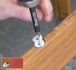

Step 6b: Now we can mark out and cut the eight little mortises for the Figure 8 Mounting Clips. 3 ways you do this. I used my router set to exact thickness of a clip to quickly make these cuts. If you lack a router, a forstner bit in a drill can work if you are careful. Otherwise the good ol' hammer chisel can also achieve this with care.
TIP: If using the router, clamp a couple of scraps either side of the stretcher to give you a more stable platform to work on.
Step 6c: Drill the pilot holes for the Figure 8 screws in the stretchers while you are at it too.

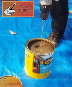

Step 7a (Optional): I used new Spotted Gum decking which is a very tough Aussie hardwood it is resinous but doesn't leach colour so I skipped this step. If you use Merbau or other tannin-rich woods that are prone to leaching for a long time when wet unless pre-treated, this is something you need to consider. Click here to check out my video on how to Pre-treat resinous woods before proceeding. You'll thank me for it later as tannin stains are nearly impossible to remove.
Step 7b: Stir your oil or finish well. (A stick will do, but I like these cool drill stirrers.)
Step 7c: Apply the recommended number of coats of your chosen finish as per the instructions on the side of the can and set it aside to dry. Clean up any runs and drips so the colour is even and smooth.
TIP: Decking oils should be reapplied with a touch up coat every year to maintain their protection, so don't worry if you have leftovers, you'll need it in 12 months to keep your hard work looking its best.

Step 8b: Screw you Figure 8 clips into the frame mortises. When tight, back the screw off a 1/4 turn to give the clip a tiny bit of movement. Angle the clip off centre slightly as this will again help with expansion and contraction of the wood.
Step 8c: Carefully position the frame upside down on the top. Centre it ensuring the overhang is even on all sides (if you have one, otherwise ensure it is flush). Drive in the pocket hole screws first, then pilot hole and drive in the screws into the Figure 8 clips.
Your top is now secured to the frame in a way that will be solid, but allow seasonal wood movement.
