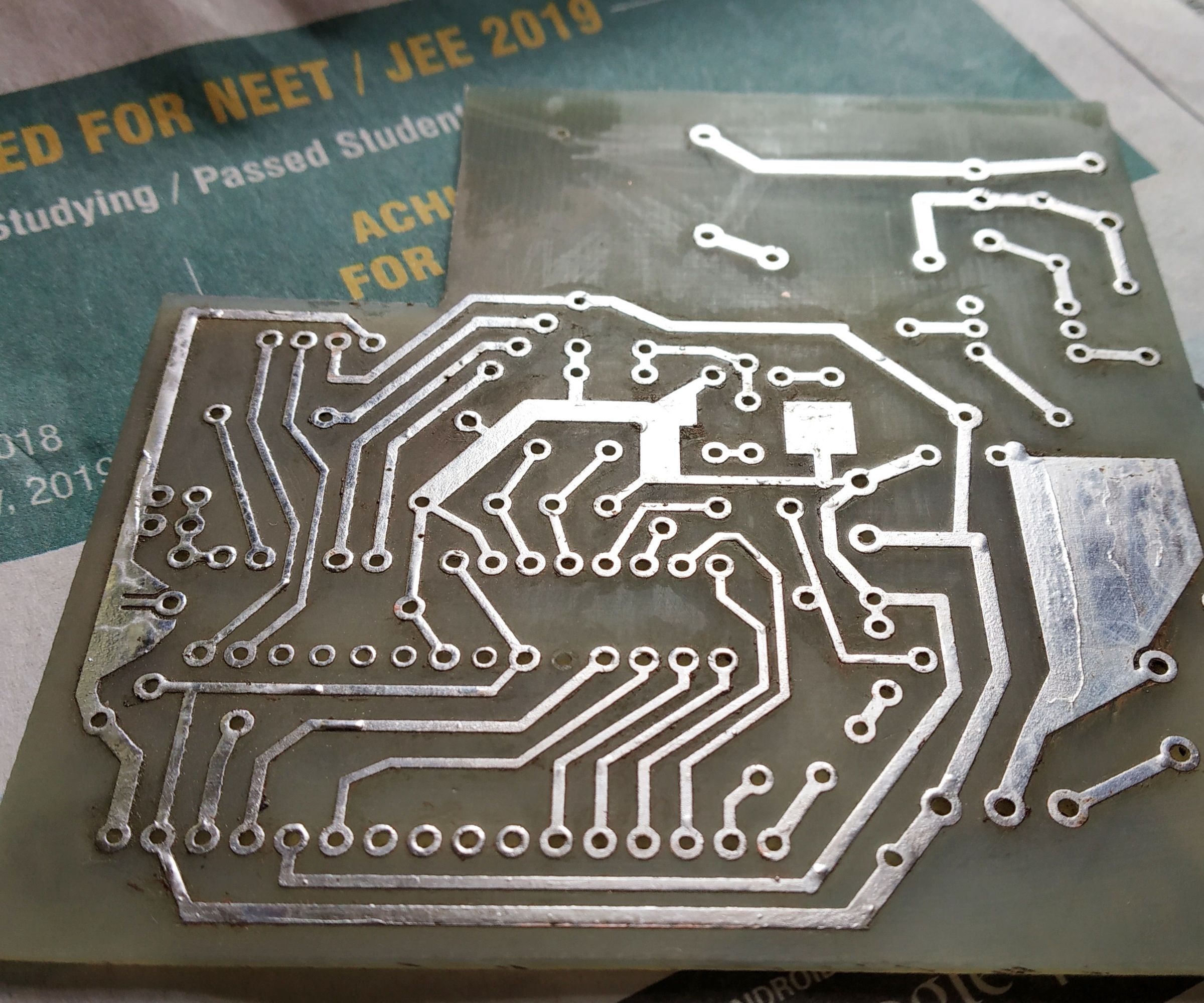

Step 2: Fitting of Various Parts
Step 3: Product From All Angles
Step 4: Arduino Program and P.C.B.
Step 5: Ready to Use
