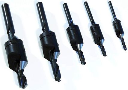

- drill-bit with counter-sink

Each leg consists of 4 parts, two of which have one or two notches. Pine can break easily so i always drill holes (with countersink) to make sure that doesn't happen. The countersink also makes for a nicer end product.A drill of 3-4mm is more then enough.

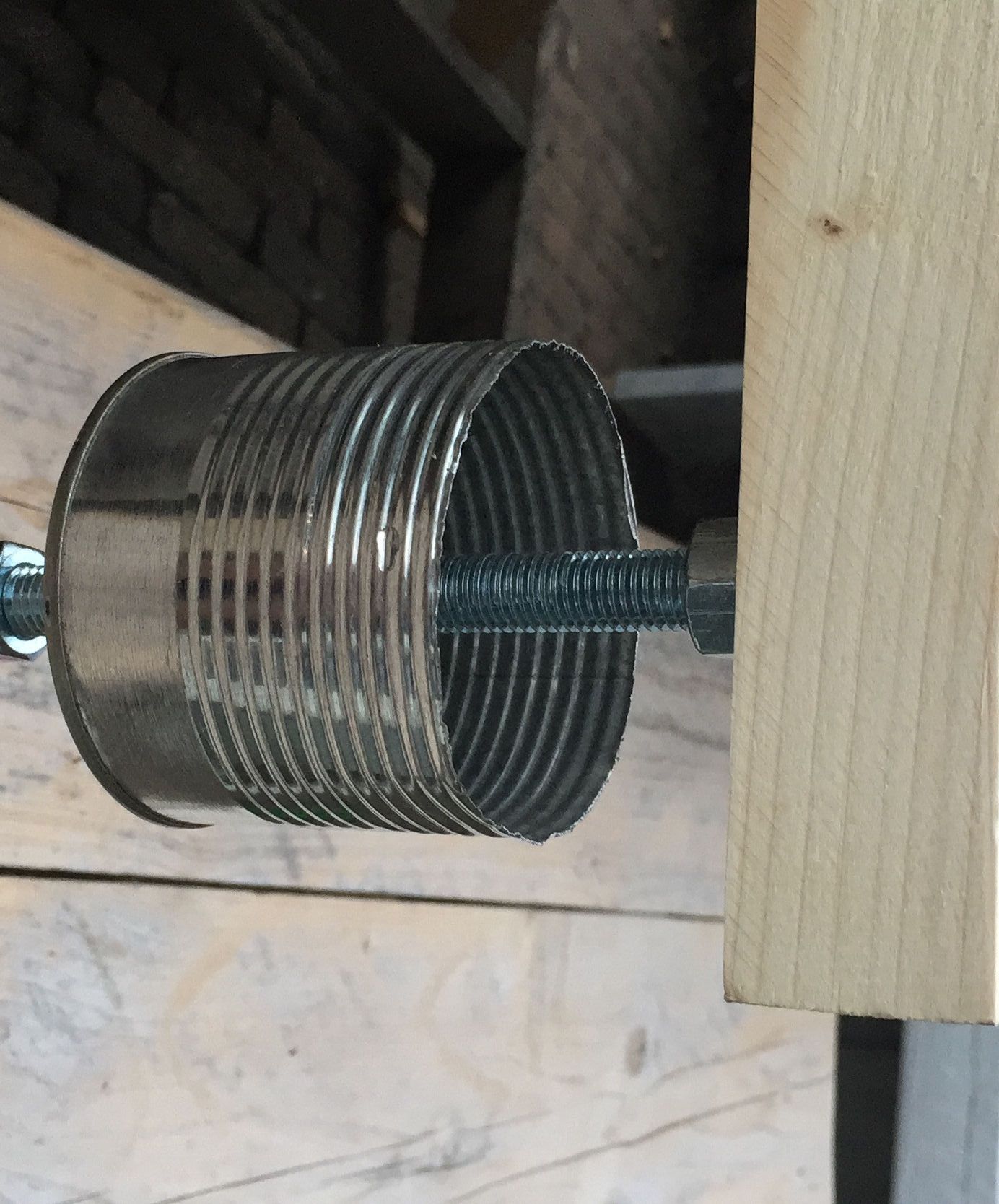

Make sure the table is square and true at this point.Use woodbolts to secure the single-crossmember to give it more strength. Same goes for the legs as mentioned before.
