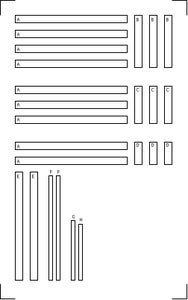

Step 1: Materials
- Woods
A: 150cm x 5cm x 1,5cm
B: 32cm x 5cm x 1,5cm
C: 23cm x 5cm x 1,5cm
D: 14cm x 5cm x 1,5cm
E: 90cm x 5cm x 1,5cm
F: 89cm x 3cm x 3cm
G: 40cm x 3cm x 3cm
H: 38cm x 3cm x 3cm
- Many screws
Step 2: Built
Cut, pierce and assembly the wood as in the photos.
Cut the pieces E is after the assembly of the structure for most precision.
The structure is solid and does not need to be anchored to the wall.
See the notes into the pictures for understanding the pieces of wood of the project
