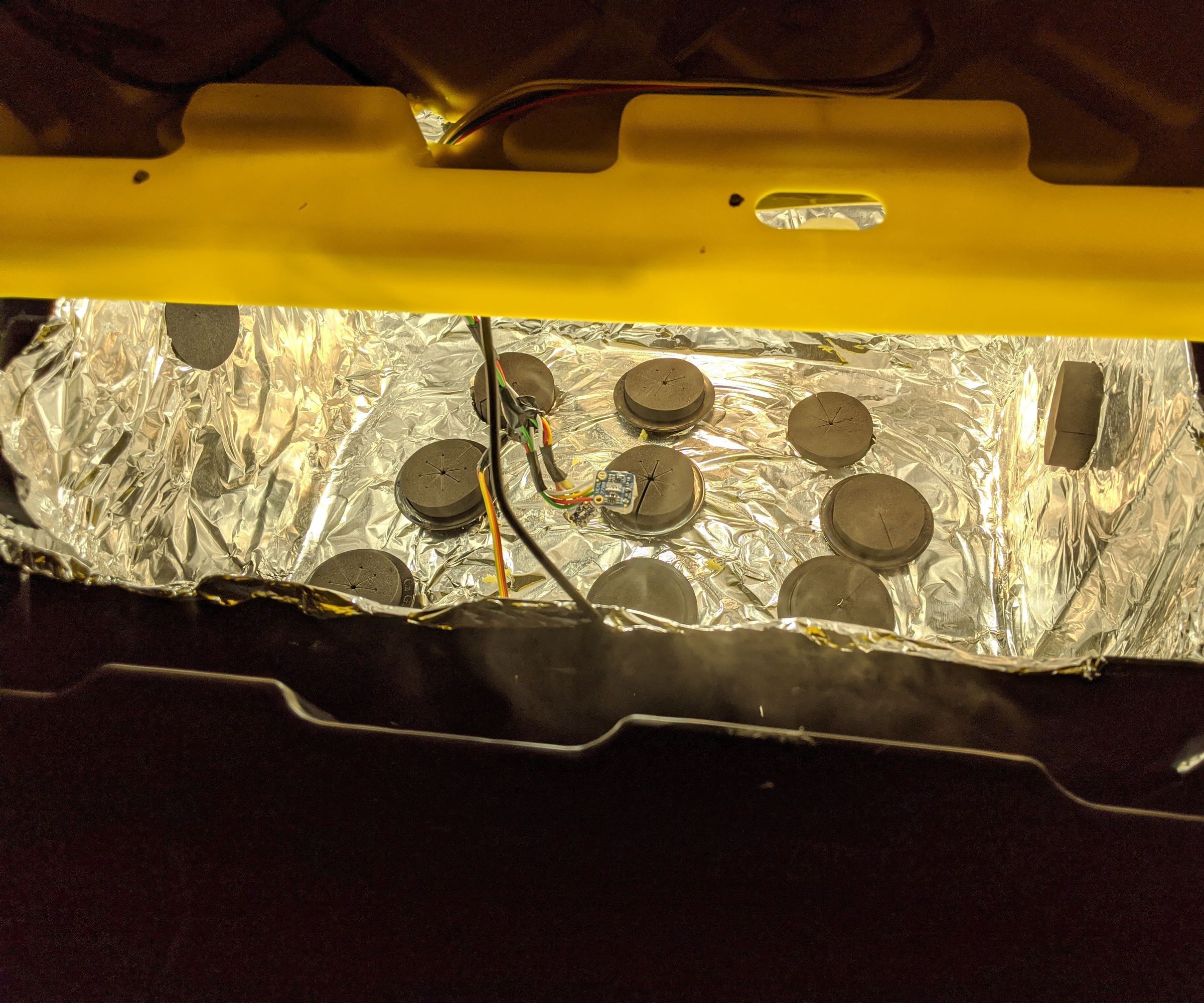

Garduino is a gardening Arduino. So far, Garduino:
-Waters my plants whenever their soil moisture level drops below a predefined value.
-Turns on grow lights, but only when it's dark out and only long enough to make the plants get 15 hours of total light (sunlight + supplemental light) daily.
-Alerts me if the temperature around the plants drops below 50 degrees.
This is the first grow-light and auto-water setup i know of that takes into account natural sunlight received and soil moisture level before turning on water / light.

Step 2: Sprout Your Plants
Get your plants going by sprouting them. There are lots of guides and devices to help you do this, so I'll just mention that you can use the vermiculite watered regularly and placed in a windowsill as an ultra-basic sprouting setup. Here is my favorite sprouting setup, and here's a useful chart on sprouting times for a bunch of different plants. Make sure you remember to rinse the sprouts regularly, or they can get moldy and gross.
If you're smarter than me, you'll label your seed grid so that you can remember what is growing in the different areas of your sprouter. Below is my attempt at this, rendered useless when I planted the plants in random disorder.

Step 6: Make and Populate Your Soil and Planters
Let your creativity run wild here, with a little advice:
-Your inner pots (in my case, the milk jugs) should allow water to drain out and rest on top of bricks to provide space below them. I nearly killed some lettuce because of over-watering and a lack of drainage... thanks to ~20 nail holes on the bottom of the jug, the lettuce is now recovering nicely
-Your outer planter should not leak, unless you really want water all over your house
The soil I used is the Mel's Mix described in step 1. Mix all ingredients well to a consistent soil.
Planting's basically a matter of burying the bottom half of your sprout in the dirt and hoping for the best. Be sure not to plant too densely (like I probably have); you can get recommendations on planting density via the back of your seed packets.
