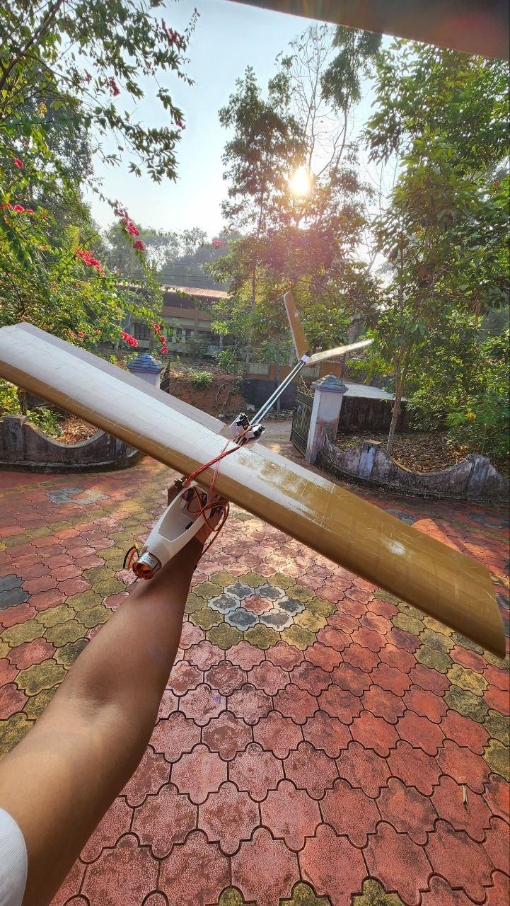

This is a UAV I started building as a part of Winged airplane competition by Cognizance IIT Roorkee (24th march) Techkrithi (28th march)

Step 1: Cad Design
The main body is going on iterations as of now , will share the files after further more arial testing's
Step 2: Wing Design

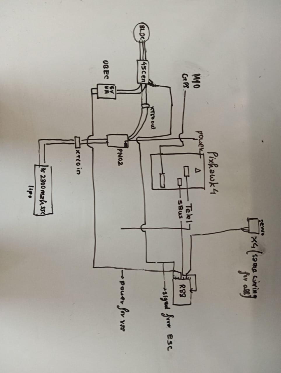

Step 3: Circuit
All the wiring is plug and play except the 5V 5A Ubec
Step 4: Mission Planner Setup
First we need to configure joystick and pixhawk , all other components gets automatically configured.
Setup( UI is changed yet its easy to adapt):Ardupilot Flight Modes, Failsafe, Telemetry Radio Setup APM mission Planner - XUAV Mini Talon Part 7
Joystick config:Beginner's Tutorial: How to Control your Drone with a Gamepad - Mission planner - Pixhawk Drone
Telemetry config:Ardupilot Telemetry problem fix using mission planner and ft232rl
Step 5: Testing Fight and CFG
First flight was a total failure, current super busy with endsem:).
