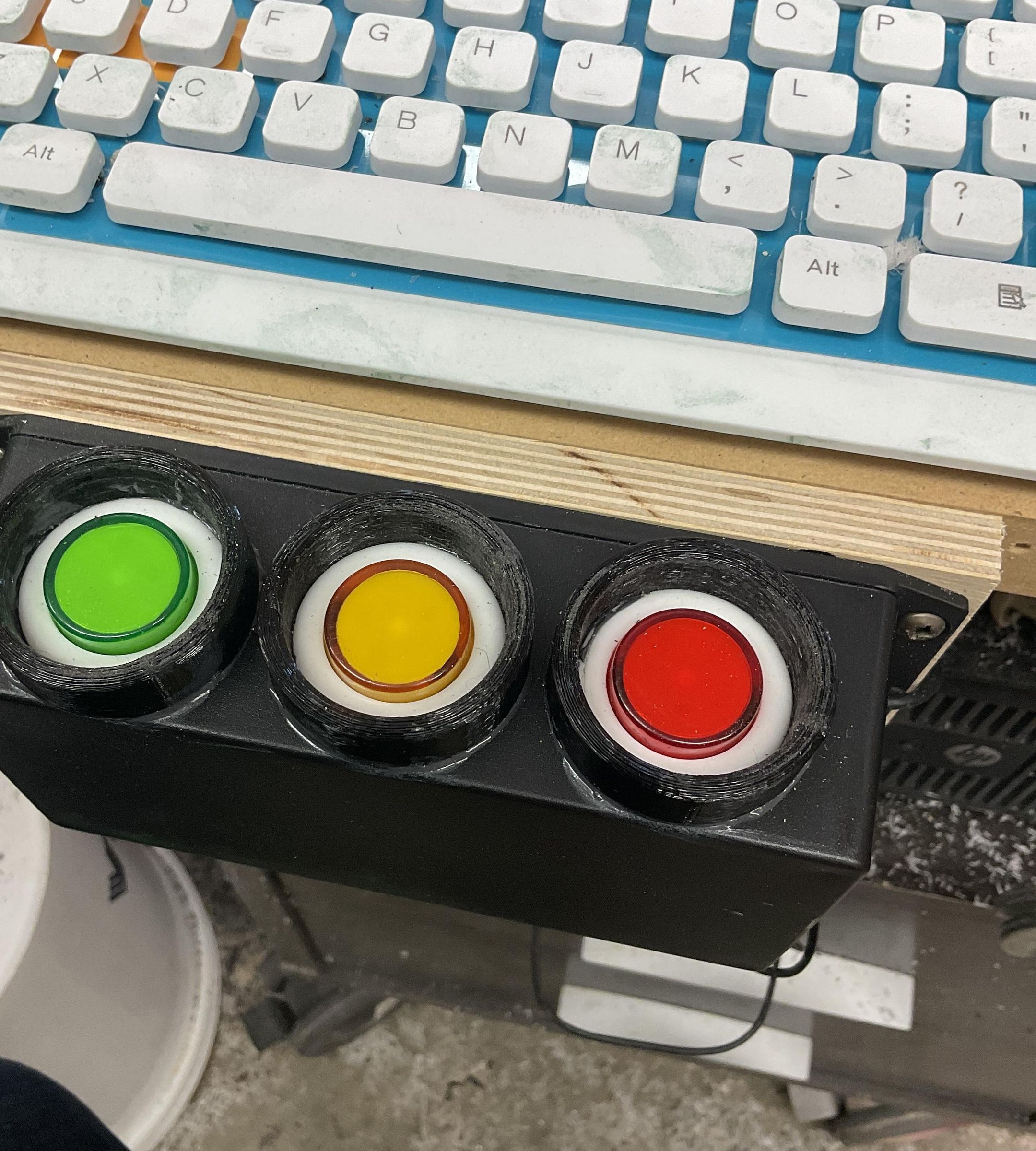

The controller is based on the Arduino Uno (I used a Sparkfun Redboard which is equivalent). A switch can turn the burner on locally, or it can be turned on remotely via a single TTL active low signal on its Command Input.
The controller shows its status via 3 leds for Off, Lighting and On states. A TTL Status line indicates on/off status for remote use by the brewery controller.

(3) leds
(3) 330 ohm 1/4 watt resistors

For ease of assembly, I assemble the parts on the shallower top of the box and use it as the control/display as well. The rest of the box can be mounted where you need it. If you need to do some work on the circuitry, you can simply remove the front panel and take it to the "laboratory"
Cut access holes for cables. Drill holes for leds, switch and cables.
Mount the Arduino, relay modules and leds. I just use a few dabs of epoxy to mount the parts. It's a little permanent and makes it difficult to replace parts, but it is "easy peasy"!
