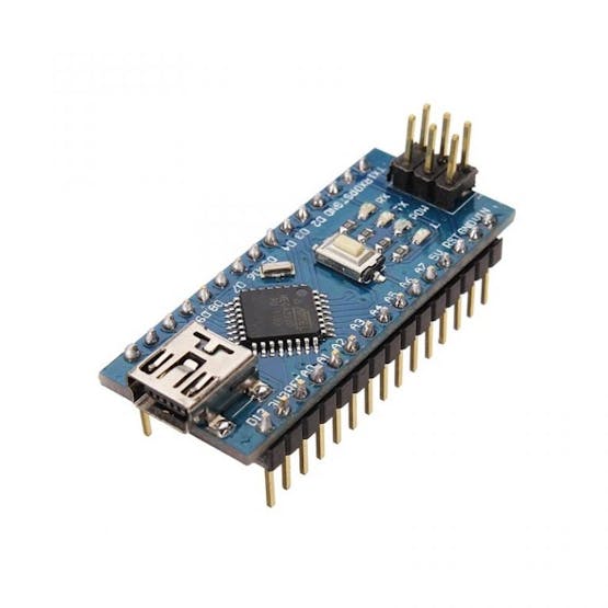

Arduino nano

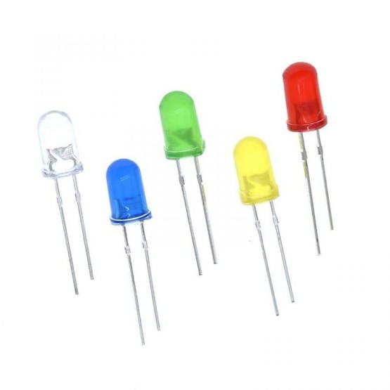

Six 5mm LED diodes of different colors

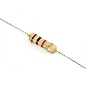

Six 1 Kohm resistors

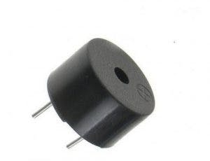

A 5 volt buzzer

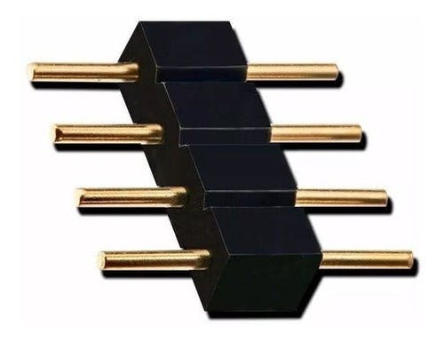

Female pins (4 pins total)
Male pins (2 in total)

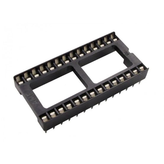

Socket for the arduino nano

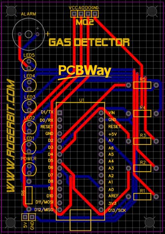

PCB

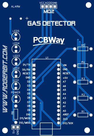

Download Gerber file –> Gerber_GAS_METER_MQ-2
Circuit
