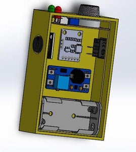

On many occasions it is difficult to perceive the smell of gas coming from a leak in the gas lines of our houses, a gas sensor is very convenient to fulfill this task, then we will build an economical and easy natural gas and LPG sensor with few components to build.

Step 1: Electric Scheme
English
We use the MT3608 Booster-step Up type voltage booster module because it is more efficient when converting from 3 volts from 2 batteries to the 5 volts needed to operate the sensor.
the sensor has a digital output that is activated when it detects a certain amount of gas, this activation is regulated by a potentiometer built into the sensor.

Step 2: Circuit Assembly in Box
see cad archives on: https://grabcad.com/library/gas-sensor-model-1

The design and implementation of an embedded prototype of a functional, intuitive and efficient natural gas and propane gas sensor is achieved.
