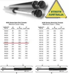

  • Gas strut, K4045 length 450mm, stroke 205mm and I had it charged to 180 Newtons. (approx 18kgs) Mill head weighs 17kgs. The column swivel bolt is 475mm down from the top edge.

My first thought was a pulley system with a 18kg counter weight hanging off the back somewhat like gym equipment. I then had a look around to see what was available, nothing locally and only kit imports. A few Youtube users were using 2 gas struts with a single wire rope.
I figured a single gas strut with a wire rope on either side would be a better choice to balance the forces acting on the strut, as well as a safety margin. If one rope breaks the other is strong enough to continue supporting the spindle head.
I first bought a K4046 strut with 2 x 8mm clevis, but then discovered that it was too long.
Next was the K4045 which fitted, but the clevis ends were too long, so I brazed together some nuts and was happy with the resulting assembly.
