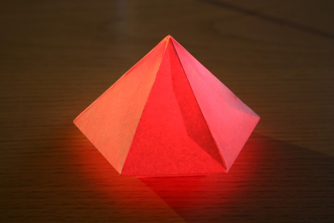

Step 2: Mounting the Parts
Next, you have to mount the parts into the housing.
Use the drawing provided in the previous step or create something yourself,
The 3D printed exterior has a mounting clip for the arduino built in.
The pictures illustrate how to mount the parts using the hot glue gun.
As you can see I used some small pieces of cardboard glued together for spacers and mounting supports,
this is particularly important if you want the reset button on the arduino to work properly.
Make sure to securely glue the parts into place but still keep the electronic contact points and button clean.
