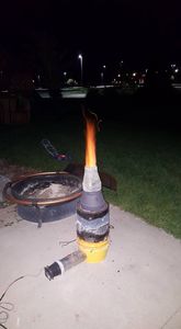

In a safe place to watch it burn, put the wash basin on the ground, attach the fan combo, and put the grill grate on top.
place the 5 gallon bucket on top of the grill grate, so that the handle is down, and out of the way( if it still has a plastic handle, it will eventually burn off.)
dump small twigs, some kindling, charcoal, paper, what ever you are burning into the 8 inch opening on top. don't pull a cave man and stuff it solid as a rock, but fill that thing up.
put the 8 to 6 reducer on top over the hole, and find a torch or long matches or lighter.
Using the 1/2 inch hole insert your lighting tool up under the fuel of your forge, and let it get going with some heat. if your don't used a bunch of kindling and fire starter, you will want to use a torch that can be left in the pipe for a bit.
Once you finally get it up to temperature, and have some flames coming out the top, power up the fan, and turn off the torch.
With the added air you will be lucky if there is not flames coming 6 feet up from the ground, and it will be very hot, I have had temperatures reaching 1400 F / 760 C
