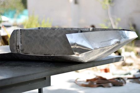

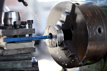

Firstly, we started our structure by cutting aluminum iron plates into pieces conglutinating them air tightly. In this point, we should say that our preference for the aluminum material was made for its great endurance and its light weight. Therefore, we had the opportunity to experience how to conglutinate aluminum using a mig welder. After connecting the aluminum pieces, we gave them the shape of a small boat keeping its upper surface closed and flat. Then, we had to place the engine at the back of the boat and put a propeller at its end. Next, using the lathe we made all the essential pieces in order to place the axis and the propeller on it and the particular pieces were connected to the engine of our boat.
