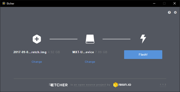

Step 2: Flashing Raspbian to Micro SD Card
  1. Download Raspbian or Raspbian Lite
  2. Download & Install Etcher
  3. Plug the Micro SD Card Reader with the Micro SD Card in it.
  4. Open Etcher
  5. Click on Select Image and browse the download location of Raspbian/RaspbianLite Zip
  6. Click on Select Drive and find the drive of your micro sd card reader.
  7. Then lastly click on "Flash!"
This could take 10-30 minutes so sit back, relax and eat pie :)

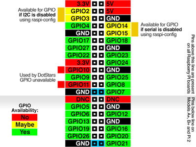

Adding LED Lights Response
In GassistPi Pin 05 & Pin 06 is Google assistant listening and responding but we'll be adding an extra led to let us know if google assistant is started
In main.py we'll add in #Indicator Pins
GPIO.setup(13,GPIO.OUT)
GPIO.output(13, GPIO.HIGH)
In ON_CONVERSATION_TURN_STARTED add this line
GPIO.output(13, GPIO.LOW)
You can download the main.py and replace your main.py in /home/pi/GassistPi/src
