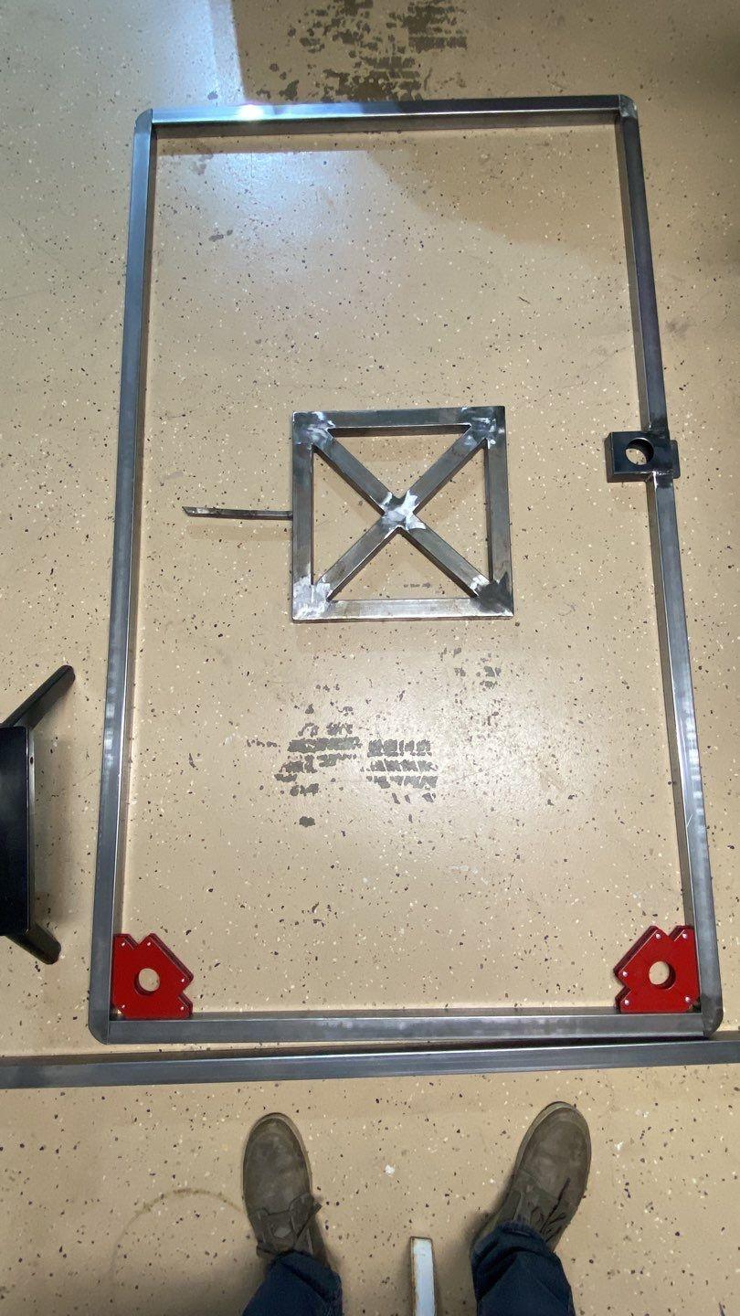

Step 4: Make Middle Piece
Cut all the corners at a 45-degree angle then tac and weld together. After that, then grind down until smooth.
Step 5: Make Corners Round
Step 6: Weld Frame Together
Use the magnets or clamps to hold together the pieces then weld together. Grind until smooth after
Step 7: Weld Frame and Middle Piece Together
Line up the middle piece with the center of the frame. Then weld pieces together.

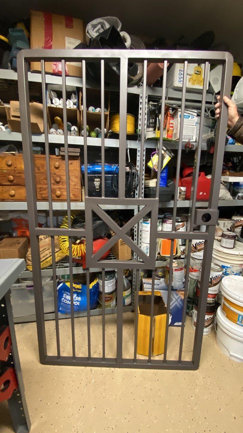

Step 8: Weld Middle Bars
Use the 1/2-inch square tubing for the middle bars of the gate. Then weld all pieces to the middle frame and the centerpiece. And then grind all welds till smooth.
Step 9: Grind All Welds Smooth
Just to make sure, grind and make sure all welds are smooth and to your liking.
Step 10: Support Pieces
Use the 1x1 inch tubing as supports that you will later drill into a wall. Then hinges will be welded to them. Add an end cap to the end of the tubes
Step 11: Prime and Paint
Once everything is smooth and grinded down, you are ready to prime and paint your gate

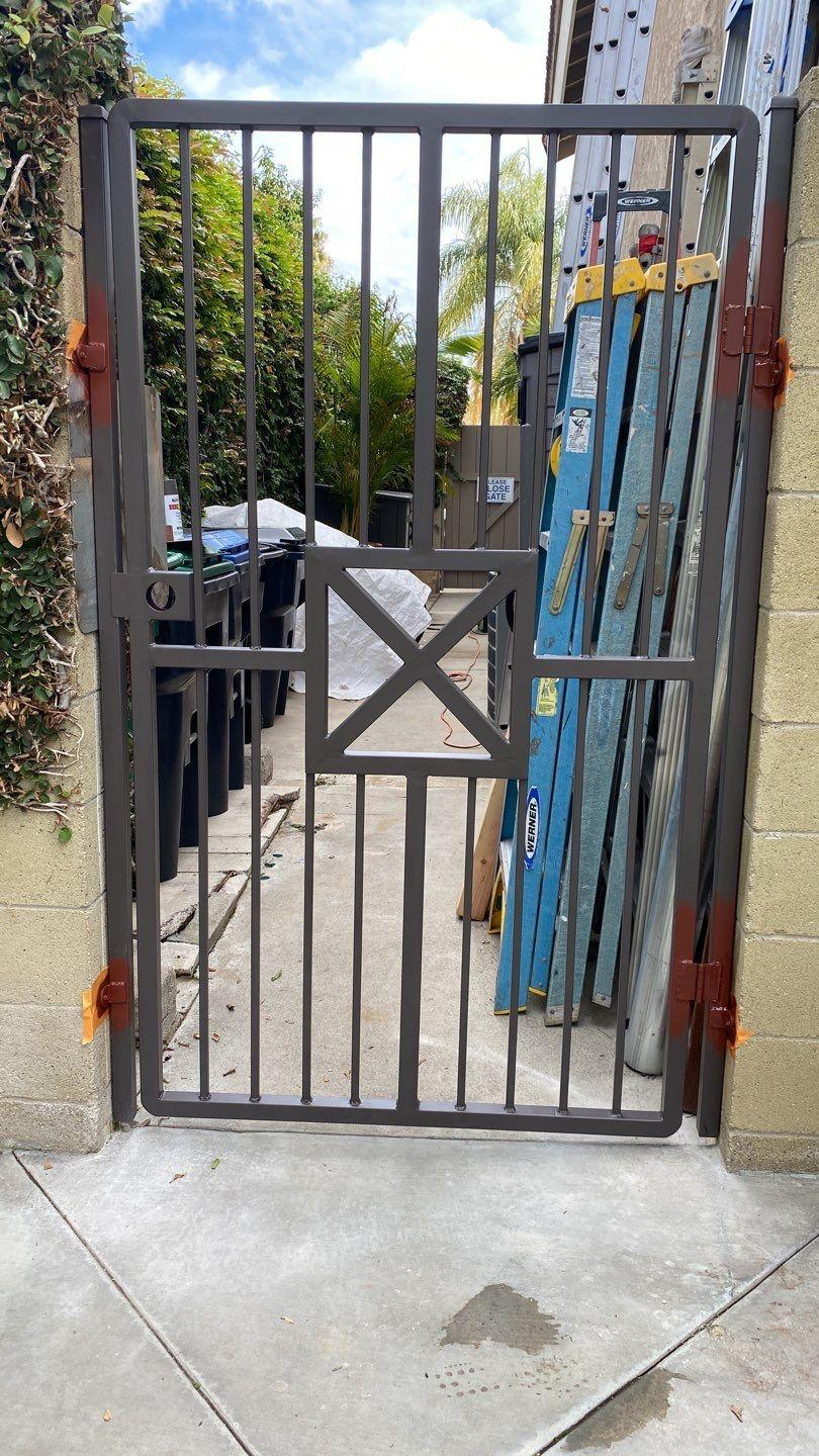

Step 12: Install Support Pieces
We ended up drilling into our wall to put in the support pieces and from there we welded hinges on them.
Step 13: Install Gate
Finally, you can install and weld the hinges to the support.
