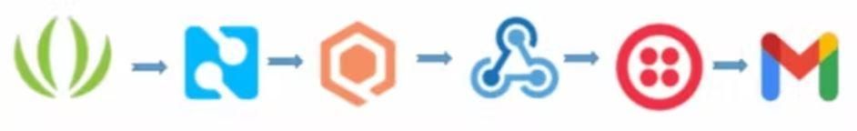

Qubitro is a Cloud Platform that allows visualizing the data from multiple data sources like MQTT, TTN, HTTPS, Helium, etc. You can check Qubitro.com for more additional details. Now to complete the setup procedure, You need to Go to portal.qubitro.com and Create a new project. After that add a device with an MQTT connection. You will see the connection credentials, note them somewhere because you will need them moving ahead. Now go to the Route tab on the Blues Note hub then select type as MQTT and enter the credentials as given below:-
  • Set the Username to the Qubitro Device ID.
  • Set the Password to the Qubitro device token.
  • Set the Topic to the Qubitro device ID.
Now go to the environment section on the Blues Device and change the content as shown in the image above.
After this, open the qubitro portal and look for the incoming data from the Notehub you will see some data received from the note hub, but the data will not be there in a readable format. To make it clean, just go to the Blues Route tab, scroll down and add a JSON rectifier with the help of which, you will be able to see the data in a more clean way. The next step is adding visuals for this navigation to the monitoring section and creating a new dashboard.
You can add different widgets as per your need. Finally, we will add an alarm system, for this, we will use webhooks with make. Go to eu1.make.com and create a new account and then create a scenario as shown in the image. Here we have added webhooks with Twilio and email so that once the webhook is triggered, SMS and Email Alerts get started.
Now go to the Qubitro portal and navigate to the rule section, add a new rule there, we have added a rule like model score =100, so whenever the model detects its trigger item, it would trigger the webhook then all the actions will take place with the help of make.
