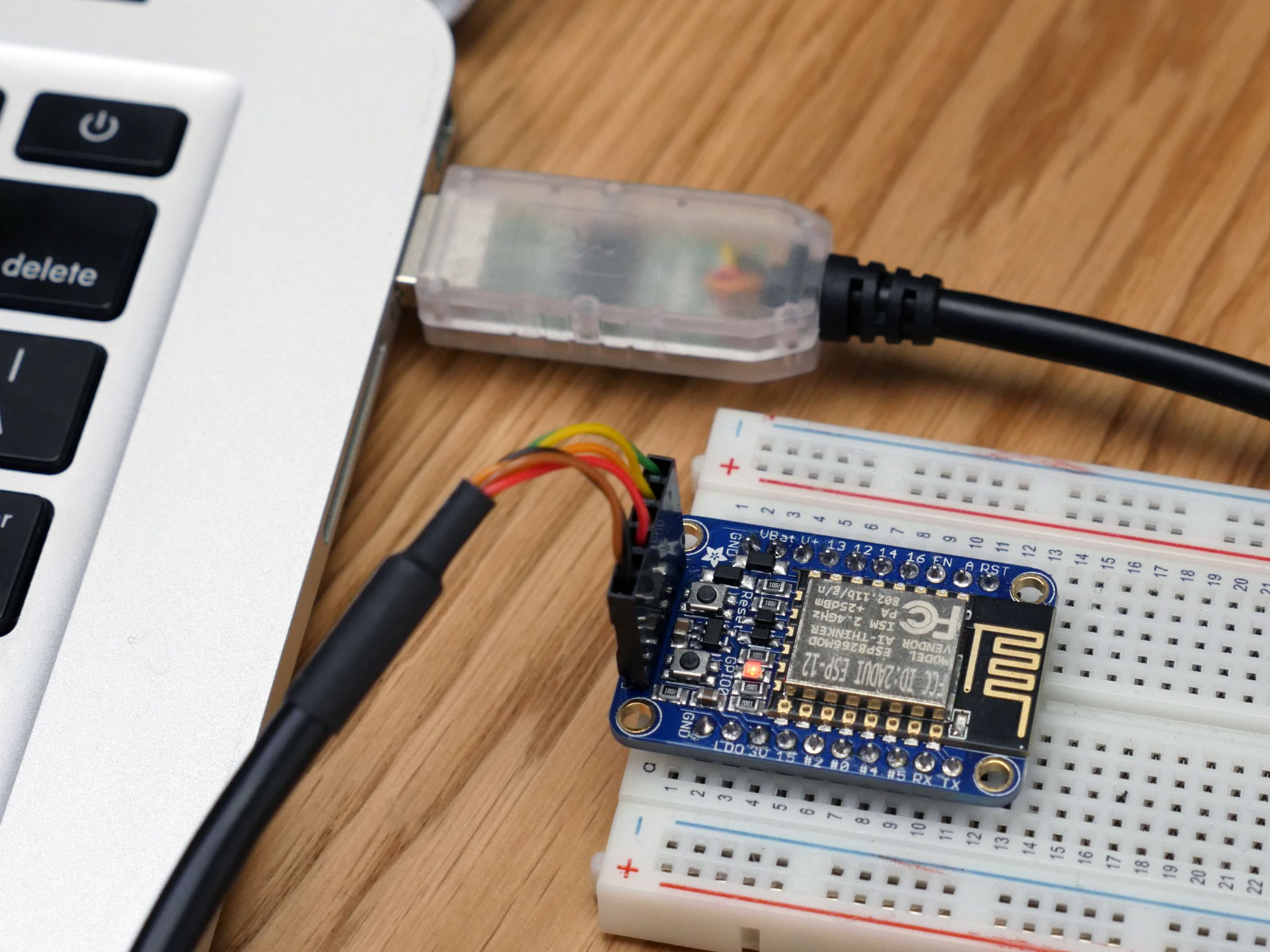

In this class, we'll be using an Arduino-compatible wifi board called the Feather Huzzah ESP8266, made by Adafruit. It's easy to program over USB without any additional hardware, you can get it pre-assembled so no soldering is required (at least not right away), and its compact size and onboard battery charger make it perfect for building the brains of any smart object. It also works with a wide variety of plug-and-play accessories, called Feather Wings, that make it easy to add on features with minimal circuit troubleshooting.
The lessons here will build on the programming and electronics prototyping skills first introduced in our beginner Arduino Class, so please review the lessons there and pick up any skills that are unfamiliar, even if you've used Arduino before. Most of the supplies for this class overlap, so if you've already completed the Arduino Class, you only need to pick up the following additional parts:
- Adafruit Feather Huzzah ESP8266 board in the configuration of your choice:
- PIR motion sensor
- USB power supply (optional)
- Lipoly battery (optional)
from L to R: NodeMCU ESP8266-12E devkit board, Adafruit Feather Huzzah, generic ESP8266 module only, Adafruit Huzzah Breakout
Alternatively, you can substitute the ESP8266 module of your choice to follow along with this class. As my second choice, I recommend the NodeMCU devkit ESP8266-12E (files on github), which is also programmable over USB.
The Sparkfun Thing and Adafruit Huzzah (non-Feather variety) are also nice alternatives, though they both require an additional programming cable. I do not recommend any of the tiny module-only boards for beginners, as they are more difficult to set up and use than the others (not breadboard friendly, require exactly 3.3v which makes programming tricky, even with a special cable, and many features are not easily accessible to the user). Pin configurations vary between boards, so if you're making a substitution, double check your product documentation when building your circuits with the diagrams in this class.

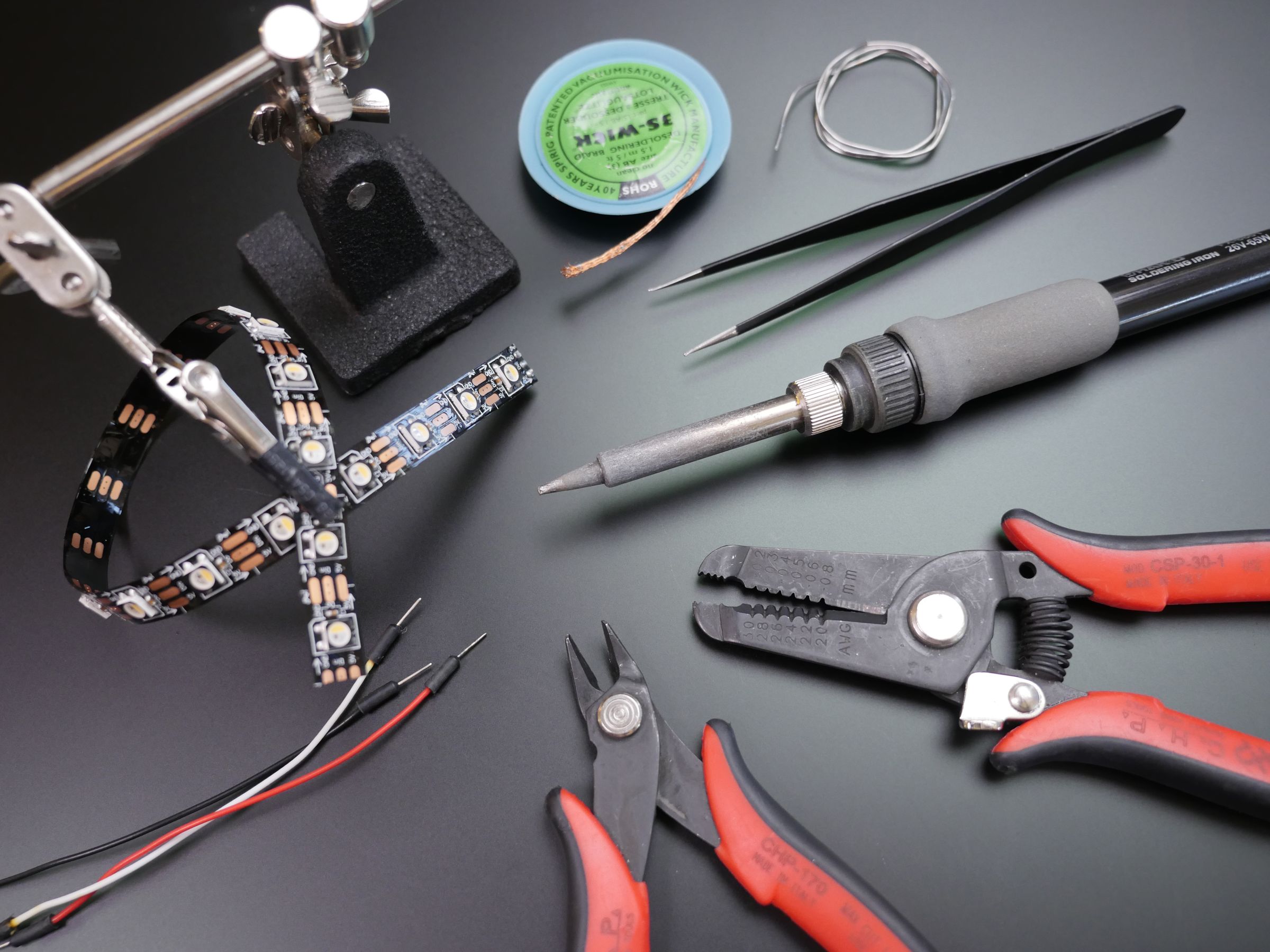

To solder your pixels, headers, and build more permanent circuits, review this intro lesson and gather up the following tools:
- Soldering iron and solder
- Small needlenose pliers
- Flush diagonal cutters
- Wire strippers
- Multimeter (optional but very handy)
- Tweezers
- Third hand tool
- Desoldering braid or solder sucker (for mistakes)
- Tape

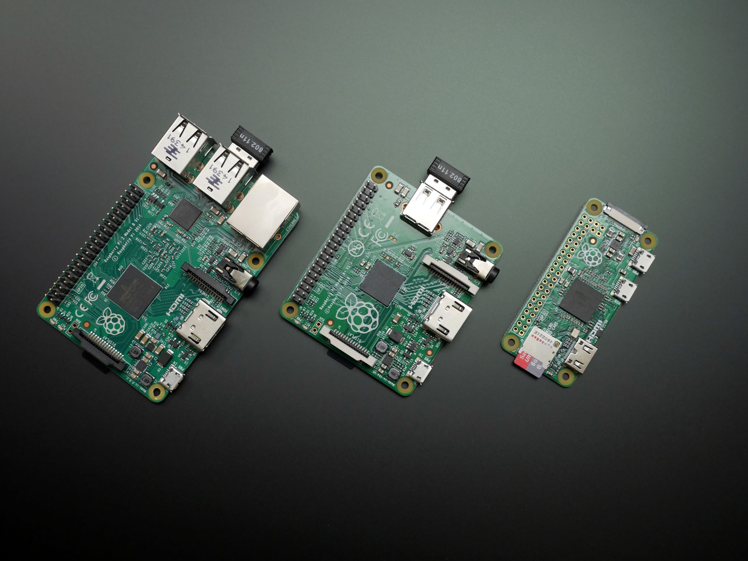

Raspberry Pi — Why doesn't this class use Raspberry Pi? I knew you were going to ask that! It's mostly because we have a dedicated class about Raspberry Pi already, and it teaches you to create a Tumblr-posting photo booth, which seems pretty IoT to me. Go check it out and let me know how it goes.
The devices we'll build in this class require far less processing power than you'll find in even the simplest Pi, and also require far fewer accessories to get up and running. I like to think of Raspberry Pi as capable of anything a cell phone can do: play video on a display, connect to the internet, etc. The ESP8266 is more like the circuit running your coffee maker than it is like a cell phone.
