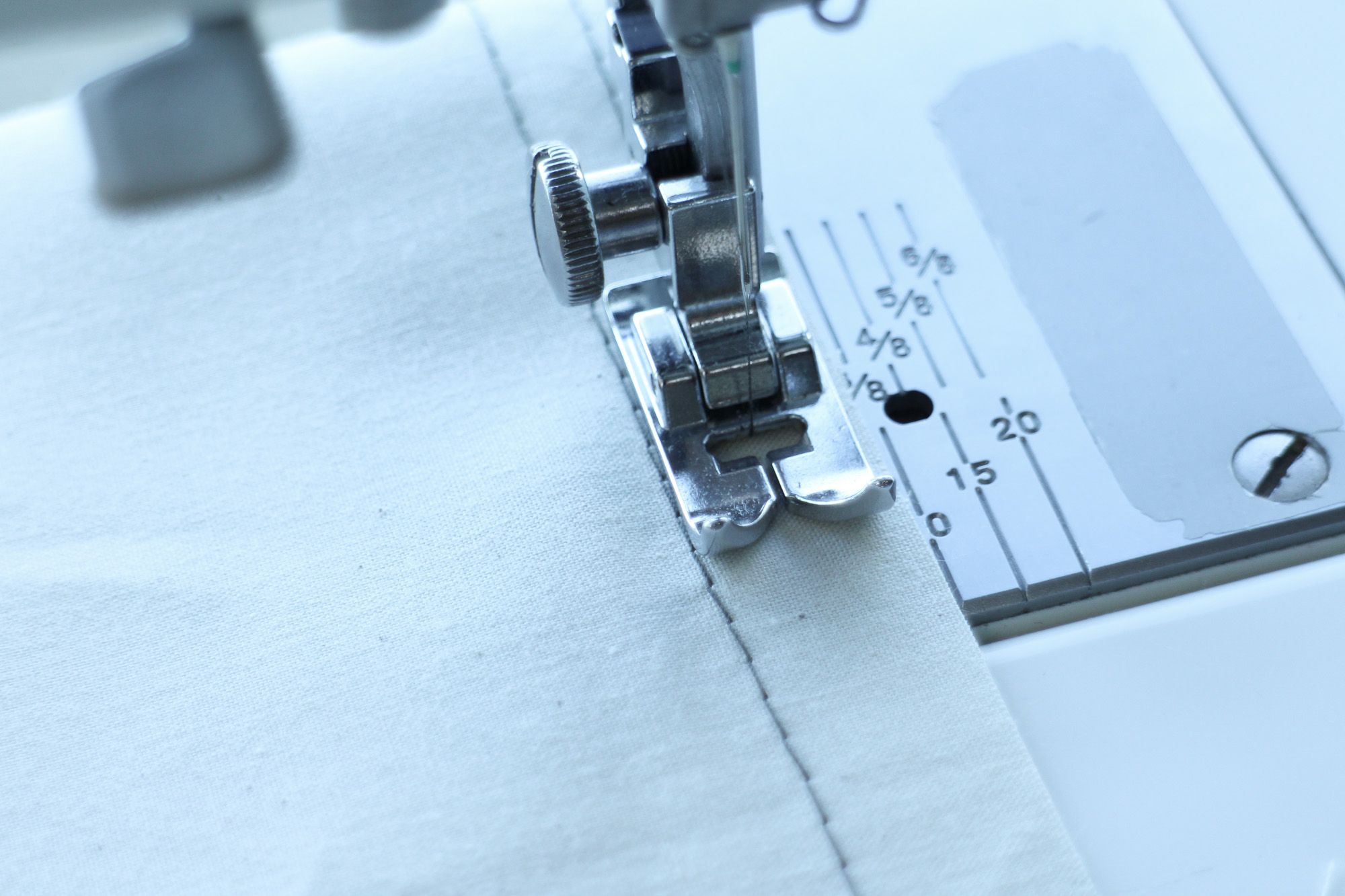

Now turn your stitch length dial to a large setting, at least 4. Sew a line of stitches about 5/8" in from one long edge of the ruffle fabric, without locking your stitches on either end! Cut your threads, leaving at least 4". Then sew another line right between the first line and the edge of the fabric, 1/4" away, also without locking your stitches.

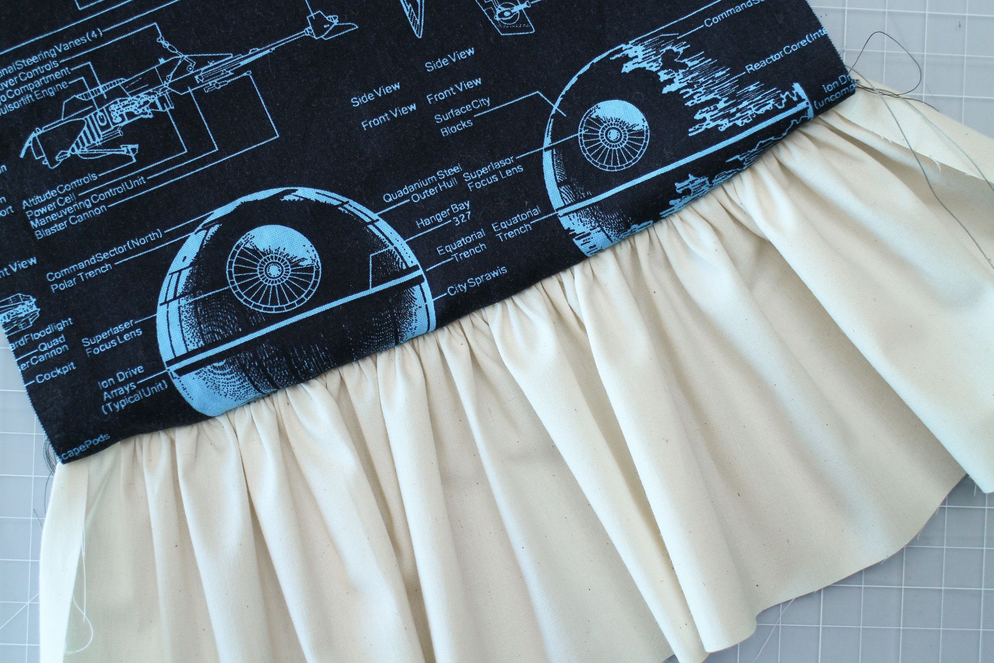

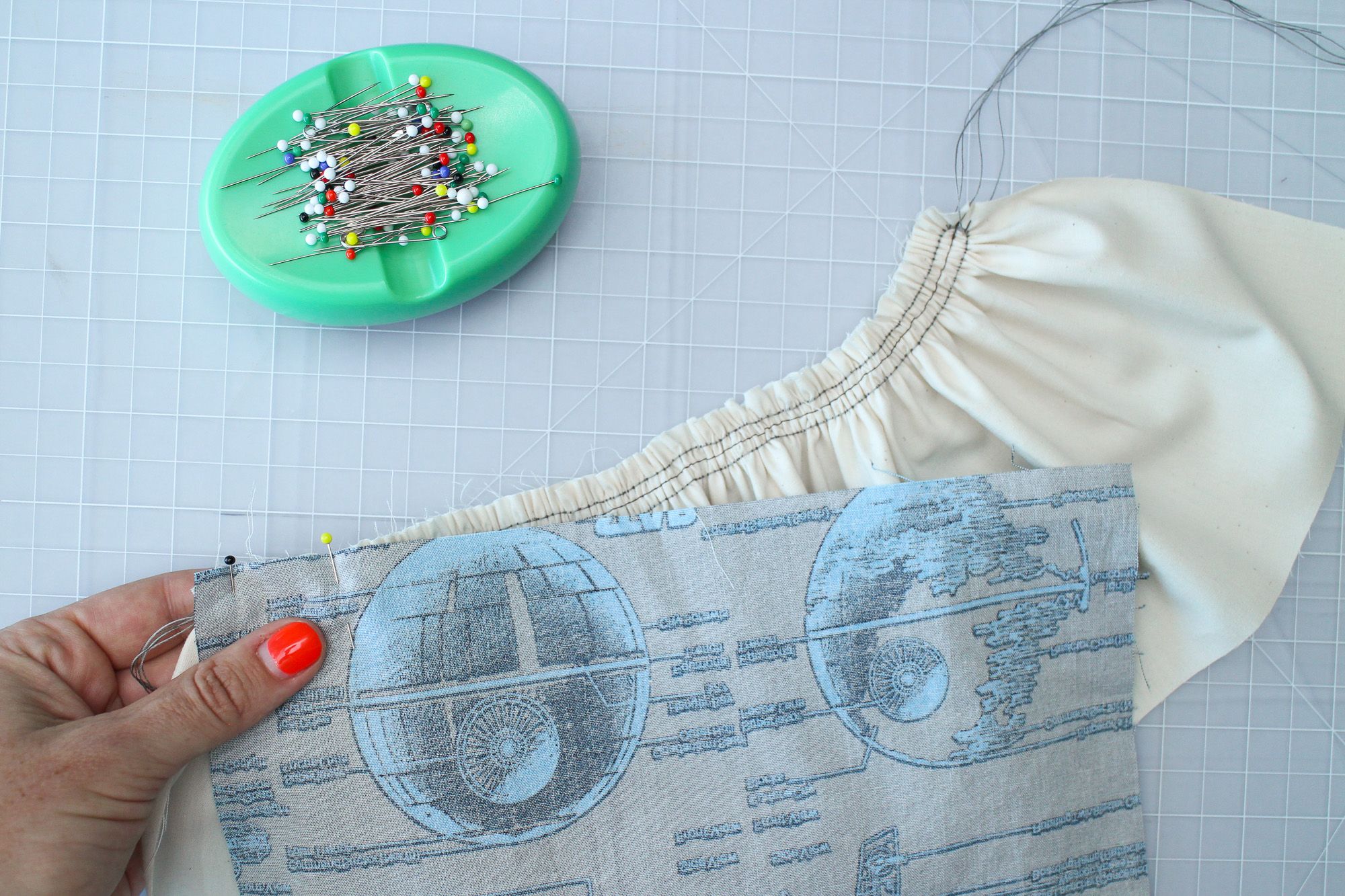

Pin the Star Wars fabric to the gathering, right sides to right sides, matching up the edges. Then sew the two pieces together 3/4" in from the edge, just beyond the gathering stitches.

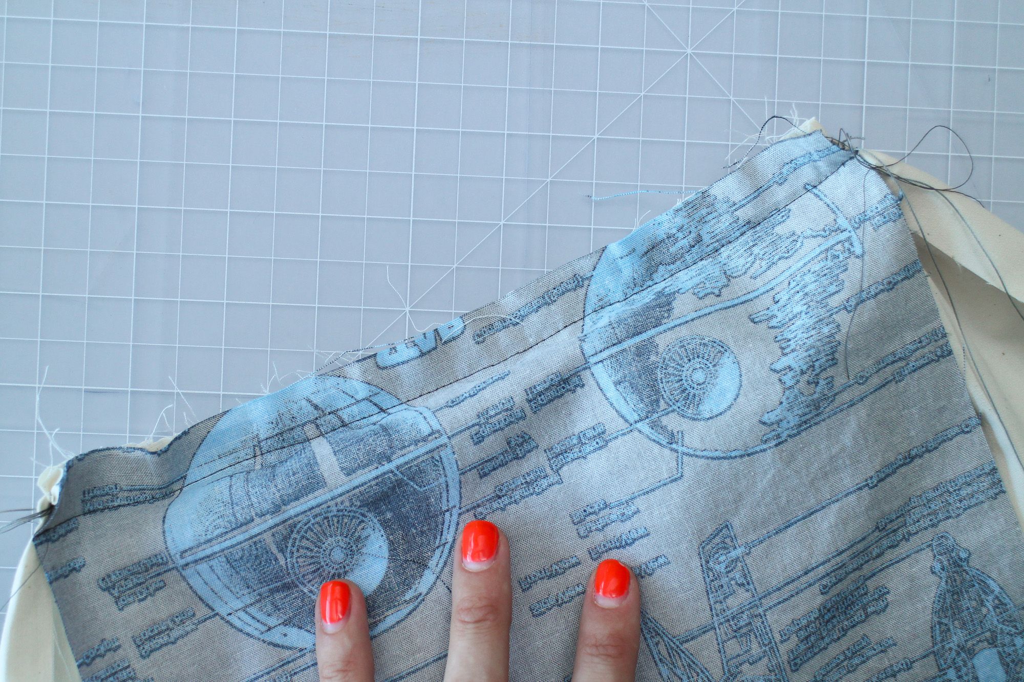

When you flip the Star Wars fabric back, it should look like this:

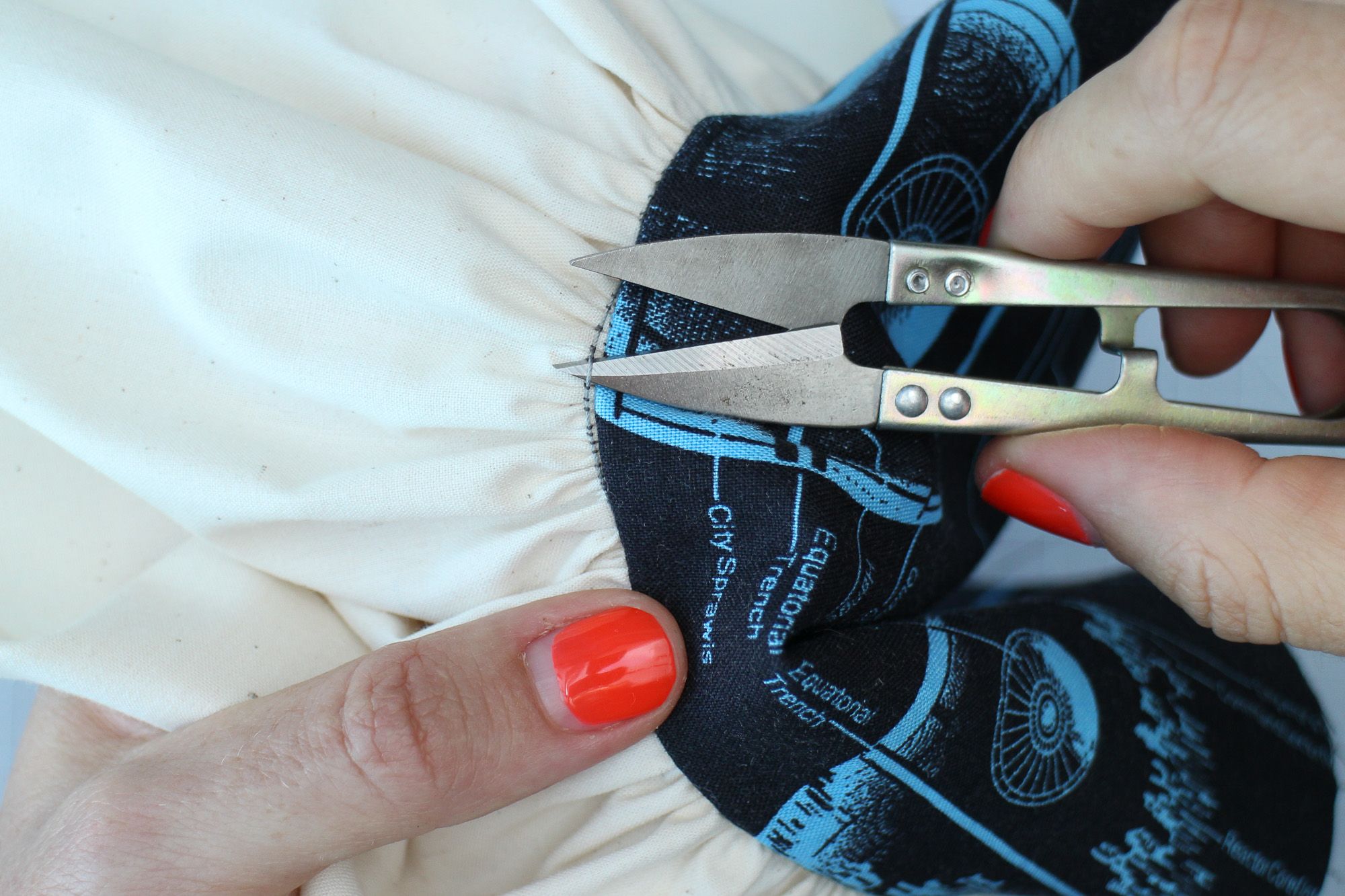

If your gathering stitches show past the seam anywhere, you can just snip them and pull them out.
If you want you can now topstitch the Star Wars fabric down over the ruffle.

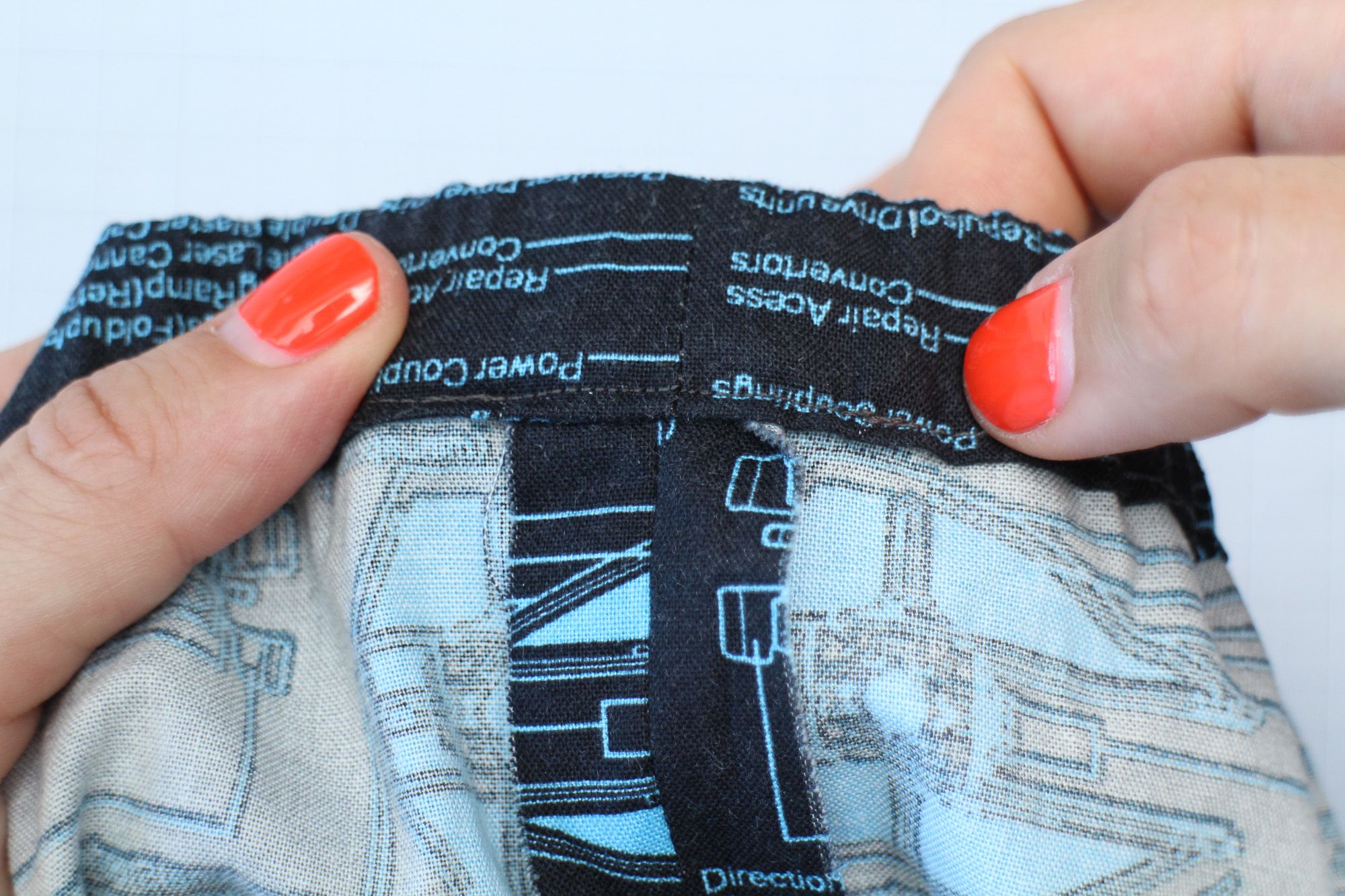

Step 3: Creating Channels for Elastic or Cord
One way to attach elastic is to create a channel for it to run through. This method is used a lot on clothes at the top of waistbands or around ankles or cuffs, and it is really a very simple technique.

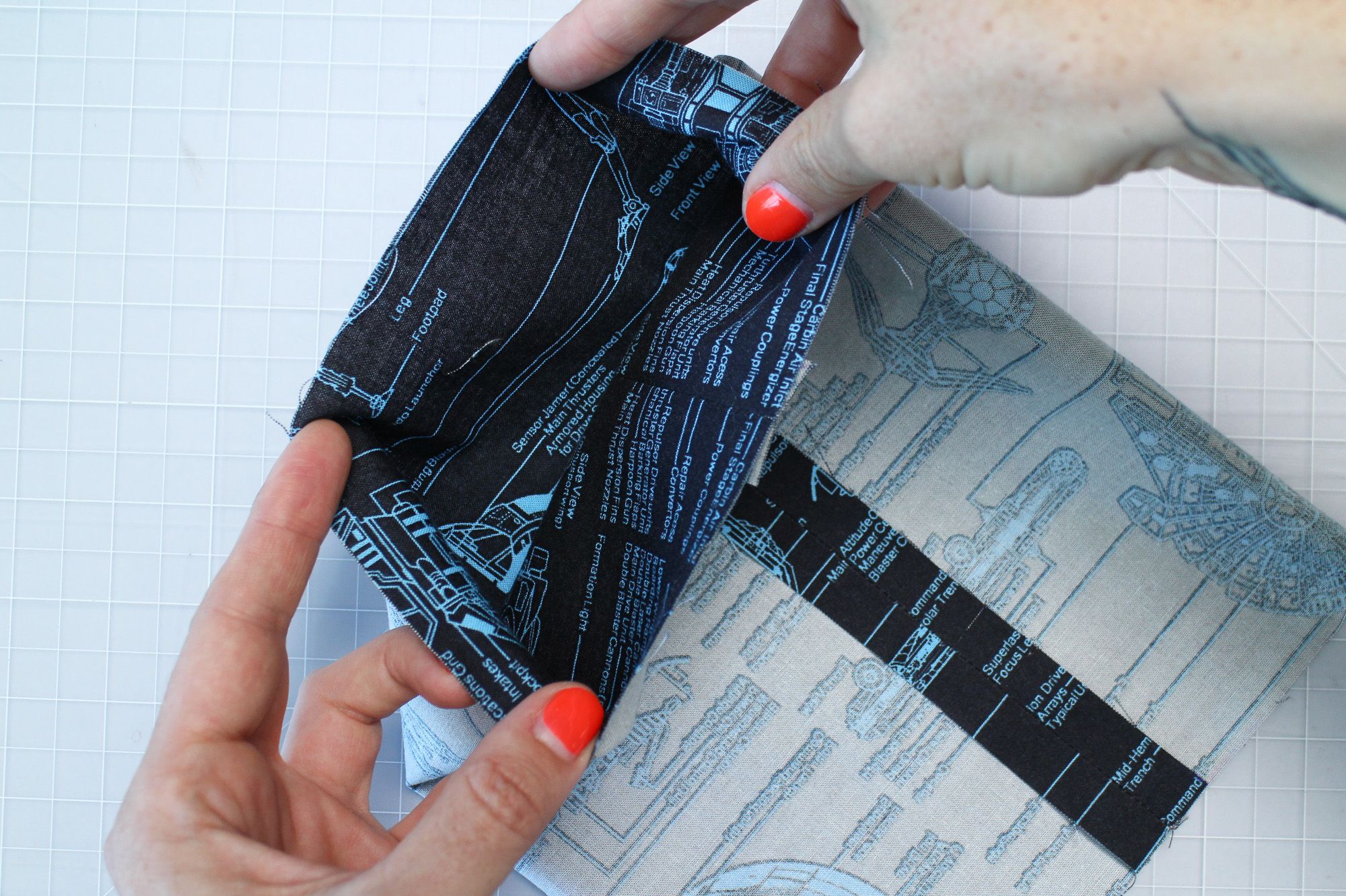

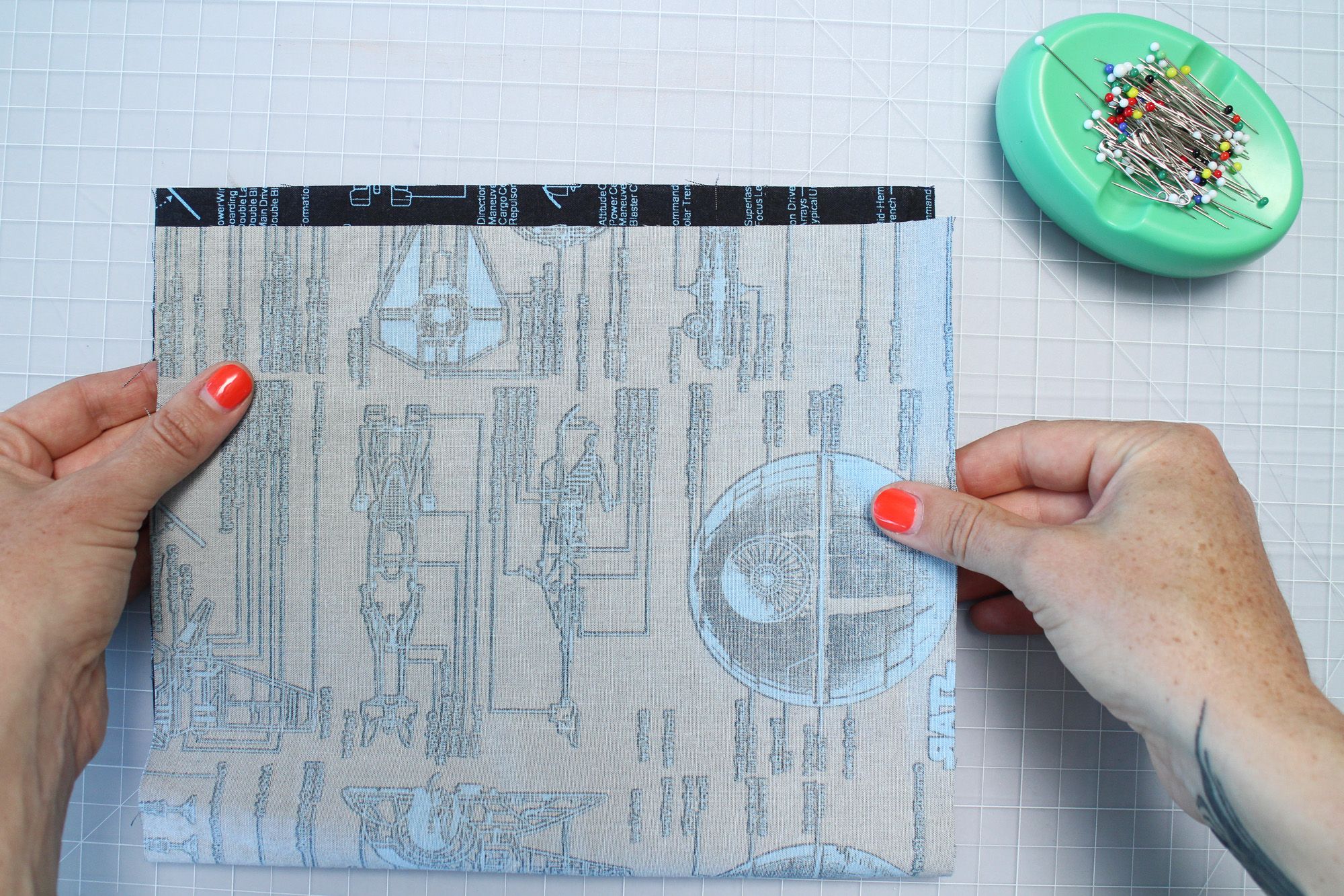

To show you how to do this, I'm going to sew a loop of fabric. Imagine this is a pant leg, or the top of a skirt.
Measure the width of your elastic so you know how wide to make the channel. My elastic is 7/8" so the channel should be 1".

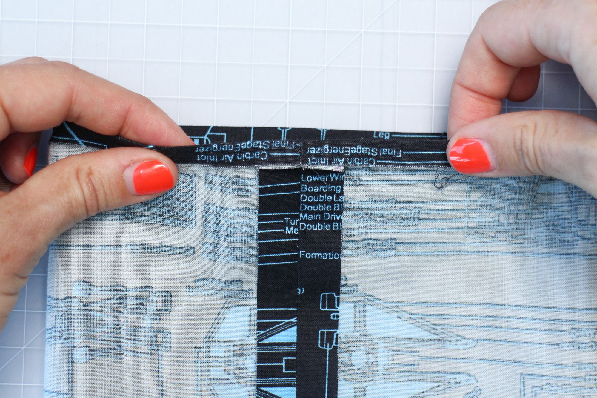

Now fold and press the fabric down 1/4" on one end, then fold and press it another 1" to form the channel.
Sew the fold down all around the loop about 1/8" from the bottom of the fold, leaving about 1" open at the seam.
Now measure the distance around your loop of fabric, in this case it's 16". In order to gather your band, you need to make the elastic shorter than the fabric. As with the ruffle, how much shorter you make it is somewhat a matter of aesthetics, but it also depends on what the elastic is going to go around. For example, if you were making a waistband, the elastic should be about 1-2" shorter than your waist measurement. In this case I'm making the elastic 13" long.

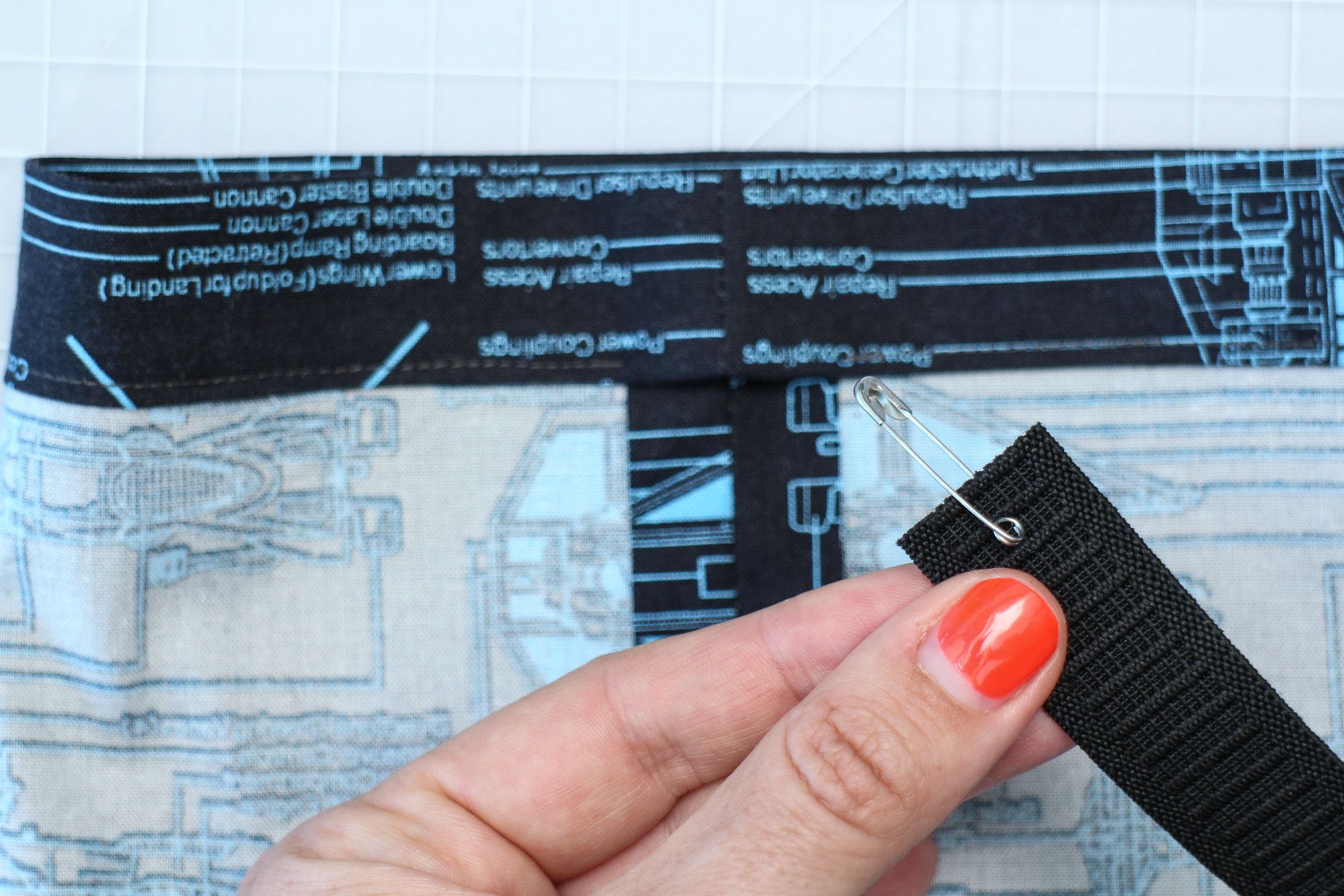

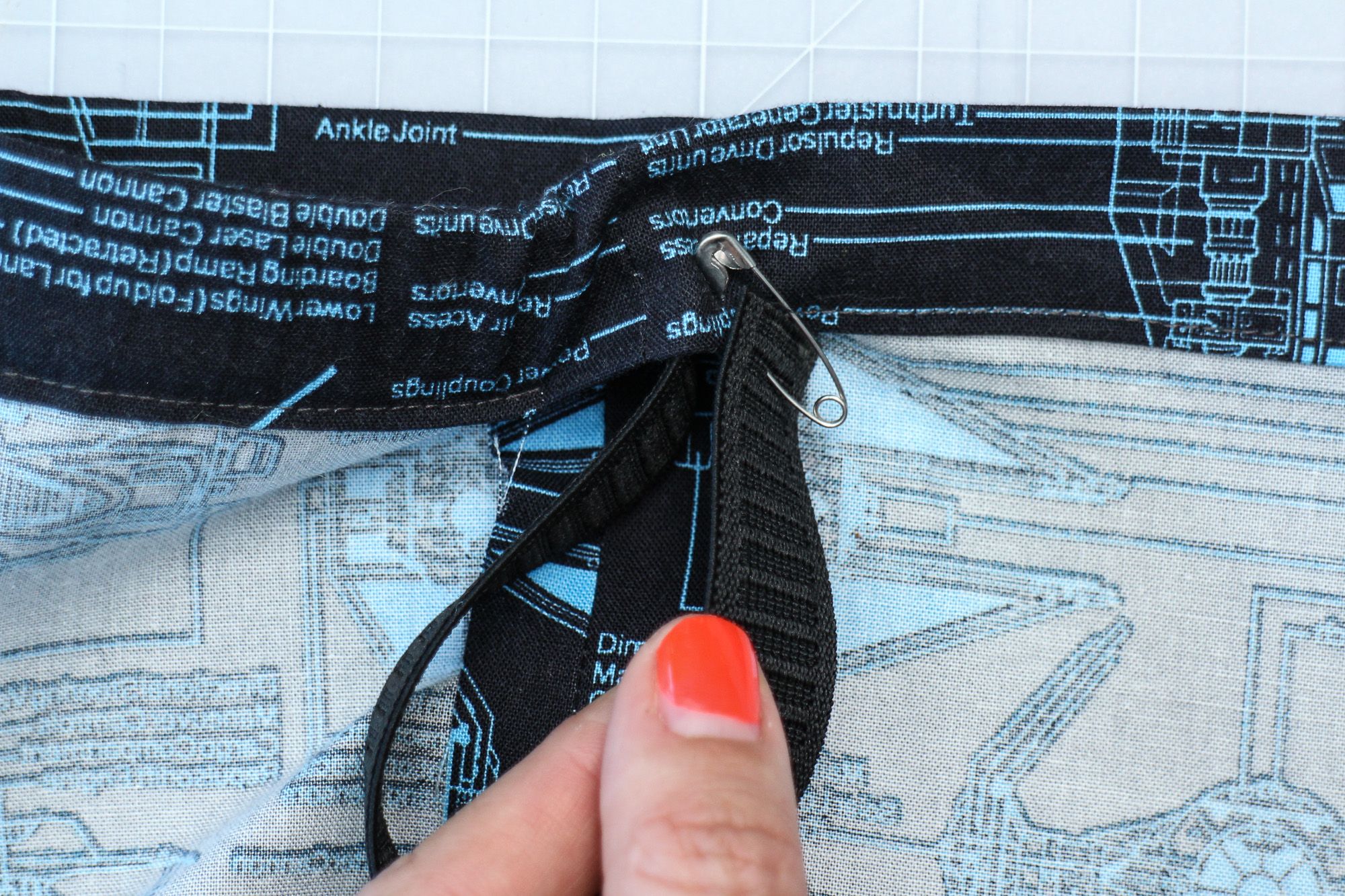

To thread the elastic through the channel, pin a safety pin to one end, then stick it into the channel through the gap.
The safety pin will help you thread the elastic through the channel because you can feel it through the fabric. Keep pushing it forward, bunching up the fabric, then pushing the fabric over the elastic as you move the safety pin ahead.

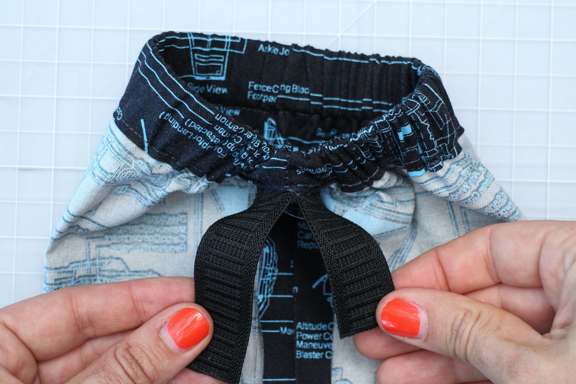

Before you get to far, pin the other end of the elastic to the fabric right at the opening so it doesn't get pulled into the channel. When you have threaded the elastic all the way out the other side, unpin the back end, and pull both ends out a few inches.
Overlap the two ends and pin them together.
Sew two rows of zigzag stitches over the ends of the elastic to connect them.
Pull the fabric around so the elastic slips back into the channel, and the sew the opening closed on the machine.
Now you have a stretchy waistband!... for a very tiny person :)
