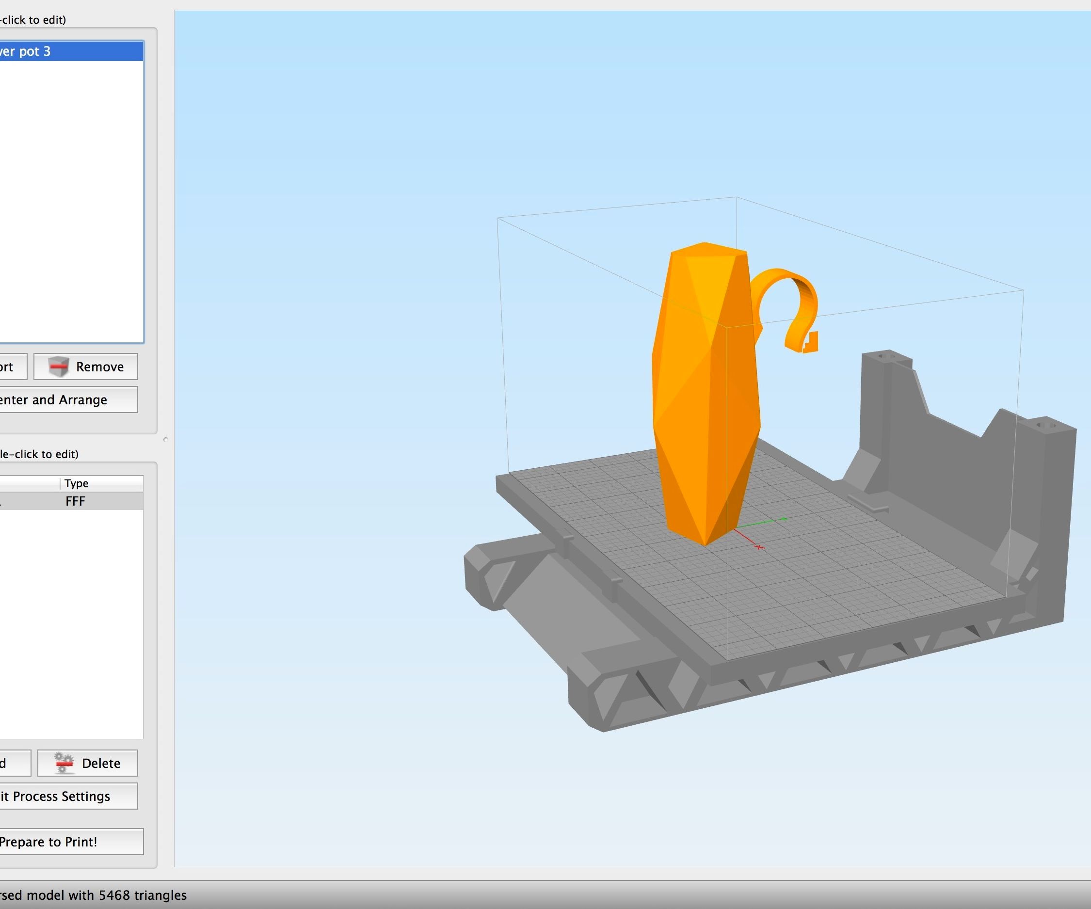

Step 1: Download ReplicatorG and Select Machine
Download the free slicer, ReplicatorG, and install the software.
Select the correct machine to output the file to, in this case a Replicator 2.
Dont worry about the Sailfish, this is a software upgrade, which I highly recommend for any Makerbot, and might be covered in a different Instructable. ; )
Step 2: Upload and Save As...
With the right machine selected, upload the file to change. In this case a gcode file has been uploaded and will be changed to an x3g.
Click "Build to file for use with SD card" and a save as window should appear. In the bottom of this window the file name should have the option for x3g. Save to a safe place and send it to an SD card!
