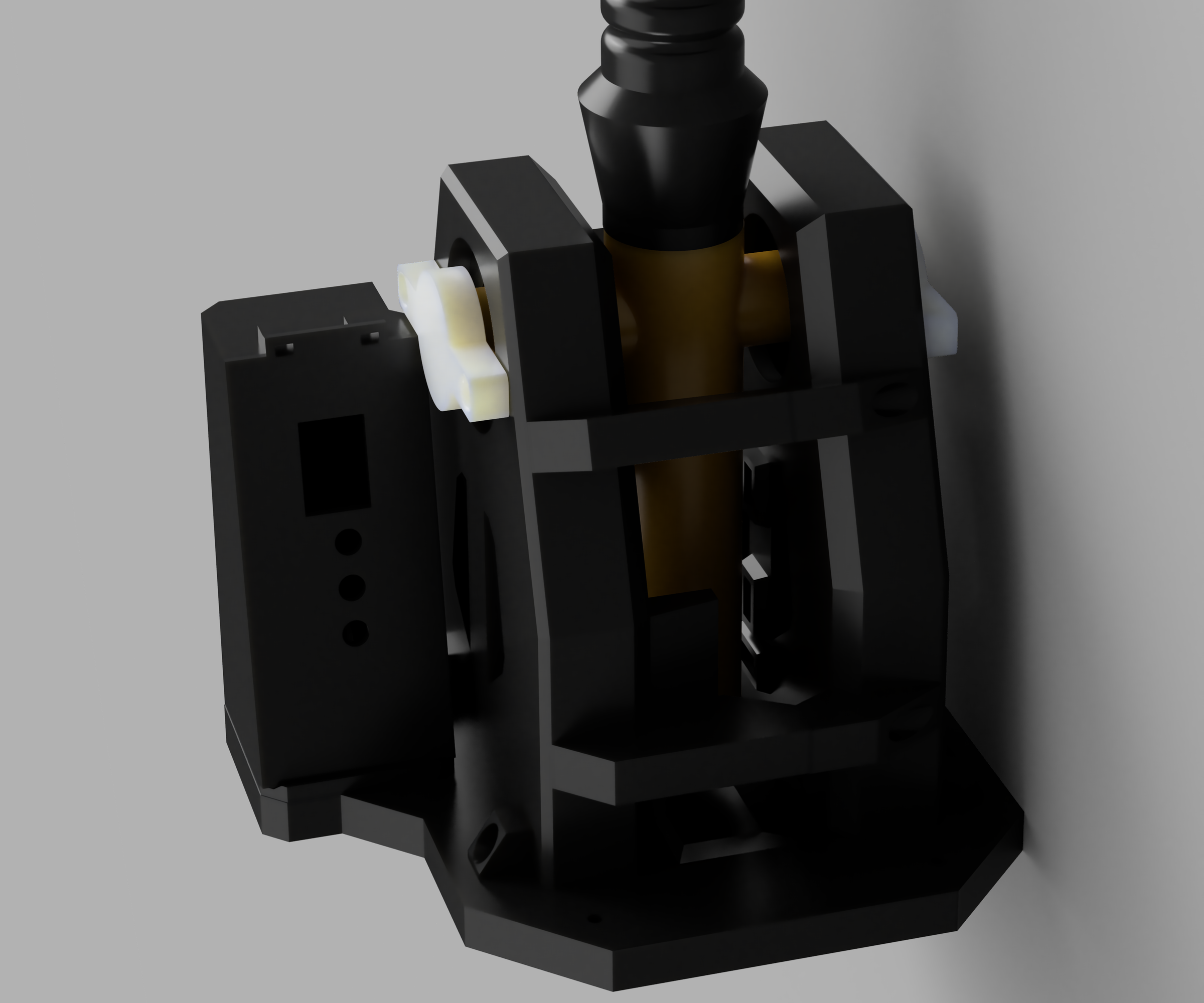

Step 4: Step 4 : Future Work
The future work will be focused on the mechanical side of things instead of electronics, I need to make a rack that connects to the lever in order to secure the magnet and the circuit for the sensors and it´s enclosure.
The only enclosure I´ve already done is for the 7 segment display, you can see the drawing from Fusion 360 in the pdf file and the images show both plates of the enclosure, also in Fusion360.
Any doubt or advice you have please feel free to contact me.
