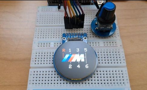

Introduction: Gear Shift Indicator Using Visuino
About: Arduino fan!
In this tutorial we will make a Gear Shift Indicator using GC9A01 SPI Display, Arduino and Visuino program.

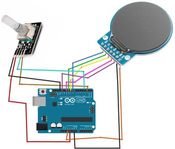

Step 2: The Circuit
  • Connect GC9A01 Display pin [VCC] to Arduino pin [3.3V]
  • Connect GC9A01 Display pin [GND] to Arduino pin [GND]
  • Connect GC9A01 Display pin [SCL] to Arduino pin [13]
  • Connect GC9A01 Display pin [SDA] to Arduino pin [11]
  • Connect GC9A01 Display pin [DC] to Arduino pin [9]
  • Connect GC9A01 Display pin [CS] to Arduino pin [10]
  • Connect GC9A01 Display pin [RST ] to Arduino pin [8]
  • Connect DHT11 Sensor pin [VCC] to Arduino pin [5V]
  • Connect DHT11 Sensor pin [GND] to Arduino pin [GND]
  • Connect DHT11 Sensor pin [S] to Arduino digital pin [2]
Connecting Encoder module:
  • Connect Encoder module pin [CLK] to Arduino digital pin [2]
  • Connect Encoder module pin [DT] to Arduino digital pin [3]
  • Connect Encoder module pin [SW] to Arduino digital pin [4]

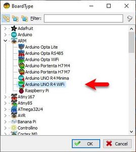

Step 3: Start Visuino, and Select the Arduino UNO R4 WiFi Board Type
Start Visuino as shown in the first picture Click on the "Tools" button on the Arduino component (Picture 1) in Visuino When the dialog appears, select "Arduino UNO R4 WiFi" as shown on Picture 2

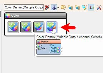

Step 4: In Visuino Add Components
  • Add "Clock Generator" component
  • Add "Clock Multi Source" component
  • Add "Counter" component
  • Add "Integer Multi Source" component
  • Add 2X "Color Value" component
  • Add "Color Multi Source" component

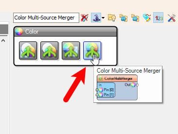

  • Add 7X "Color Multi-Source Merger" component

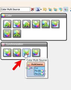

  • Add 7X "Color Multi Source" component
  • Add "Color Demux(Multiple Output channel Switch)" component

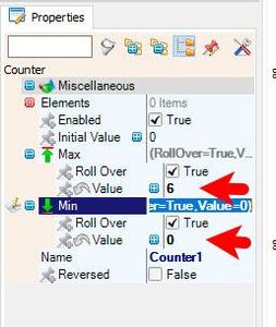

  • Select "Counter1" and in the Properties window set "Max" > "Value" to 6 and "Min" > "Value" to 0

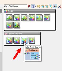

  • Select "MultiSource1" and in the properties window set "Output Pins" to 7
  • Select all the rest Color Multi Sources and for each set "Output Pins" to 4

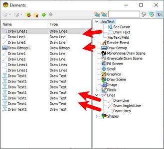

Double click on the "Display1" and in the Elements window Drag to the left side:

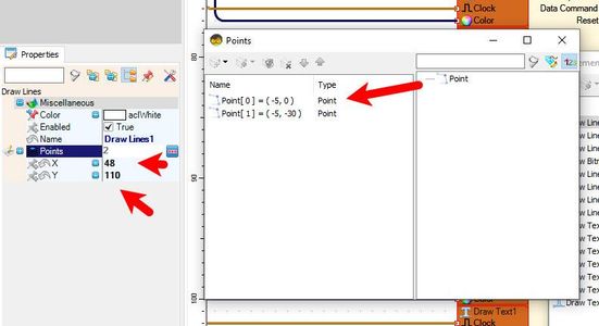

  • 3X "Draw Lines"
  • "Draw Bitmap"
  • 4X "Draw Line"
  • 7X "Draw Text"
  • Select "Draw Lines1" and in the properties window select "Color" and click on the pin icon and select "Alpha Color SinkPin", set "X" to 84 and "Y" to 110, Select "Points" and click on the 3 dots butoon and in the "Points" window drag "Point" to the left side and in the properties window set "X" to -5, drag another "Point" to the left side and in the properties window set "X" to -5 and "Y" to -30, Close the "Points" window
  • Select "Draw Lines2" and in the properties window select "Color" and click on the pin icon and select "Alpha Color SinkPin", set "X" to 175 and "Y" to 110, Select "Points" and click on the 3 dots butoon and in the "Points" window drag "Point" to the left side and in the properties window set "X" to 10, drag another "Point" to the left side and in the properties window set "X" to 10 and "Y" to -30, Close the "Points" window
  • Select "Draw Lines3" and in the properties window select "Color" and click on the pin icon and select "Alpha Color SinkPin", set "X" to 175 and "Y" to 110, Select "Points" and click on the 3 dots butoon and in the "Points" window drag "Point" to the left side and in the properties window set "X" to 10, drag another "Point" to the left side and in the properties window set "X" to 10 and "Y" to 40, Close the "Points" window

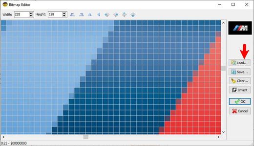

  • Select "Draw Bitmap1" and in the properties window set "X" to -10 and "Y" to 50 and select "Bitmap" and click on the 3 dots button and in the "Bitmap Editor" load the image
You can find more car logos on pngwing.com

Step 9: Play
If you power the Arduino module, The Display will show the Gear shift and if you use Rotary Encoder, you can change the gear on the Display.

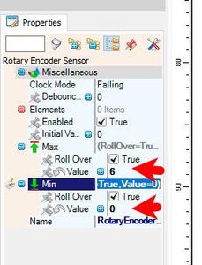

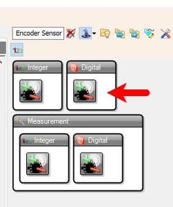

Step 10: Using Rotary Encoder
  • Instead of "Clock Generator" component and "Counter" component just add "Rotary Encoder Sensor" component
  • Select "RotaryEncoderSensor1" and in the properties window set "Max">"Value" to 6 and "Min">"Value" to 0
  • Connect Arduino digital pin [3] to "RotaryEncoderSensor1" pin [Direction]
  • Connect Arduino digital pin [2] to "RotaryEncoderSensor1" pin [Clock]
  • Connect "RotaryEncoderSensor1" pin [Out] to "MultiSource3" pin [In]
