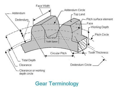

Gear Terminology: https://www.theengineerspost.com/gear-terminology/
Wiki Involute Gear: https://en.wikipedia.org/wiki/Involute_gear
All of the gears have a pressure angle of 20-degree and a except the Taper Gears have a 2.5mm tooth pitch.

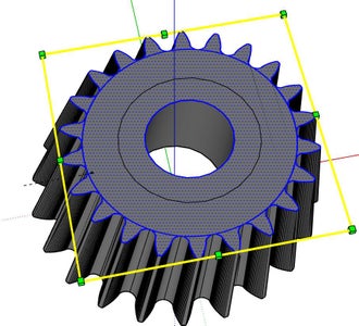

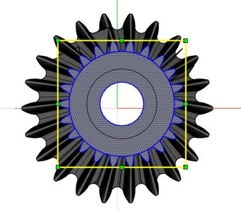

The 45-degree taper/right-angle gear design is the most difficult. These gears are the only 2 gears with a 3mm Pitch.
  • Initial Taper gear parameters: 22 teeth; OD 26.8mm; pitch Diameter 23.8mm; height 6mm; center hole 6mm.
  • Ungroup/explode the involute gear so there are no grouped parts.
  • Select the top portions of the gear and scale these inward 6mm to create a 45-degree angle (see images).
  • Combine one angle gear with the winding gear, and use a second for the crank.

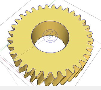

The second most difficult gear design is the Worm Drive gear. Like the taper gear, the involute teeth must be angled to mate with the worm gear. The "threads" on the worm are 10 degrees so the top of the worm drive gear needs to be rotated 10 degrees counter-clockwise from the bottom. As with the taper gear, select the top plane of the worm drive gear and use the "rotate" tool of the CAD program to rotate the top 10 degrees ccw to the bottom.

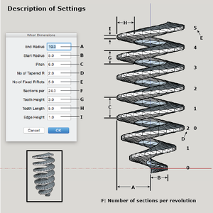

Printing the worm gear, governor springs, weights, and shaft does not provide the necessary strength but I did create the worm gear and a plastic shaft for this model without the governor pieces. I used a Ruby Script plugin (whorl) designed for "threads". Parameters below for the Whorl variables for a 7 rotation worm gear.
  • Worm Drive gear parameters: 24 teeth; OD 26mm; pitch Diameter 23.6mm; height 8.5mm; center hole 11.5mm.
  • Worm Gear using Whorl thread plugin: End & StartRadius 2.5mm; Pitch 2.8; Tapered ROTS 0; Fixed ROTS 7; Sectors per 24; Tooth Height 2mm; Tooth Length 0.62mm; Edge Height 0.7mm.
