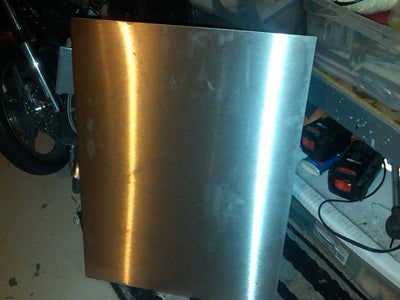

1/8" thick stainless steel (mine measured 12 x 24). Cost: about $10 at a scrap yard

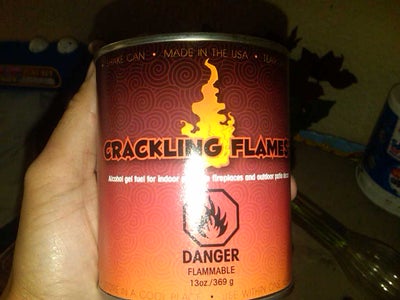

Can of fireplace gel. $3.00 at www.northlineexpress.com

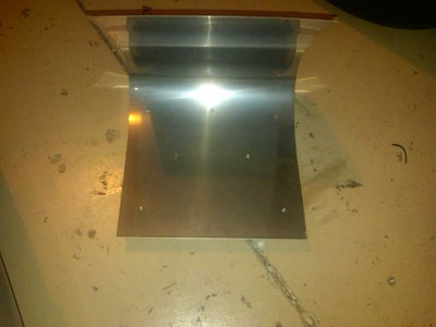

Step 2: Bend Steel

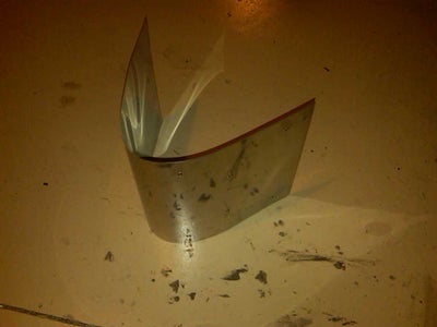

Ok with this step, you will need your hands. Take the 1/8" thick stainless steel and bend it to a C shape. Be careful not to do it too quick or you may end up creasing it. You want a nice curve C in the end. Work it until you get the shape you want.

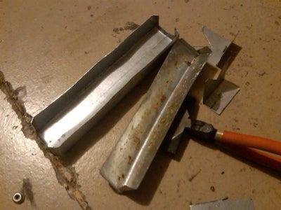

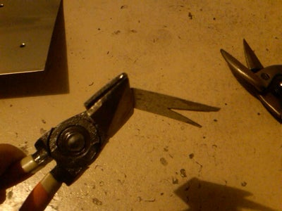

You will need something to hold the gel. I created a triangular "trough" to hold mine. You can make any style you like, just make sure that the ends are not flat so that the gel won't overflow. Mine was easy. I just measured out 3 x 6 in sheet metal and bent it down the middle. I then took the ends and put a slit down the middle and bent each side to close it off.

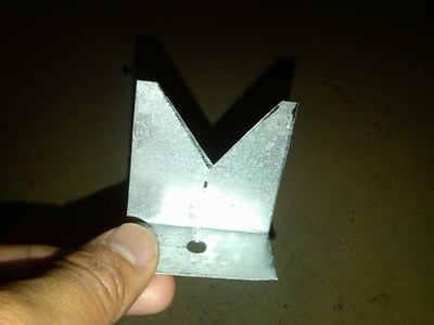

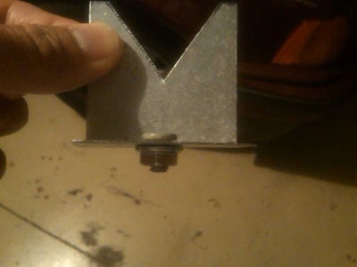

Step 4: Cut Trough Holder

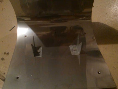

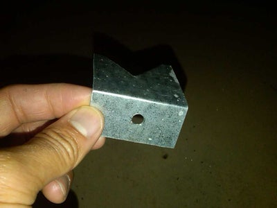

Measure and mark out 2 rectangular pieces on the sheet metal. Mine was 2 x 4 inches. Before you cut the 2 rectangular pieces that will hold the trough, drill 2 holes that will be used to attach it to the stainless steel. After making the holes, cut the pieces. On the opposite side where you put the hole, use the shears to cut a "cradle" to hold the trough. It can be any shape, I used triangle because the shape of my trough is triangle. Bend the end with the hole 90 degrees. Repeat with the other piece making sure that it's the same height when finished.

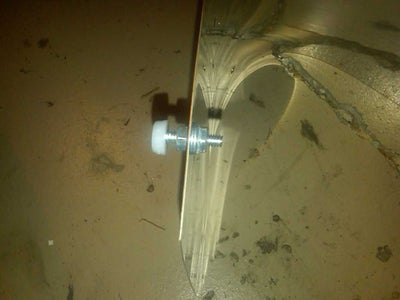

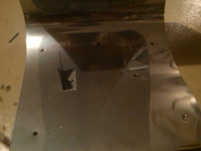

Step 5: Make Holes and Attach Trough Holder

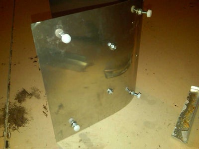

On the stainless steel, drill 6 holes using a drill bit that can penetrate steel. I used a titanium coated drill bit from Home depot. 4 holes will be for the legs, 2 holes will be for the cradle for the trough. Position the 4 holes along the edges of one end of the c-shaped stainless steel (this will serve as the "base" part of the fireplace). Position the 2 holes along the middle of the base and center it. Make sure the positioning of the cradle is under the "awning" of the c-shaped stainless steel. The reason for this is so that the fire is contained from going too high and possibly out of control.
Step 6: Putting It Together
Put the trough holder on the stainless steel using nuts and bolts. Put longer nuts and bolts on the 4 corners of the base. So that the bolt holds up the stainless steel, use 2 nuts to sandwich the stainless steel and provide space between the floor and the steel. You can go without putting the 4 corner bolts, but putting legs on it not only gives it a cleaner look, but also balances it from tipping over on its back.

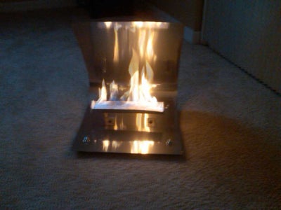

Step 7: Fill the Trough
Now open the gel and pour some of it on the trough. Be careful not to have it overflow or you're really will have an out of control fire. I only put it about a 1/4 filled the first time to see how long it lasted, then I adjusted to get more time out of it.

Step 8: Light, Sit Back, and Enjoy
Place the trough on the base and make sure it is secured on the base.
Take a long length lighter and light it
Enjoy the warmth.
***Depending on the size and how much you put in the trough will determine the length of time the fire will stay lit. If you want to make it last even longer and contain the fire more, put a cover on the trough with a small opening.***
