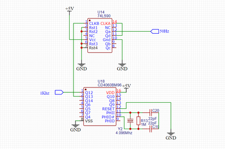

This project deploys 2 ICs to first, use the natural frequency of the crystal to convert it into square wave and then using the binary counter/divider to reduce the frequency to the desired one and then second, further divide it by the decade counter to get out target 50Hz square wave frequency.
The first IC is the 4060 which is a binary divider which can work with external timing components ( R C timing components) which determines the operating frequency of the circuit. Alternatively as this IC has a build in Schmitt trigger so it can also handle the input coming directly from a crystal. The two 22pf capacitors are used to maintain the crystal oscillation. As you can see from the image that each pin of the 4060 has a certain dividing factor by which it will divide the original crystal frequency. At pin 1 of the IC we have a dividing factor of 4096 and using a 4.096Mhz crystal can give us an exact frequency of 1Khz at this particular pin. Similarly we have a dividing factor of 8192 at pin 2 which means we can get a 500Hz signal from pin 2 as well which will be utilized to get out 50Hz eventually.

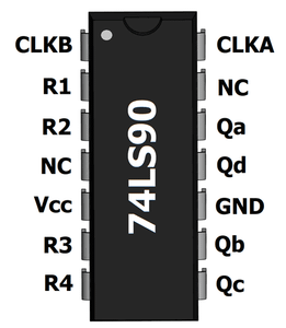

The second IC is the 7490 binary and decade counter. This is a unique IC which deploys divide by 5 and divide by 2 feature and we can even combine both this sections to get a divide by 10 configuration. This is exactly what we have done here. The 500 Hz from pin 2 of 4060 is first fed to the divide by 5 circuit and then to the divide by 3 to eventually get our stable 50Hz signal.
One point to note here is that we must first divide by 5 and then by 2, though the reverse is also possible and will give you 50Hz signal but the duty cycle will not be 50 percent. If you are not concerned about duty cycle, then any configuration of the 7490 IC would be fine for you.

Step 3: The Circuit Diagram
This is the complete schematic of the project. Be sure to check the maximum permissible operating voltage of each IC from the datasheet. In my case both are 5V tolerant so I used a 7805 voltage regulator to power the system from a 9V battery
