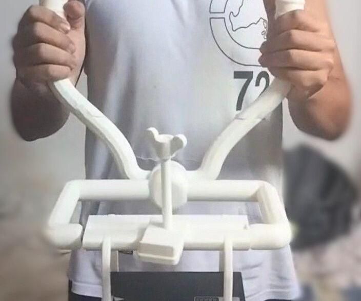

Unfortunately, I will not be able to build this design as i tried to build a similar design and it did not work (as shown above)... I blew up my pocket money as I got the alternate design 3d printed (I don't have a 3d printer and getting 3d printed in a shop is a little expensive where i live.) I shall try to build it later to show how it would look like for if it is done and also how it should function. Since my Fusion app is free for now, i have tried my best to render it 3d and show how it is assembled.
The mistake i made was that there was too little space for the coils and the magnets, also the turbine's cone was not tall enough and the blades too large to be efficient.
