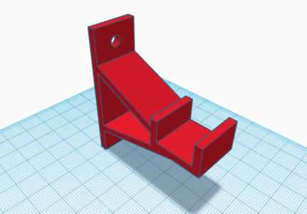

Step 1: Start With Tninkercad
Thinkercad is a very simple software for beginners to learn about 3d design and I can design what I think in my brain quickly just stack some blocks out. Next I can export the object from thinkercad and 3d printed. Althought Thinkercad can design the prototype fast, it cannot analyze any stress conditions. If my hook is designed wrong it may not bear the weight from backpack so I will export the file and get into Fusion 360 for my final design.
There are there file formats to choose in Thinkercad. I prefer to stl file because it is a common 3d file for 3d printed. But stl is file with many triangle face I need to conversion in Fusion 360.

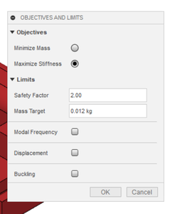

  • Objectives
There are two types of objectives you can choose to set. One is minimize mass which need to set safety factor. The other is maximize stiffness which need to set safety factor. You can try these two obtion. But I chose the maximize stiffness because I can control hook mess.
Picture No.4 is a dialog box about objectives.

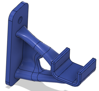

After finish generative design I do simulation about static stress. The picture above shows the result of the comparison.I let those two different designs stand 70N stress at the same time.The results are very obvious. Hooks originally designed using thinkercad have a safety factor of 2.68 and hook using generative design have a safety factor of 5.26 this display generative design makes the hook more strong.

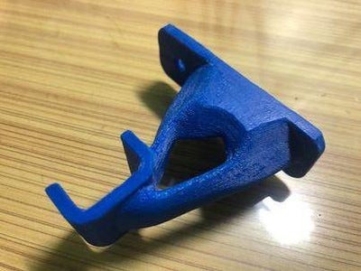

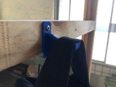

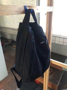

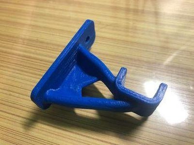

Finally I used 3D printer and abs filament to print out the hook and fix it to the wall. My backpack finally had a place to hang.
