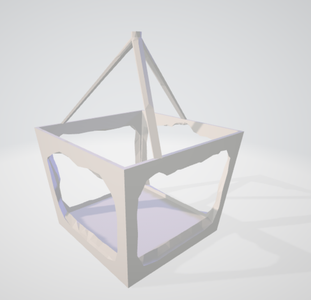

Step 5: [Basket Hanger] Creating the Model
For the basket hanger, since I wanted to try using the topological optimization program, I designed a simple basket with three poles connecting to a cylinder for the hang. I used the Loft tool to connect the different shaped sketches together.

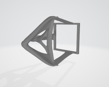

Step 6: [Basket Hanger] Trying Topological Optimization
At first, I tried static stress optimization on this model but got errors that the model was "overengineered." This was because I had accidently left other bodies in the study. I switched over to shape optimization as suggested from the Fusion 360 dialogue box.
Another problem I encountered was under defining preserve geometries to perform the optimization on. As you can see from the third picture, the "optimized model" would actually be floating in space.
I changed the geometries, but then had errors when trying to specify the target mass to be 30%. Because of the way the model was made, Fusion 360 kept notifying me that the minimum mass possible was 52%. I changed the parameter to accommodate but was a bit disappointed in the resulting model. It did not look that much different from the original. I believe I might over constrained it.
Step 7: [Basket Hanger] Trying Generative Design and Printing
I decided to go back and do generative design on the basket hanger to see difference in geometry.
I changed the base to be a ring instead of a square and changed some other constraints thus comparison might be inaccurate. However, from what I see, the generative design clearly produced a much smoother outline than the shape optimization did.
When printing, I chose to minimize the support material. The blue model clearly had a much harder time trying to print everything together but eventually was able to connect together.
