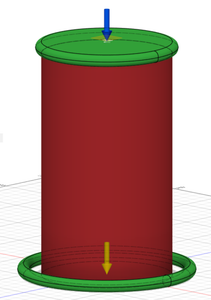

My initial design was very simple. I used a rounded circular seat base and a ring for the "legs."
The red cylinder is obstacle geometry. Fusion 360's generative design really benefits from the maximum number of constraints you give it. Obstacle geometry is telling the program not to fill that space with anything. This comes in handy for areas like the underside of a stool or also any areas where you need clearance for things like screws or ready-made parts that may attach to the object you are designing.

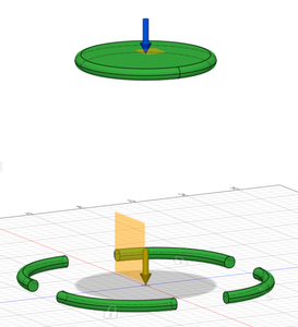

When I simulated this design using the local preview mode, I was getting a lot of variations on a very simple cup, so I decided to add some complexity to the legs by dividing my ring into 4 parts and offsetting them.
Not pictured here is the additional obstacle geometry I created to ensure that no additional material was added to the seat of the stool. This involved creating a new body cube shape that was directly adjacent to the seat.

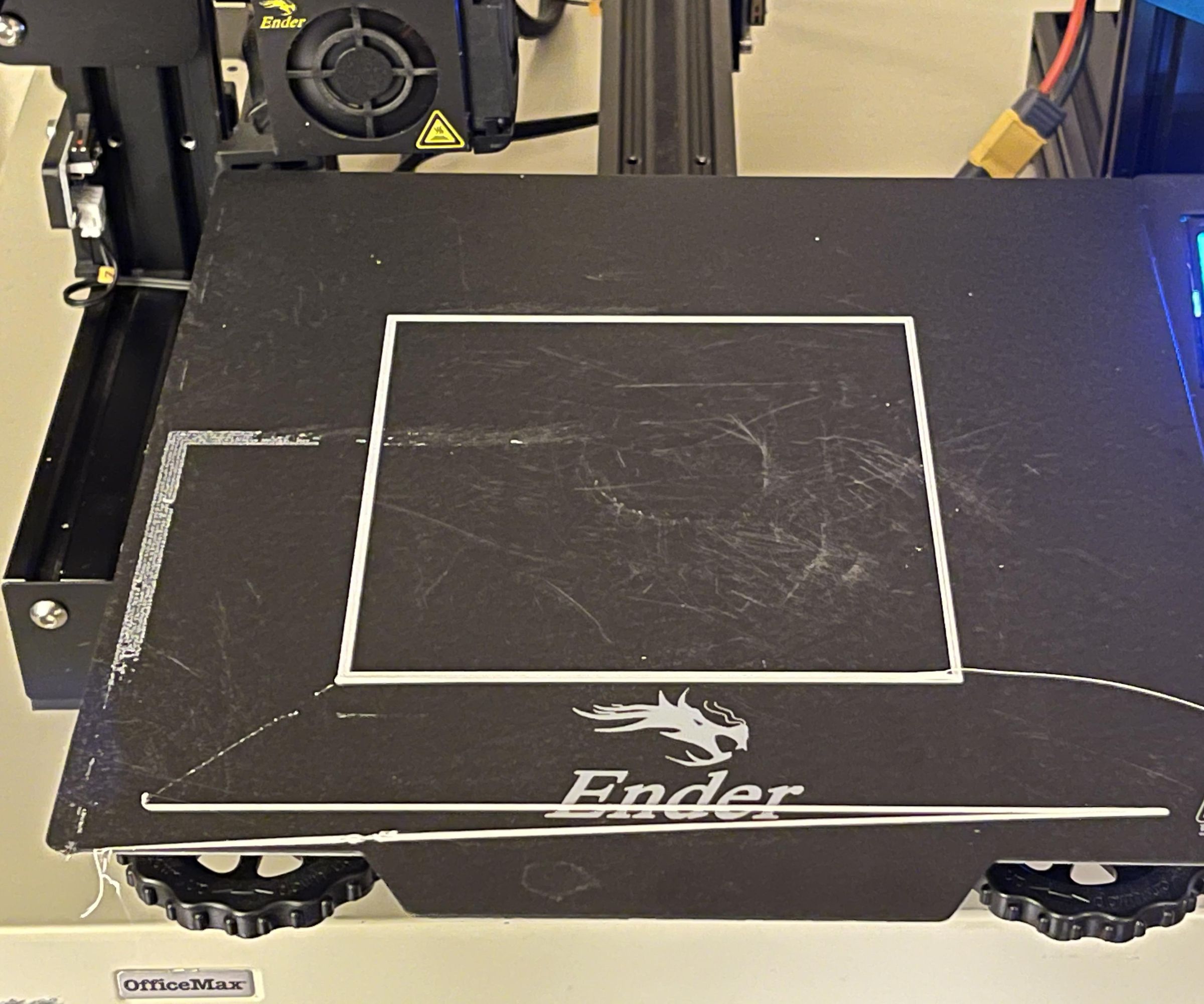

The print is currently printing and will take about 2 days to complete. I ended up deciding to print it with a raft and with full supports. I've had a lot of success printing this way with the Ender 3 Pro I'm using.

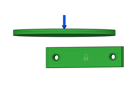

After I was finished with my stool, I learned so much that I decided to create a shelf for our wall that could sustain 10 lbs for tchotchkes I find out in the world or for our keys when we come in from outside.
I haven't printed it yet, but when I do print it, I will be printing this in solid plastic so that it can sustain real weight and be usable as a real shelf, since the studies in Fusion 360 assume solid mass.
