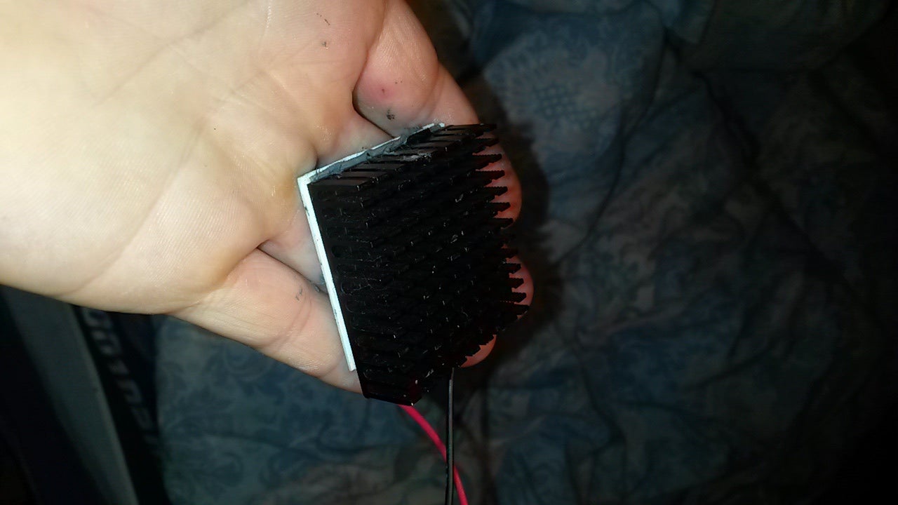

Take the thin aluminum sheet around it, fold it, then stick to the bodyshell around the radiator (so that heat and smoke concentrate in the path), I used a beer can for the bottom but I then remove it then when it is perfect deposited a little thermal putty around the radiator then under the radiator. Let dry and clean the surface well and then grease the thermal grease
You have to take a small radiator for the hot, I try different but the best is this size for the oil flame.

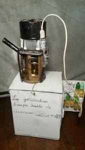

I tried to put 2 usb and I can put the light and recharge my phone or use it at the same time.
in the future I would operate, drill other objects,
I will install a liquid cooling with a mini-pump.
It does not consume and more when the oil starts to heat up becomes more powerful, I take vials of liquid e-cigarette for oil.
