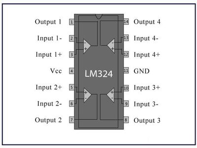

Step 1: LM324 Photodiode Sensor or Infrared Proximity Sensor
LM324 is an operational amplifier consists of four channels. It is most commonly used amplifier due to its low cost factor. It consists of four amplifiers per package and is superior to other amplifiers for single supply applications. Negative power supply included in common mode input and output range eliminates the need of external biasing. It has several different applications e.g. DC gain blocks, transducer amplifiers, conventional amplifier circuits etc. LM 324 is shown in the figure given below.

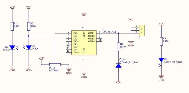

Step 2: Schematic Diagram
The first thing that We need to consider in the PCB process in the schematic diagram, attached you will find the orignal schematic diagram with the components used for the board, We made again the schematic from the Arduino schematic website.
You can get the schematic diagram : HERE
