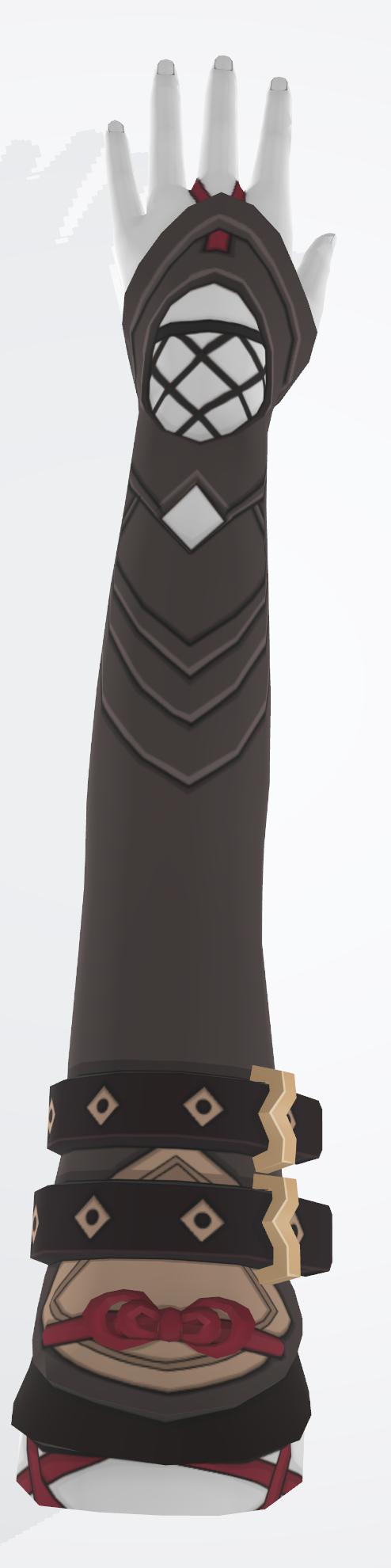

To make a double loop bow, choose your base (parallel ends or half-knot). Here we are using a half-knot. Pick a side and wind it such that you have 2 complete loops. Note that in this case, the free end points to the right. Take the other side and wrap it up and around the middle of your loops, be sure to come down on the left of the middle, because the next step is to take your free end through the loop you have just created and you want this free end to point to the left. Tighten everything up and nudge things such that all the crossing action happens on the back side of your bow.
The most obvious example of this is Shikanoin's arm armour lacing, but various other bows could be interpreted to be this.

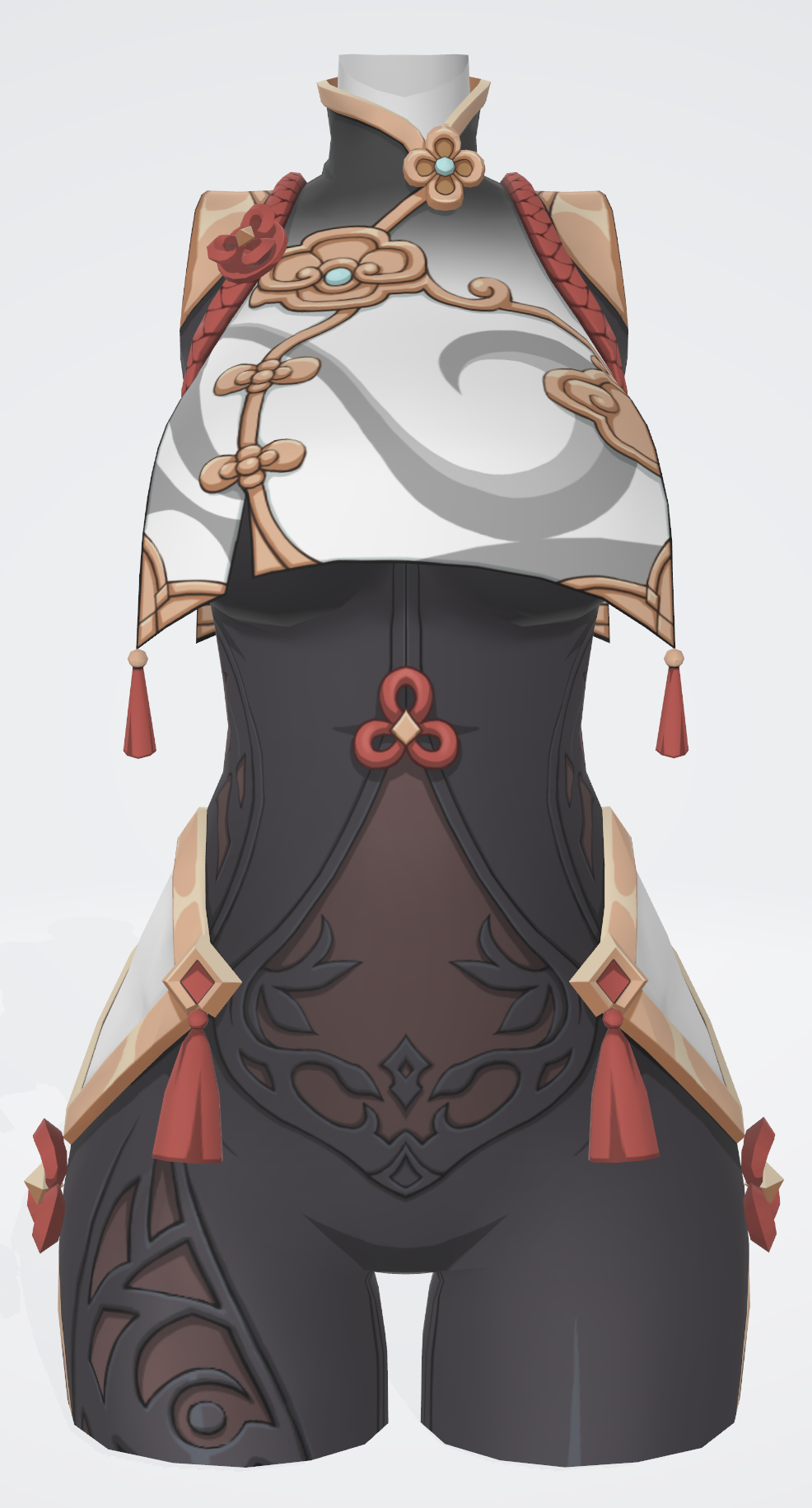

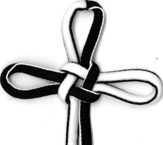

Step 5: Cross Knot With Ears
Yun Jin's many knots could be interpreted as bow knots descending from a top loop. They could also be interpreted as cross knots with ears. Her hair ties (as well as Ayaka's verified by official animated art), in particular are definitely cross knots with ears. Ayaka's hair ties as well as Ayato's shoulder armour (pauldron?) knots are cross knots with the vertical line most prominent. Additionally Kujou Sara's right sleeve garter (?) is the same with the top loop pulled to the back and used to encircle the arm.
Just for Yun Jin's cross knot with horizontal line most prominent (since I could not find it elsewhere) here's an instruction set. The side ears are just the loose ends pulled through the sides of the knot.

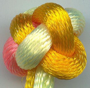

Step 8: Double Coin Knot

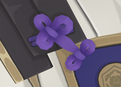

The behind the scenes view of some "knots" as found on the Games Fashion Archive show blobs with cord coming out. I'm therefore interpreting some of these string-y blobs as known existing knots.
Shikanoin Heizou's fortune knot is modelled as sort of a squiggle. I'm choosing to interpret it as a double coin knot or josephine knot.

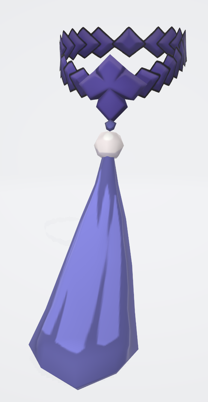

Step 9: Carrick Bend Mat
Yun Jin is covered in knots (which we've addressed above), but the middle of her big feature "fortune knot" is mostly obscured by a metal ornament. The back view of the 3d model shows modellers who weren't modelling what doesn't show. I choose to interpret this feature knot as a one pass carrick bend mat. Of course, because the middle is obscured by a metal ornament, we can pull the end through the middle willy-nilly to complete the mat and serve as vehicle for the tassels.

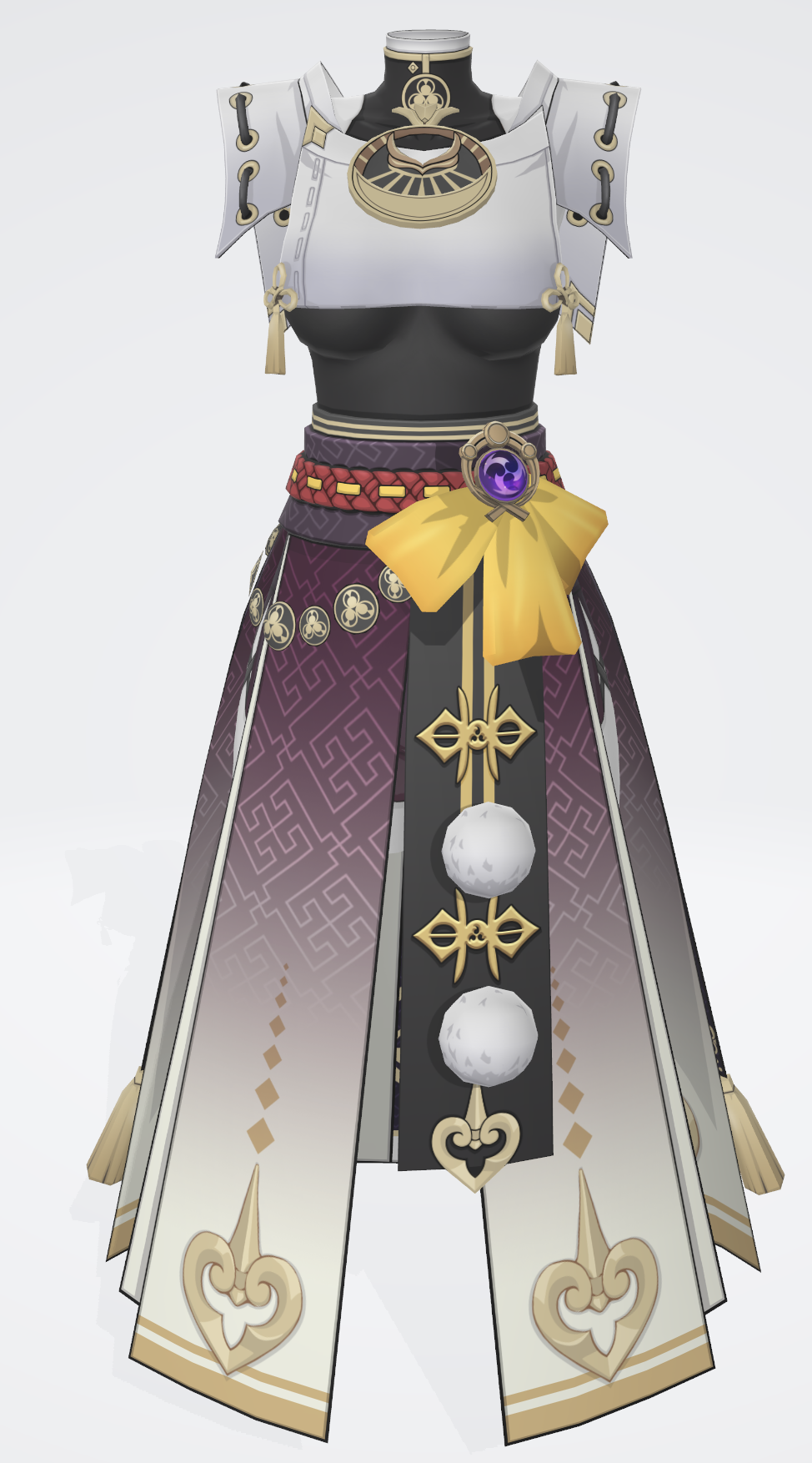

Step 10: Double Connections
If you are looking at a small bead of a knot that interrupts 2 parallel cords, you are probably looking at a double connection knot (DCK) as on Yanfei's hat just below the coins. The knot below it that looks like a DCK with 2 side loops is actually the back side of the double centre bow, although the incoming and outgoing strands will not sit so parallel without coaxing and sculpting via sewing.
Instructions for the sideways version of the double connection knot is shown here as you'll need it for Sayu's scarf. Sayu's sandals also appear to have a sideways double connection knot, but if you bring a cord around to split it as it is on the sandals it just won't look right. The DCK is a small and fragile knot, so extra editing is highly problematic. Although, maybe if you tied it loosely and then reinforced the structure with thread before attempting to split....?
That said, adding extra loops to either side from the middle as on Kujou Sara's mask will work as long as you are extra careful with the tightening.
Step 11: Double Connections With Side Ears
This is the knot that started my Genshin Impact journey. As mentioned above, the double connection knot is fragile, so introducing extra side loops from within the structure versus added on after as for Kujou Sara's mask is tricky. By pure happenstance, the string closest to hand when I was experimenting was paracord which is squishy sort of stuff as cord goes and actually worked pretty well. With firmer, more slippery cord the knot does not really want to hold. This will be especially evident as you refine the knot, adjust loop sizes and tension. You will need to use thread to reinforce the structure. This knot features on Beidou's caplet and boots, Kujou Sara's top, and Xingqiu's fortune knot. Xingqiu's knot is 2-toned in a way that I am not certain will work without custom dyeing of your cord. Xiangling's vision crystal knot could also be interpreted as this knot, but I'd suggest the cloverleaf instead.

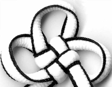

Step 12: Sauvastika Knot

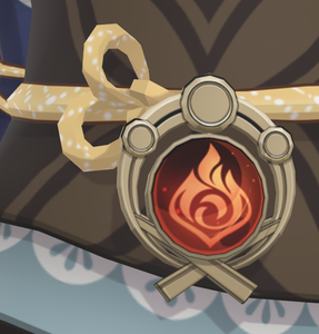

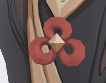

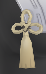

Step 13: Cloverleaf Knots
Shenhe is covered in 3 eared cloverleaf knots. Xingqiu's garter must also be one. Yoimiya's vision crystal knot could be one as well.
The 4 eared cloverleaf knot is everywhere. Prominently on Kequin's fortune knot and choker. Ayato's neck (?) tie . Ganyu's vision crystal knot and shoe ties. I choose to interpret Kuki's shoulder decorations as such. Similarly Yae Miko's back bow ornament, bottom front on her dress, various sleeve ornaments, and shoes. Shenhe's top button and mid-back ornaments could be interpreted as knots vs solid metal objects.

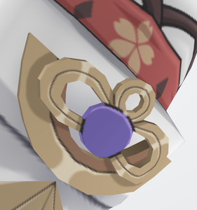

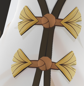

Step 14: Button Knots
Speaking of buttons, the Chinese button knot is a functional part of many real world garments. How they are rendered in the game makes it hard to tell in many cases if they should be or if you should sew a decorative thing to your garment but use snaps or hooks as the actual closures. For Xiangling's neck button, do some research on button frogs otherwise known as pankou (盘扣/盤扣). Shenhe's tunic/bib buttons could be interpreted as the classic pipa frog knot.
