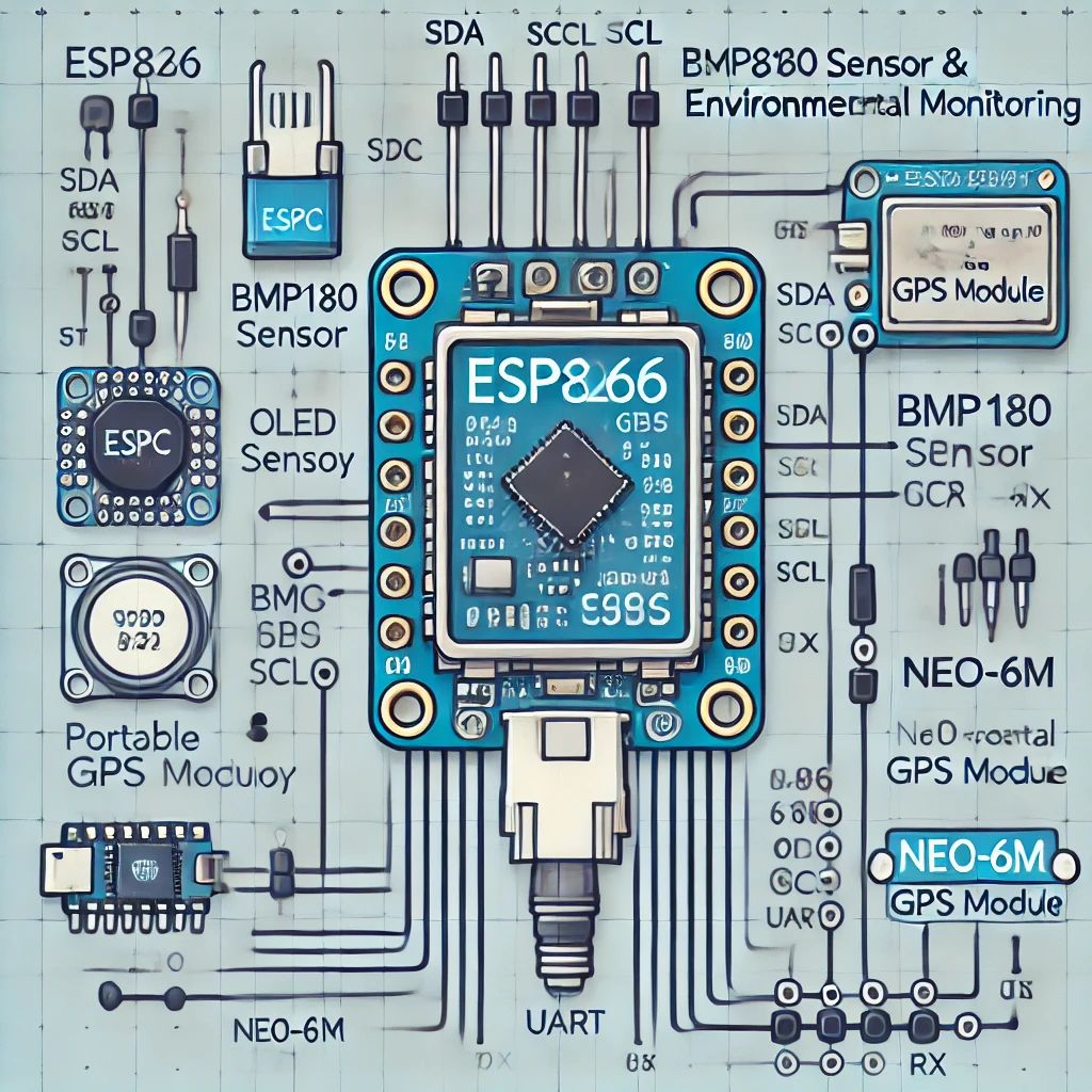

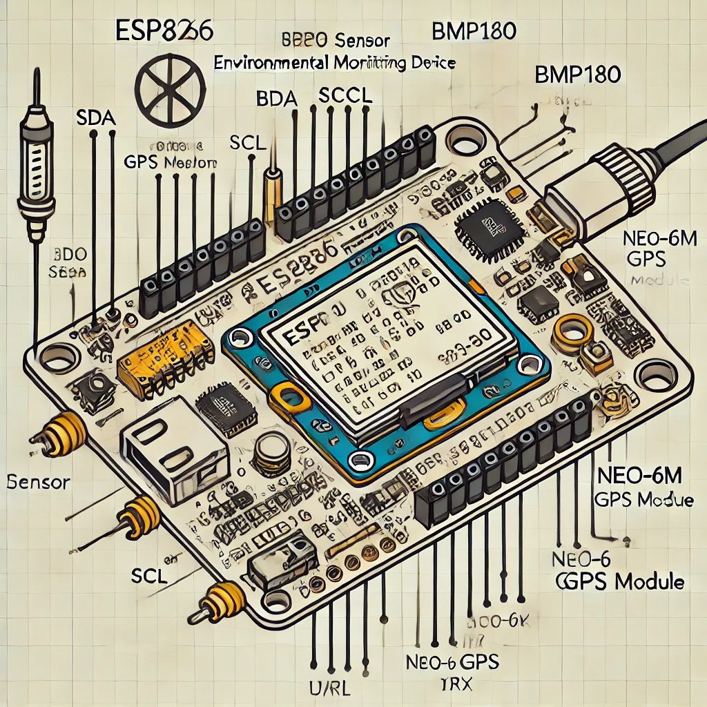

Step 1: Schematic
Components:
- ESP8266 (NodeMCU) – Main microcontroller
- BMP180 – Sensor for measuring temperature, pressure, and altitude
- NEO-6M GPS module – For real-time GPS tracking
- 0.96" OLED display – For displaying GPS and sensor data
Connections:
1. ESP8266 to OLED (I2C communication):
- OLED VCC → ESP8266 3.3V
- OLED GND → ESP8266 GND
- OLED SCL → ESP8266 D1 (GPIO5)
- OLED SDA → ESP8266 D2 (GPIO4)
2. ESP8266 to BMP180 (I2C communication):
- BMP180 VCC → ESP8266 3.3V
- BMP180 GND → ESP8266 GND
- BMP180 SCL → ESP8266 D1 (GPIO5)
- BMP180 SDA → ESP8266 D2 (GPIO4)
3. ESP8266 to NEO-6M GPS Module (UART communication):
- GPS VCC → ESP8266 3.3V
- GPS GND → ESP8266 GND
- GPS RX → ESP8266 D7 (GPIO13)
- GPS TX → ESP8266 D6 (GPIO12)
THESE IMAGES ARE AI GENERATED ONLY FOR ENTERTAINMENT
