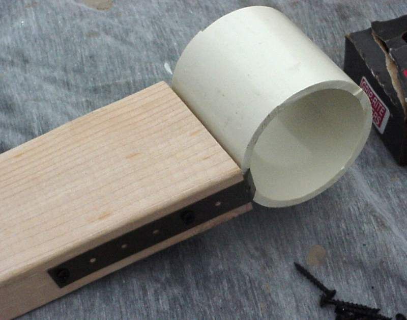

    Another alternative for the connectors, is PVC pipe sections, and plumbing strap. You have to cut the end of the board at an angle, but it makes a fairly strong connection. The pipe is a little big in these pictures, optimally, it should be just big enough for all the pieces of wood to fit around.
