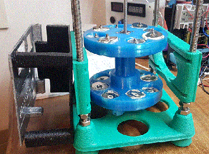

This is an efficient motor or generator unique as far as I know in design. It does have a lot of similarities and is mainly designed, (I believe improved) on the Adams motor as published by Robert Adams through Nexus magazine. I have made many magnet motors over the last 10 years and have found this design stands out from the rest for torque and consistent cool running low energy cost to output. On my measurements this is approx. 20% more output rpm then the previous version.
By angling the magnets on the rotor, I have made an out of balance motor / generator that is always trying to rebalance itself. Magnets are naturally attracted to Iron and this fundamental aspect is what makes it more efficient then many other motor / generators. In this model I have combined both phase drive coils onto the one rotor. It could be redesigned and increased to multi phase on one rotor it could also be stacked and have multi rotors. I am thinking of building a really big one with multiple rotors to drive a lawn mower. To drive a vehicle would require a clutch mechanism where this is being used as a flywheel motor.

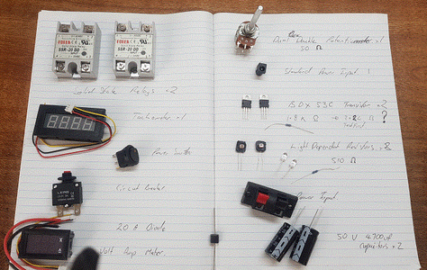

I will try to repeat the parts you require as I work through each section. Following is a basic list to start.
4 x 10mm and 1 x 6mm threaded bar, 8 x 45mm length x 10mm Outside diameter roll pin, 8 x 6mm grade 8 bolt with a counter sunk head, 19mm bearings, electrical wire, 2 x 60v 20A SSR (solid state relay), LD Resistor, Diodes, 50v 4700uf capacitors, 4g 6g stainless screws, 2 gang potentiometer, Conductive paint or foil, 10mm Alu rod stock .5 m, various 3d filament, Power supply, 4 pin plug,5A Circuit Breaker. 30mm neodymium ring magnets 5mm thick, glued and m4 stainless bolts to hold into place, 4+ cans of spray clear lacquer suitable for plastic.

1 x Timing holder and 1x timing tensioner. Depending on the type of LDR (light dependent resistor) you have available wire in a 5mm Led and LDR as recommended by the manufacturer of your components. Leave more then enough cable to reach the board ( approx 350mm ) cut off excess later to tidy up when you use your 4 pin connector plug.
I used a 510 ohm resistor on the negative side and wired the two LED's in series so the LDR got full positive input. I used one positive line in to power the LDR and the LED giving me a positive signal out. Depending on what LDR you use you may have to check that the signal out is not drawing too much current through your trigger switch and over heating it.
I used a BDX 53C transistor (with 1.8 K Ohm resistor on the transistor signal input ) to signal a 60v 20A SSR (solid state relay) this runs cool and helps with the efficiency.
If you use a Tacho meter, mine had to have another transistor that would give a positive signal out.

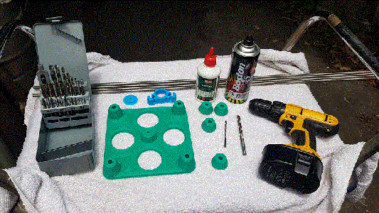

You can cut now or later the Stainless Steel threaded bar to 500mm lengths. When it's finished and you are happy you can take the excess off it should be 30mm but wait until the end in case you want to add to the top etc.
The Centre hole needs to be threaded for 6mm to suit your threaded bar. I pre drill to 5mm then use a 6mm tap. You could grind a notch into a 6 mm bolt and use it to gently work in a thread if your stuck for a Tap.
The 4 Foot supports get threaded with 10mm to suit the big bar.
Pre drill your base and thread with a 10mm Tap then assemble with foot supports.
On the top I used a 10.5mm drill because it needs to be removed many times during testing, fixing etc. So the easier it slides on the better.

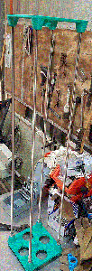

Assemble your parts so far. Screw 2 nuts on each rod about 50mm. Screw bar through the base and use the feet to tighten. As long as you get the 10mm Rod tight into the foot at least 10mm then tighten down the nut.

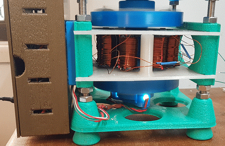

Step 2: Drive Coils and Holders
Next is to start with the drive coils and holders.

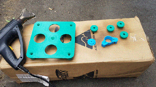

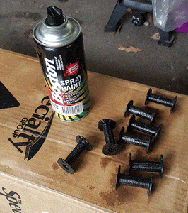

Start printing: Make sure to lacquer spray all parts to strengthen and protect.

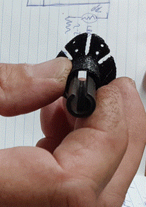

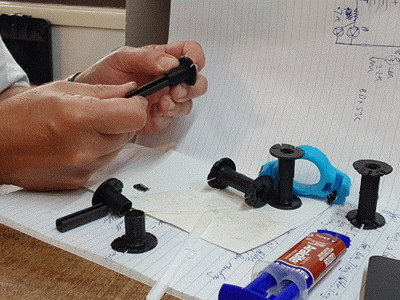

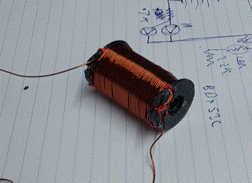

16 x Drive coil They are a bit delicate, use good quality filament these will need to last.
Glue 2 Drive Coils onto each of your 8 x 45mm length x 10mm diameter roll pin , lining up the slot with the gap I have made in the print. This is where you feed the wire through to loop back to the start. I used a spray can, clear lacquer as the glue and sprayed the part when I was happy with it for protection. If needed re-glue with araldite or similar.

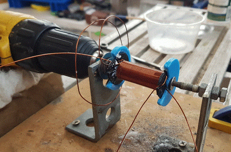

Wind your 8 coils, take your time it gets frustrating. In the V2 model I am building for this project I used 30m of 0.7mm Magnet Wire. You can use whatever you have available there's heaps of room if you only have insulated wire available. I bought a big roll and use it on all the different machines I build as it seems to be a good size for these magnets and roll pins. 30m of wire gave 9+ layers. I leave at least 150mm excess on each end to make it easier to solder etc when wiring it up. As I wound the coil, I brushed PVA glue over each layer to strengthen and protect.
The coils are wired in series with 2 groups of 4. You could do groups of 2 or even single but this will draw more current and speed up the machine encouraging more losses higher rpms and risk of injury or harm. Beware high velocity could hurt someone probably you or your family. For experimenting purposes 600rpm to 1200rpm is more then enough. When you have perfected it then you can easily re wire it to run as fast as you dare but please start out slow.
Print 4 x Coilholdermounts

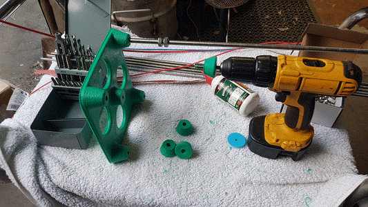

Drill out with 10mm or 10.5mm to make easy to slide on. Slide 2 onto the threaded bar now pushing down to about 20mm of the base. One of these will be the front of your machine the other will be the back. Put 2 more nuts on each threaded bar one to tighten down the other to support the next Mounts . No need to tighten yet this will be done when rotor is installed and everything adjusted to height.
Later I also covered the outside of mounts with aluminium stick on, this acts as a static collector and neutralises any build up of stray charge. The 10mm nuts & rods act as conductors. I left the mount at the front blank as its too close to the main control box.
Print 4 x Coil holder bottom and 4 x Coil holder tops.
Drill out the top hole with 6mm drill bit and clean out countersink/ taper the hole as best you can to accept the 6mm grade 8 bolt with a counter sunk head neatly to the surface. Tap the other coil holder bottom with the 6mm thread same as you did for the base. Bolt in the coils the same way up for each one you will have 2 cassettes. I ground down my bolt heads a bit so they weren't too mushroom headed but still held down in the counter sunk hole.

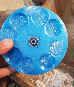

If you want to run smoothly at highspeed take time with your rotors. Use good filament, centrifugal forces can build up with the rotor this will be the part that fails at high speed if not done properly. The weight of the magnets may shred the rotor at high speed. It could explode and fragments will be thrown around you. Be aware of the danger act in a safe responsible manner. Go slow use a safety shield when first testing keep others away until you feel its proven itself to be safe. I run mine no more then 1500 rpm.
Start printing: Make sure to lacquer spray all parts to strengthen and protect. I used pillars support for the Bearing Journals and the Disk Body Centre. Pre drill the screw holes 2mm for timing light 3mm for 6g screws else where.
1 x V2 Disktop
1x V2 Diskbottom
1x Timing ring
1x Connecter Socket Male
1x Connecter Socket Female

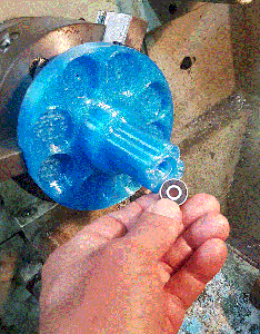

I made the design of the rotors 2mm undersize for my bearing journals so I could machine them out on the lathe and have a nice fitting bearing. It took about 15 minutes on each part. If your school or friends don't have a lathe take it to any machine shop. Hopefully their interest in what your doing, will encourage them to help you out and not over charge you on the job. Alternatively edit the bearing journals and print to the size of your bearing. You wont be able to run at high speed but it will still run. I removed the dust seal from my bearings for less friction.
Install your magnets stainless bolts M4 x 20mm with locknuts for this V2 rotor with 32 of the 30mm x 5mm ring magnets all same orientation (north or south facing up) on the disk. Use a good quality glue ( I used water activated Gorilla Glue ) pre drill all the 4mm bolt holes so they slide in easy.

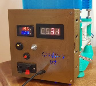

Step 4: Control Panel and Board
Your nearly ready to run your motor.
Start printing
1x Control Board
1x Control Panel
2 x Control Box spacer

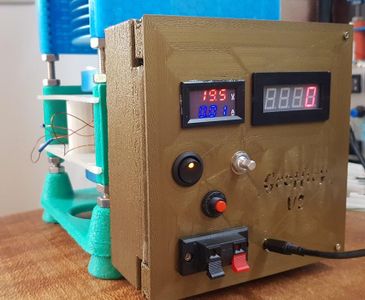

I used 2 x 6mm x 50mm bolts to attach the front panel in hinge and screwed off to front, low enough so the coils could slide out without being obstructed.
I use a 12v -14v battery to start. when your confident then swap over to a power supply that can plug into the wall for reliable power. It's your choice how to supply the power and ultimately what sort of experiments you'll be running when completed, indoors, outdoors, etc.
I used a speaker terminals clip style socket for battery input its colour coded I also allowed a hole beside that for a 12v power supply plug you'll need at least 30 watts supply. Alternatively you could go straight to a laptop 19v power supply. Cut off the output plug and replace with one that suits your socket. Be careful you don't burn out your transistors or LED's though.
Use a Diode for protection. I used it on the negative and ran the negative through the 5 A circuit breaker up to the Amp meter. You don't need an Amp meter or a tachometer but it will tell you if your drawing too much current and let you know what's going on inside the circuits / motor without the need for an oscilloscope. Then I run to the capacitor on the SSR (Solid State Relay).
I brought the positive up through the switch and into 50v 4700uf capacitors attached straight to the SSR on the negative side, before the coils. This way when the SSR switches there's heaps of power ready to run through the coil. The coils are statically charged positive to the power supply awaiting the SSR.
I use the SSR as a common where I can tap into for power for the Timing light LED's and LDR. I also used it for the power for the signal transistors I used a variable resistor at first to stop the transistor from drawing current as a signal when I found the right resistance I then hard wired in a resistor to suit. If you are drawing more then 15watts when running check your transistor temp it's probably heating up. Everything should run cold on this machine no cooling required.
I used a double potentiometer to bleed off the positive signal to negative from the LDR and again a variable resistor until I found the right value then hard wired in a resistor. Now you have 2 tuning methods the potentiometer to hold the signal on for longer and turning the timing light for early or late firing of the coils. if you can use an oscilloscope and you will see what's right or wrong.
If you can't get a volt meter you could make a little panel with LED's at different resistance values to give the voltage. If your using a power supply it should remain constant.
When you think your ready to go, give the rotor a turn with both hands then turn on the switch. The motor should turn a couple of times and stop or go faster or go backwards, turn the power off. Don't leave the power on if it's not turning this may draw heavy current through your coils and burn them out. Don't be disheartened now is the time to look closely at where the rotor stopped. Whichever coil aligns with the rotor magnet is the coil that needs to be energised to repel the magnet. Turn your timing light holder one way or the other until the LDR is signalling the SSR that coil is aligned with the slot on the ring. The motor prefers one direction, mine is running anti clockwise it will depend witch way up you installed the rotor. Once you have it aligned it may still not run, reverse the polarity of your coils to make sure you are pushing and not pulling the rotor.
