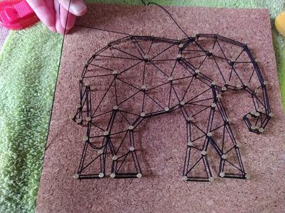

Step 5: Start With the String
You can really start anywhere you like, tie a knot on one nail, move on to the next and turn it around, making sure the thread is outside the nails.
Step 6: Continue
You don't really need to cut the thread, but cut it if you need to.
Step 7: Double Line
After I did all the edging on the outside, I did it on the inside to make a double line.
Step 8: Triangles
Play with the thread and the nails in the middle to create triangles.
Step 9: Finishing
I ran the thread several times around the edge to make it thicker, when it's the way you like it, tie knots in any nail and cut off all the excess. You can paint the head of the nails with a black permanent marker or black nail polish, this is optional.
