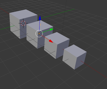

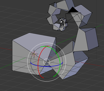

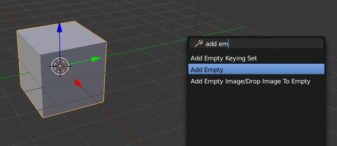

2. Add an 'Empty' to the blender scene: Hit space-bar and type 'add empty.' Select Arrows. Three black perpendicular arrows labeled x, y and z should appear where the red and white circle is.
3. Add the Array Modifier to the cube: After selecting the cube, (with a right click!), in the left-hand panel, (the properties panel), click the little wrench symbol (modifiers). Select Array. This will open a sub panel with the various buttons and parameters that control the array. Uncheck Relative Offset, which is the default, and check Object Offset. Under Object Offset click the grey box (with a little orange cube in it). A list of all the objects in the scene, besides the cube, will drop down. Select "Empty." This is the default name blender assigns.
4. PLay: That's it! Now you can select the Empty in the 3d window and move it, scale it, rotate it, and create all sorts of lovely fractal spirals or nested matryoshka dolls. You can adjust the number of copies in the array ('Count'). You can also make a copy of the array by clicking the 'Copy' button in the array panel. This will make a copy of the array you just made. If you associate this with a different empty then you can make some pretty nutty patterns. Such a simple tool, so many possibilities. Check out some of the images in the first step to see some examples.

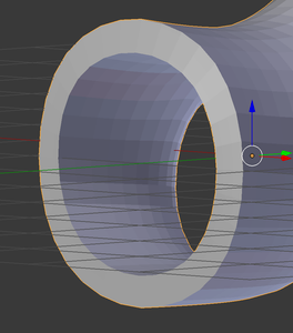

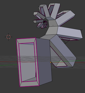

1. Turn the cubes into square tubes: Select the cube, hit 'tab' to enter edit mode. The individual elements of the mesh are now visible: faces, edge, vertices. Now switch to Face-Mode by pressing ctrl-tab, or clicking the little cube-with-orange-face icon at the bottom edge of the 3d window. Select the two faces (right-click) and then hit 'x' or 'delete,' and finally type 'f' to confirm the deletion of faces.

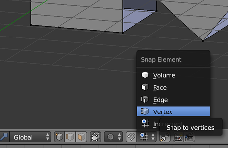

3. Make all the geometry in the array Snapable. In the Array Modifier Panel, click the little triangle to make the vertices of all the elements in the array active, so that they are 'snap-able.'
4. Using Vertex Snapping: Click the little magnet icon for snapping, and next to it select Vertex. Now left-click on a vertex, type 'g,' for grab. Now when you drag the mouse it will move the vertex about. With vertex-snapping active, the vertex will 'jump' to exactly match the position of another vertex. Right-click to accept the new location of the vertex.
In this case I decided to just join the two inner vertices, and leave to other ones open.
5. Set Merge in the Array Modifier Panel: Activating the 'merge' checkbox will make vertices within the set distance fuse. When the modifier is applied (at the very end) the object will then be one contiguous mesh. An alternative to this is to only use vertex snapping to insure that the vertices are exactly in the same place, and after applying the modifier use the 'remove doubles' command to effectively merge any coincident vertices. Note that if you set the distance for merging to high, it may merge stuff you don't want to intend. This is especially important with scaling arrays with very small elements.

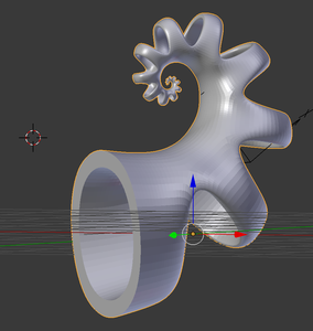

Step 3: Apply Subdivision Surface Modifier

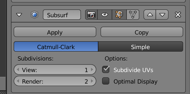

1. Apply Subsurface Modifier: To get an idea of what the final model will look like, apply a Subdivision Surface modifier, which smooths out the mesh. If the 'merge' check-box in the array modifier panel is not active, the subdivision surface will cause the elements of the array to shrink in on themselves, leaving a bunch of disconnected meshes.
By changing the number of subdivisions in the Subsurface modifier panel ('view' is the important one here) you can refine the smoothness. Having too few subdivisions might result in visible facets in the 3d print. Having too many often results in huge numbers of faces, which can slow down blender and post processing steps. 2 or 3 is usually good. If the length scales of the faces are close to the minimum length scales that the 3d printer can resolve (i.e. the resolution) then there is no reason to have more subdivisions.

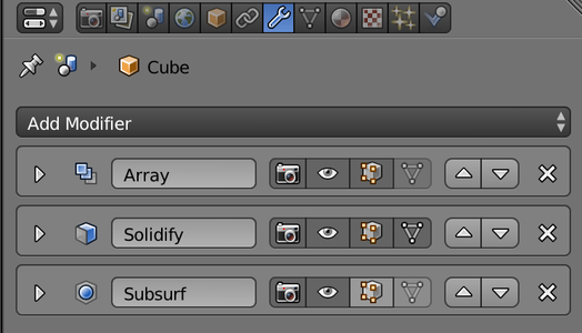

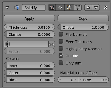

1. Add Solidify Modifier: Right now the model is a surface. It needs to be a volume, represented by bounding surface, in this case the mesh. Add the solidify modifier and chose a thickness that looks sturdy but not excessive for the 3d printer. Since the array is scaling, features can get really thin.
2. Insure Correct Modifier Order: Make sure the order of the modifiers, from top to bottom, is 1) Array 2) Solidify 3) Subsurface. To change the order the modifiers get applied, click the little white up or down arrows. Try changing the order and see how that changes the shape. (I wasted a bunch of time initially because I had solidify first and had to do extra manual editing to make sure the shape had a single, connected inside. Sometimes I find it's better to start a model over completely when I realize there is a more efficient workflow!)

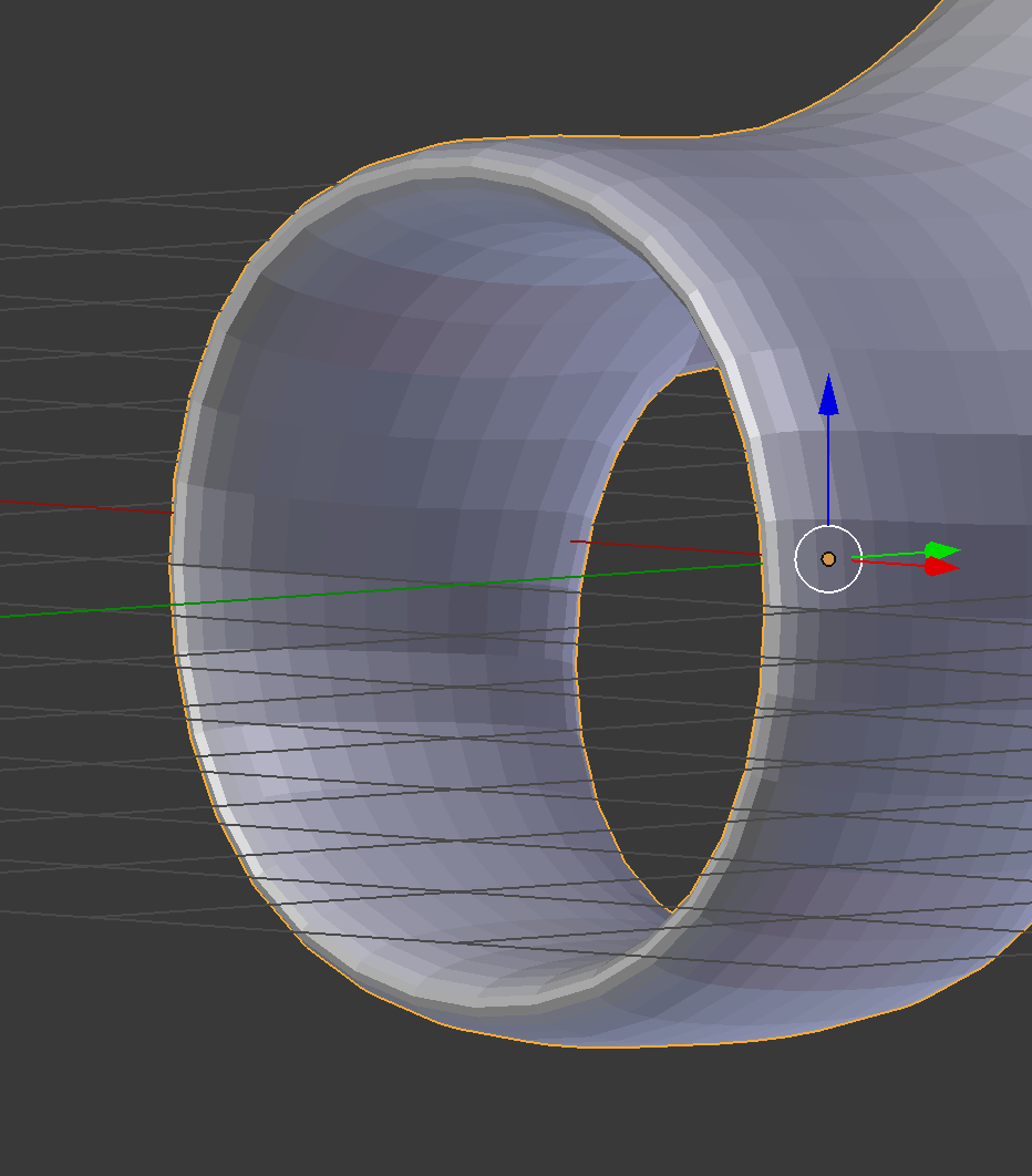

In order to successfully print the shape on Ember, an SLA (sterolithography) printer, I knew from experience that it would be good to have a perfectly flat surface so that the object could stick to the build-plate. The subsurface modifier makes everything rounded and smooth, so...
1. Select the Edge Loops: In edit mode, with edge-mode active, select one of the edges of the base of the shape while holding 'shift-option.' This will select the entire loop, which is super useful if you are dealing with a mesh with tons of edges.
2. Set the Crease value: Type 'n' to toggle the visibility of the 'properties shelf,' a panel on the right side of the 3D-window. At the top of this panel is the 'Transform' drop down thingy. Set the Mean Crease value to 1.00. This will turn the selected edges magenta. Try setting the subsurface modifier visible, and you will see the effect.

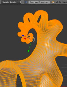

1. Apply the Subsurface Modifier: Switch to object-mode and apply the subsurface modifier, with your preferred number of subdivisions. Now you have created the final mesh! Do a double check that everything looks nice, toggle 'z' to see in wire-frame mode, which will make it easier to spot weird internal features.
- Hit spacebar and type 'select non manifold,' which will highlight edges that have more than two faces on them or edges that only have one face. Both of these cases will mess up your mesh, so if you find some you must remove extra faces, or fill holes. It is much easier to deal with these problems before the modifiers have been applied. Use undo to get the subsurface modifier back.
- Type 'a' to select all the vertices/edge/faces. Switch to face mode (command-tab), and then hit spacebar and type 'remove doubles' to remove any double vertices. It will tell you how many were removed up at the top. If it says zero, very nice.

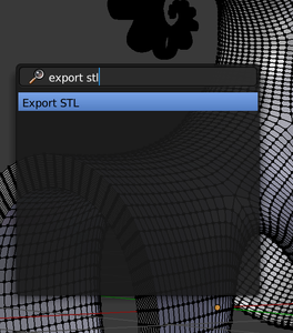

2. Export Stl: To export from Blender hit the space-bar and type 'export stl.' The .stl file format is the current standard file format for 3d printing.

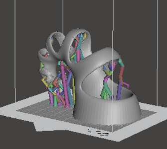

Step 8: MeshMixer Support Structures
Any sufficiently overhanging part of the model is likely to fail, since a layer at that spot includes a disconnected region which will just float away from the model after being solidified (this is SLA specific).
1. Set Support Settings: Click the little wrench/screwdriver icon next to 'Add Supports'. Set Y-Offset to 0mm, to keep the flat base on the build platform. Set the angle thresh to 19. Under 'Advanced Support' check 'Allow Top Connections.` Also in advanced support set 'Strut Density' to ~70. Set Optimize to something like 30. Go here to get an idea of what 'Optimize' means in this context.
2. Generate Support and Iterate: Click 'generate support.' The created structures may not look the way you want. Perhaps you imagine needing more supports, or needing to support larger patches of overhangs. Click Remove Supports, change some settings as you see fit, and do some iteration.
3. Remove Horizontal Spans: Unfortunately MeshMixer puts in some horizontal spans, which will not print well, since they are also overhangs. Hold command (I am on mac) and click the span to remove. There is no 'Undo' so be careful.
4. Manually Add Support: Click a region of an overhang to generate a support touching that point. Or click and drag an already existing support to add strength to supports or touch another part of the model.
5. Export Stl: Once it looks well supported, click 'Done' and export it.
