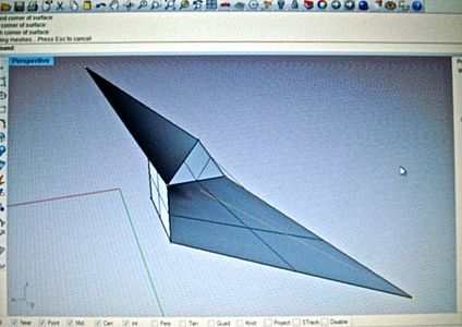

- first, make the object a mesh (using the icon my shape is pointing to on the left in the first picture)
- remove the mesh so only the polysurface is left
- use the "UnrollSrf" command on the polysurface (make sure: Explode=Yes, Labels=Yes)
-next you want to "scale" your pattern depending on what size pillows you want to make. This depends on what you are using as a printer. I used 11in x 17in paper to print with.
*If you would like to make your shapes bigger, you can use a CNC machine to draw out your plans with a marker directly on your fabric or paper*
- once the pattern is to scale save the file as a 3dm file and open it up in Visual Mill where you can then print out your plans.

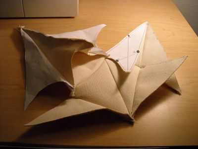

- place corresponding numbers back to back so the the paper side is facing out and the edges are parallel
- because the canvas is strong you probably wont need to pin them in place, but if you want to, T-pins are the way to go
- sew the shapes together, sewing into the paper, using the lines as your guide
Note: not all the edges will have corresponding numbers, so don't be afraid if at first your shape doesn't make sense. Once you start sewing your shape will start to take form and you will be able to piece the rest of it together by referencing back to your 3D model in Rhino.
- once you get to a point where you don't need the plans anymore you can remove the paper
*the super 77 makes the canvas a little sticky, something to keep in mind if you wanted to keep this side facing out*
