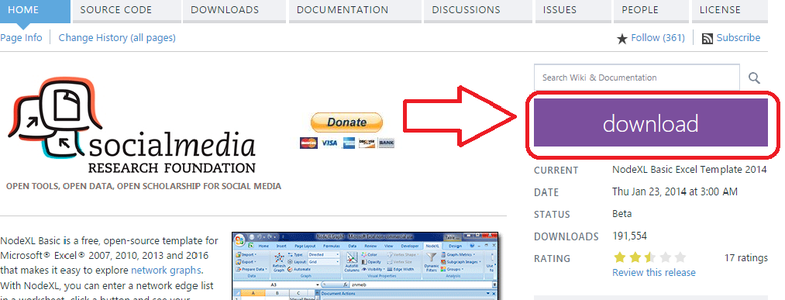

1. Download NodeXL.
Download NodeXL from https://nodexl.codeplex.com/.
Go through the download process. Figure one shows where to find this link at.

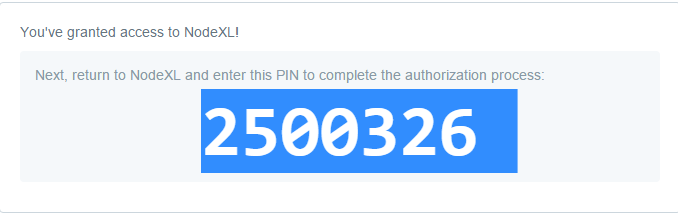

You will also have to authorize your Twitter account the first time you do this. Click on “I have a twitter account, but I have not yet authorized NodeXL to use my account”.
When you click "OK", this will take you to twitter.com and allow you to login or create a new account.After you login into Twitter, authorize NodeXL to use your account. You will get a code from Twitter. This is shown by figure 4.
After you get this pin, go back to NodeXL and enter in the box that states “PIN from the Twitter authorization Web page”.
You have now authorized your account to be used by NodeXL to gather data.

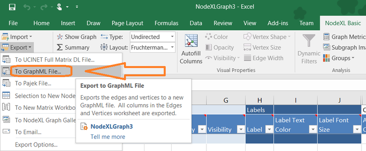

To use this data in Gephi, you need to export in a format that Gephi can read. To do this in the NodeXL tab click on export, this is right under import. Next click on “To GraphMl File”. This is the format that Gephi reads the data.
It is shown in figure 5, what type of data needs to be exported.
This will transform the data into a useable format for Gephi. Save this file where you would like to and name it whatever you want to. You need to remember where this file is located..

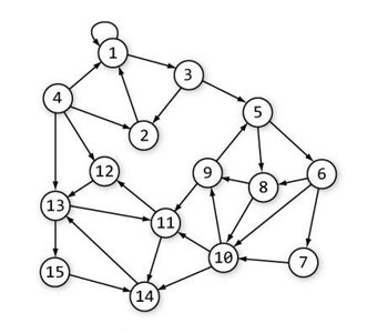

Directed graph –It is a graph where all edges are directed from one node to another. Twitter for example is a directed graph. In twitter a user would follow certain users, but they do not have to follow them back. This makes who follows who a directed graph. To the left is an example of a directed graph.
Undirected graph – It is a graph where the edges points both ways to both nodes. An example of this is Facebook friends. Everyone is a friend with whoever is a friend with them. Figure 1 is an example of an undirected graph.
Degree- how many nodes the current node connects to. The Degree of Node A in figure 1 is 3. The Degree of Node C in figure 1 is 2.
InDegree -how many directed edges are pointing towards it. The indegree of Node 2 in Figure 2 is 2 and the indegree of Node 10 is 3.
Out degree - how many edges point away from a node. The outdegree of Node 4 is 4, and the out degree of 2 is 1. Eccentricity This will tell you how centrally located each point is.

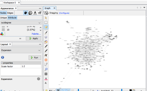

First, go to button left and click under layout, where it should say “choose a layout”. This is shown in Figure 1.
Use Force Atlas2. This will sort your data in a way that is based on the amount of connections in the nodes.
After running Force Atlas2, run expansion to push the nodes as far apart as you would like. This will make reading the data easier. The data should look like Figure 2.

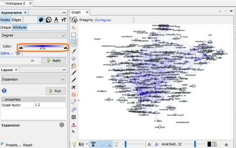

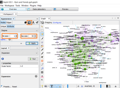

“Choosing an attribute” under the paint tab and while under the nodes tab will allow you to edit the color of the nodes.
Two features that will be helpful to change the nodes colors is degree and eccentricity. The first feature is changing the color by degree. The higher the degree the darker the color will be. If the data being use is from twitter, the same can be done with in and out degree.
You can change the color by double clicking on the bar highlighted below. This will allow you to change the color to any one you want. The bar is highlighted in figure 3. You can also drag the arrows of the color bar to change how dark the lines are.
You can use the same method, but with eccentricity. It will tell you under the tab what each size and how the close the points are compare to eccentricity. There are many other options that can be also applied.

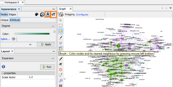

Another feature that is very useful is changing the size of each node. This can be done by clicking the 3 circle button. The options here are the same as the one before. But instead you can choose a size of the circle instead of the color of the nodes. The location of this is shown in figure 4.
You should use this to change the opposite of what you changed before. You should keep the min size 1, but change the max size to 50, so a difference can be seen.
Two other features that can be edited include the A and Tt. The A you can change the color of the text, which is the user name of the node, and the Tt can change the size of the names. They are fine the way they are and can be kept the same. This is shown in figure 5.

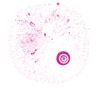

After running Gephi, following the instructions given above, the graph made can be seen in figure 1.

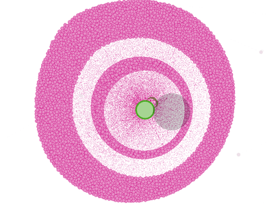

After looking at this data, the first thing that the user should notice is the two ring circle in the bottom right. This can be seen in figure 2.
From this we can see how all the points are related to the center dot. From this we know the green dot is definitely a leader in the conversation about Net Neutrality. This can be seen by just from how big the node is and that it is central to all of the other nodes. It can also be seen that this is the only point with high eccentricity. This shows that this a great target to either follow if you want to learn more about Net Neutrality, or direct tweets at if you would like to get the attention of a large pool of people.
Looking at the rest of the graph it seems as most clusters are randomly scattered. This shows how it may be hard to find another connection that connects as many people as the green dot from above does. However, you can also tell from looking above that the gigantic dot is hardly connected to the outside. This makes it seem like this user might be specific to a certain area of the world or topic in this debate. In this example the green dot happens to be the leader of the Net Neutrality movement in India. This shows how you still need to understood the context of the user. This might not be the best user to use, unless you are focused in that region, and you may want to look in other of the random clusters to see if you can a better point to use.
