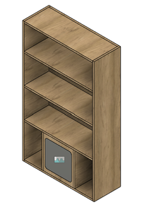

After deciding on what features we wanting on the bookshelf, we began sketching out how we would make it, and what extra details we would need to do. We got the specified dimensions for the shelf by measuring out each book size that we needed to fit, and how many we would need to fit on each shelf. Using those dimensions, we added some space of tolerance to account for any potential problems, and to allow for someone to pull out a book without much struggle.
Step 2: Modeling
Our next step, after sketching out the design we wanted, we then began to model it in Fusion 360. On Fusion we used subtractive processes to begin our design. Then we separated bodies in Fusion to create each board that we would need, and extruding into the design in the portions where no boards would remain in the final design. Lastly, we worked in VCarve to carve out the outline of Germany onto one of our wood boards. Then, taking outlines and sizes from VCarve, we went to lightburn to save the paths for lazer cutting the cities onto the outline.
