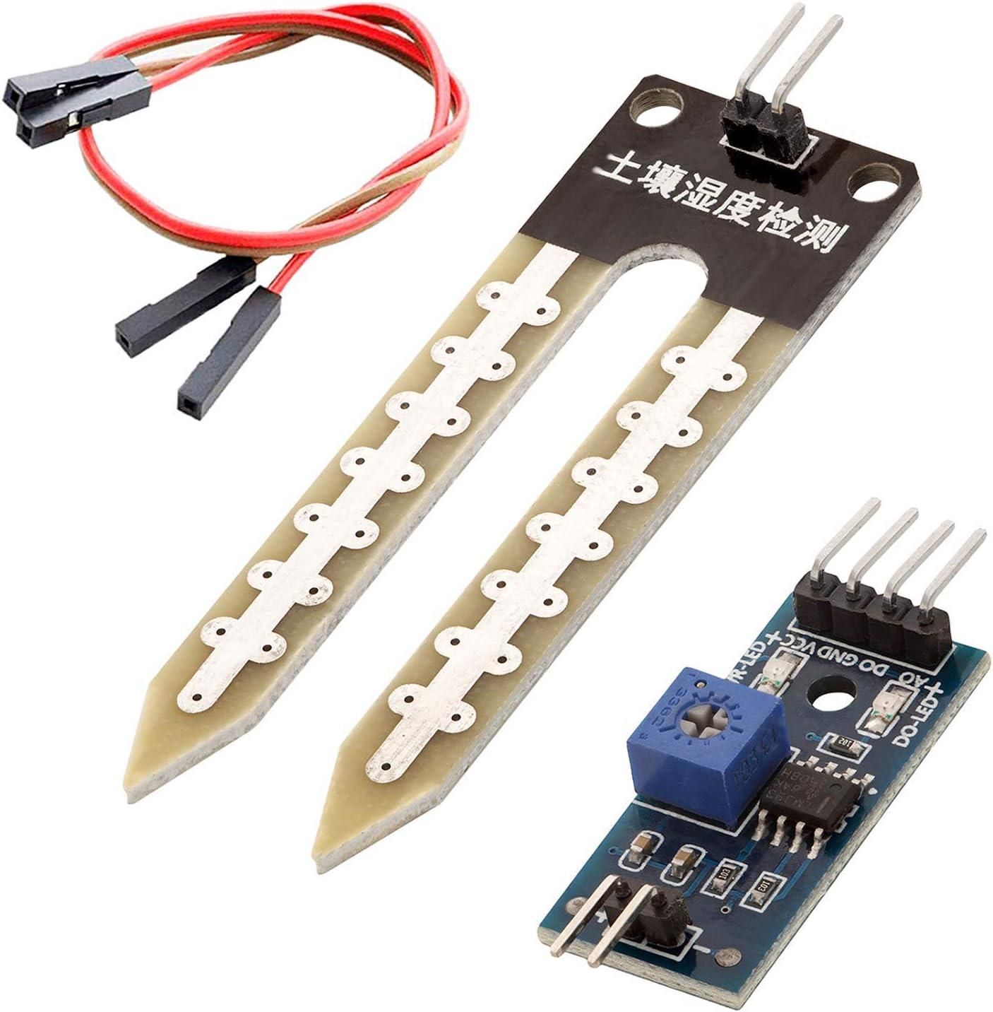

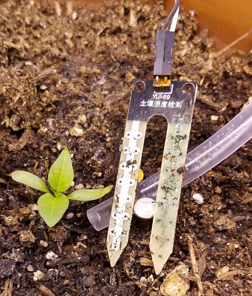

Most inexpensive soil moisture sensors available on the market are resistive sensors. These use two exposed metal probes that are inserted into the soil. The sensor works on the principle that wet soil conducts electricity better than dry soil.
Measuring Soil Moisture
How Resistive Sensors Work:
  1. The probe consists of two open conductors.
  2. The resistance between the probes varies depending on the soil's moisture level:
  3. High moisture → lower resistance
  4. Low moisture → higher resistance
  5. The module (e.g., FC-28 / YL-69) includes an LM393 comparator and provides:
  6. Analog output (A0) proportional to resistance
  7. Digital output (D0) when moisture crosses a threshold
āš ļø Resistive soil moisture sensors suffer from rapid probe degradationin wet environments due to corrosion of the exposed electrodes. This significantly reduces their lifespan. The way out of this situation is to use a homemade soil moisture sensor, in which the probes can be changed very quickly and inexpensively if necessary.

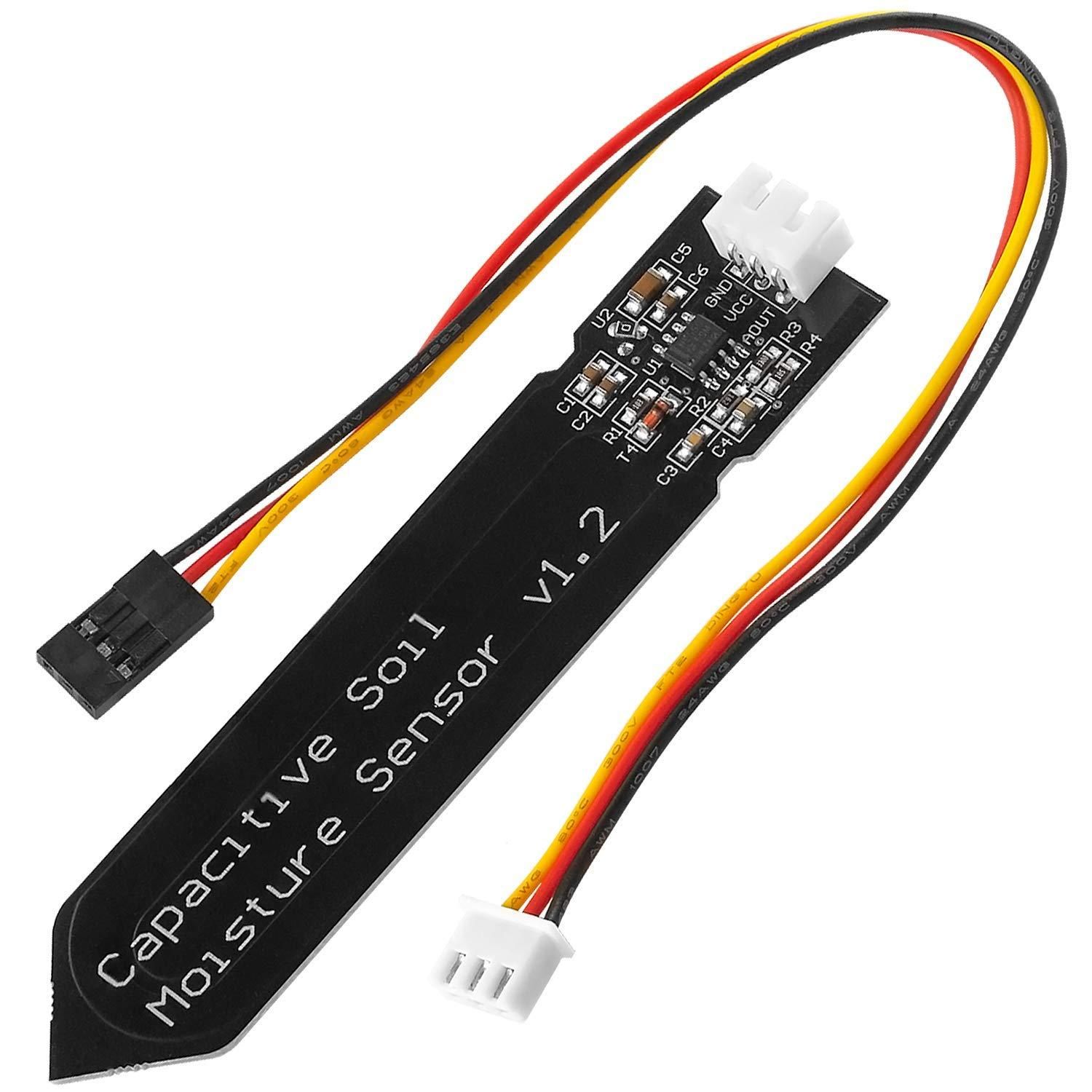

Luckily, there’s a better option: capacitive soil moisture sensors. Capacitive sensors offer a more robust and accurate solution:
  1. Measure soil moisture using capacitive sensing, not conductivity.
  2. Built from corrosion-resistant materials, giving a longer service life.
  3. Provide more stable and accurate readings.
How Capacitive Sensors Work:
  1. The sensor detects changes in the dielectric constant of the surrounding medium.
  2. Water, being a strong dielectric, affects the measured capacitance more than dry soil.
  3. The output is analog and must be interpreted using an ADC (Analog-to-Digital Converter).
āš ļø These sensors do not measure water content directly, but instead infer moisture from dissolved ions and soil composition. For example, adding fertilizer will change the reading even if water content stays the same.

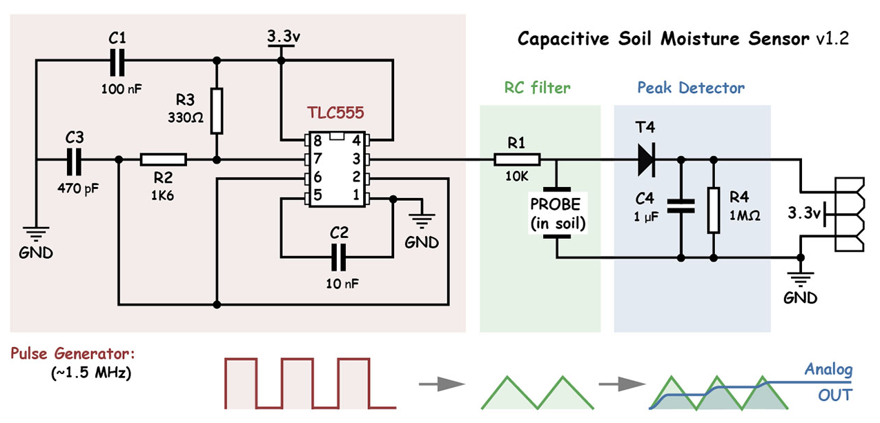

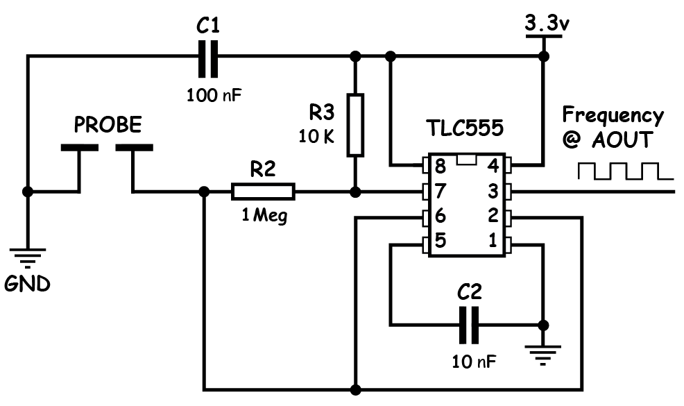

Basically, these modules use a 555 timer configured as an oscillator, which acts as a pulse generator producing a square wave. The frequency and shape of the square wave depend on the values of two resistors, Ra and Rb, as well as a capacitor.
In this design, the oscillator produces a 1.5 MHz square wave. The square wave output from the 555 timer is then fed into an RC integrator circuit, where the capacitor is formed by the soil probe itself. The integrator converts the square wave into a more triangular wave, which is subsequently sent to a rectifier followed by a smoothing capacitor. This process generates a stable DC voltage output proportional to the soil’s moisture level.
In this project, the key hack is to use only a TLC555 timer, with the soil probe acting directly as the capacitor in the oscillator circuit. This means that the oscillation frequency becomes (almost) directly proportional to the soil’s moisture level, since the dielectric constant of the soil (and thus its capacitance) varies with moisture.
Instead of generating a DC voltage output like traditional analog sensors, this setup produces a square wave signal, and the moisture level is inferred by measuring the frequency of that signal. As the soil becomes wetter, its capacitance increases, which lowers the frequency of the square wave—and vice versa. You can see in the attached video the changes in the square wave signal frequency when the soil probe is placed in a glass of water (the experiment was conducted using a test PCB designed during the project).
With this setup, a calibration phase is required. It involves measuring the frequency of the square wave signal at the output of the TLC555 when the soil probe is in open air and when the soil probe is submerged. From these two frequencies, the minimum capacitance Cdry and maximum capacitance Cwet of the soil probe can be determined.
  1. Cdry = 1.44 / ((Ra + 2 * Rb) * fdry)
  2. Cwet = 1.44 / ((Ra + 2 * Rb) * fwet)
Once calibrated, you can calculate the measured capacitance and determine the soil moisture percentage using the following formulas:
  1. Cmeasured = 1.44 / ((Ra + 2 * Rb) * fmeasured)
  2. Soil moisture (%) = ((Cmeasured - Cdry) / (Cwet - Cdry)) * 100
(The formula to determine the capacitance from the frequency comes from the TLC555 datasheet.)
In conclusion, I chose to use a TLC555, along with the necessary resistors and capacitors in the circuit, to measure soil moisture. In the next section, we will look at the list of other sensors I selected to perform the remaining measurements. Good news—things will be much quicker from here! No more epic TLC555 stories, I promise šŸ˜‡

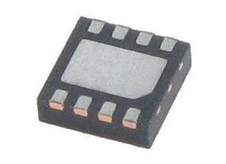

SHT40
The SHT4x is a digital sensor platform designed to measure relative humidity and temperature with high precision available in different accuracy classes. It communicates via an I²C interface, offering several preconfigured I²C addresses for flexibility in multi-device setups. The sensor is optimized for ultra-low power consumption, drawing as little as 0.4 μA, making it ideal for battery-powered or energy-efficient applications.
Components and Sensors
  1. Humidity measurement range: 0 - 100% HR
  2. Temperature range: -40°C - +125°C
  3. Accuracy: ±1.5% HR (humidity), ±0.1°C (temperature)
  4. Operating voltage: 1.08V - 3.6V
  5. Current consumption: 260µA (measurement), 80nA (sleep)
  6. Communication interface: I²C
  7. Price: $1.70

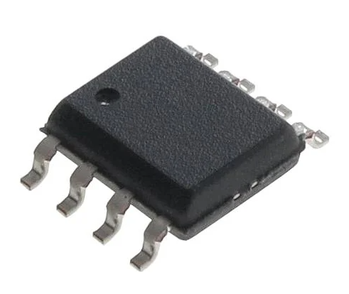

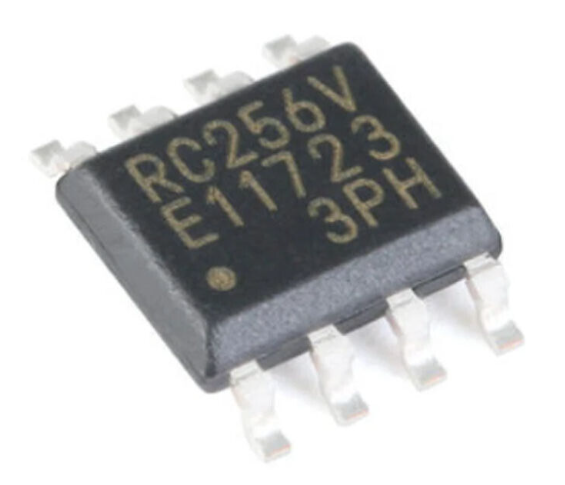

MB85RC256V
The MB85RC256V is a non-volatile FRAM (Ferroelectric Random Access Memory) chip organized as 32,768 Ɨ 8 bits. Unlike traditional flash or EEPROM memory, FRAM combines fast write speeds, high endurance, and ultra-low power consumption. In this project, it's used to temporarily store environment data when the server is unreachable.
The MB85RC256V FRAM has a total capacity of 32,768 bytes. At the beginning of memory, I store metadata related to the calibration and storage system:
  1. Cdry capacitance (uint32_t): 4 bytes
  2. Cwet capacitance (uint32_t): 4 bytes
  3. Number of stored reports (uint16_t): 2 bytes
  4. Index of the first report (uint16_t): 2 bytes
  5. Timestamp of the last synchronization with the DS3231 RTC (uint32_t): 4 bytes
This totals 4 + 4 + 2 + 2 + 4 = 16 bytes used for metadata.
Each report has the following structure:
struct __attribute__((packed)) Report {
uint32_t timestamp;
int16_t temperature;
uint8_t humidity;
uint8_t soil_moisture;
uint16_t light;
uint8_t battery;
This structure uses 11 bytes per report: 4 bytes (timestamp) + 2 bytes (temperature) + 1 bytes (humidity) + 1 bytes (soil moisture) + 2 bytes (lux) + 1 bytes (battery) = 11 bytes
I decide to store a maximum of 2976 reports. So the total memory used is 16 bytes + 2976 Ɨ 11 bytes = 32,752 bytes, which fits within the 32,768-byte limit.
At a rate of one report every 15 minutes, that's 96 reports per day (4 per hour Ɨ 24 hours). Thus, 2976 / 96 = 31 days of data can be stored — allowing up to one month of reporting history.
In the project code, a rolling (circular buffer) system is implemented to manage report storage in the FRAM. This means that once the maximum number of 2976 reports is reached, new reports will overwrite the oldest ones, ensuring that the memory always contains the most recent data.
Reports are only written to the FRAM if the server is not reachable at the time the report is generated. However, if there are reports already stored in the FRAM and the server becomes reachable again, then those stored reports are sent to the server and subsequently deleted from the FRAM. This guarantees data persistence during server outages and ensures the memory is cleared as soon as data is successfully synchronized.
  1. Memory Type: FRAM (Ferroelectric Random Access Memory)
  2. Capacity: 256Kbit = 32KB
  3. Operating voltage: 2.7V - 5.5V
  4. Current consumption: 130µA (active), 56µA (sleep)
  5. Read/write endurance: 1012 write cycles per byte
  6. Data retention: > 200 years at + 35°C
  7. Communication interface: I²C
  8. Price: $2.00

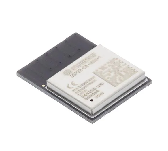

ESP32 C6 MINI
The ESP32‑C6 Mini is a compact and efficient microcontroller developed by Espressif, specifically designed for connected (IoT) applications. It operates on a stable 3.3 V power supply, typically provided by an onboard LDO regulator sourced from USB or battery power. During development, the board is easily programmable via its integrated USB-to-serial/JTAG interface, requiring no external programmer.
In this project, all peripheral components — FRAM, DS3231 RTC, SHT40 temperature/humidity sensor, VEML7700 light sensor, and MAX17048 battery monitor — communicate with the ESP32‑C6 Mini over the I²C bus.

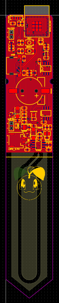

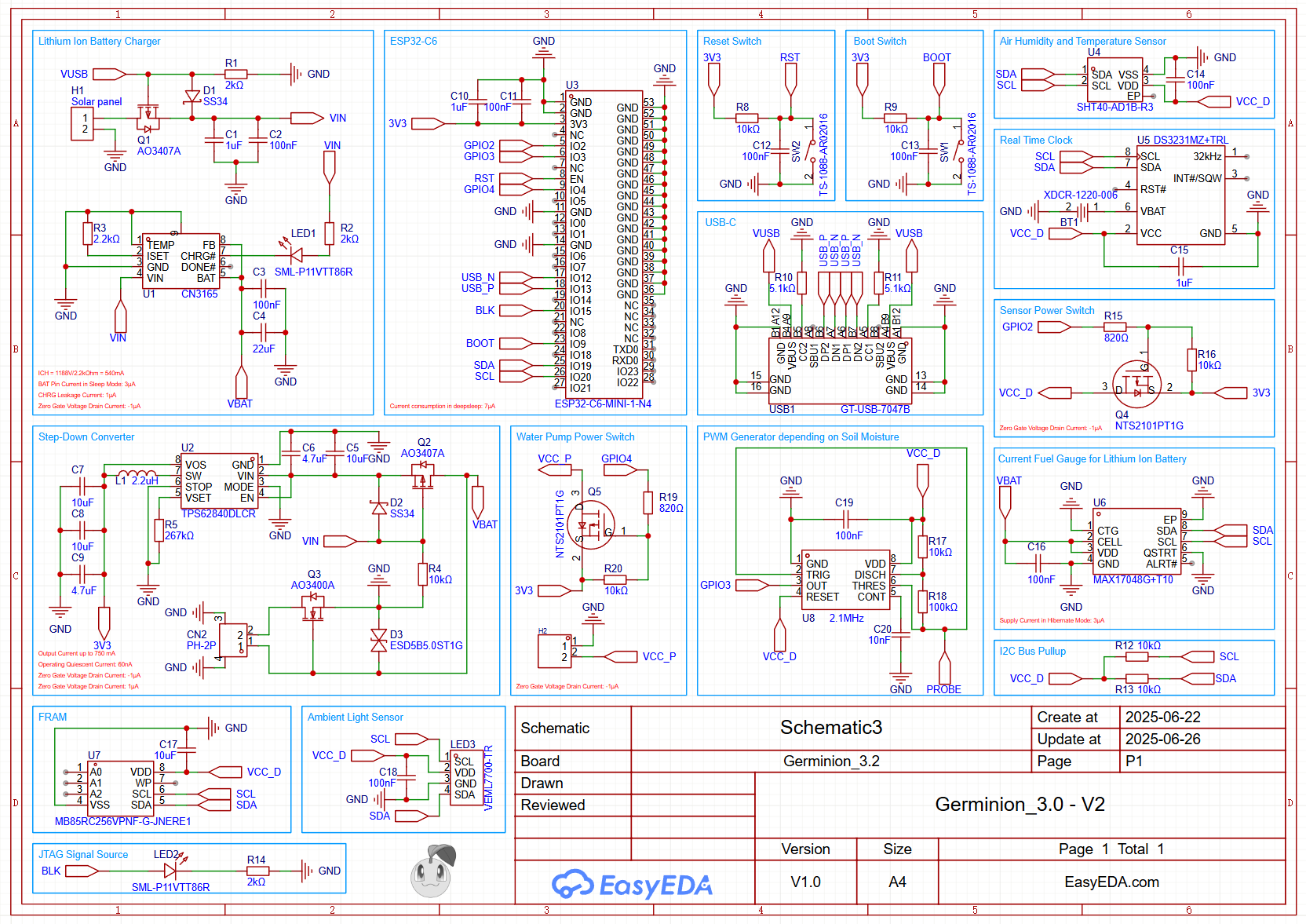

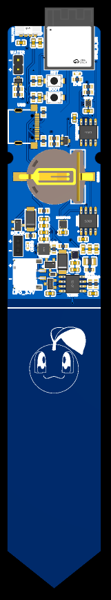

Step 3: PCB Specification

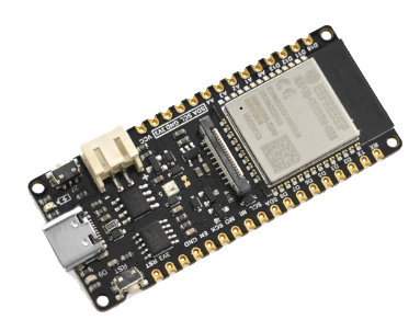

The PCB design is based on the FireBeetle 2 ESP32-C6, a low-power IoT main control board designed based on the ESP32-C6 chip. This board is optimized for energy-efficient applications, with an ultra-low deep sleep current of just 16µA. Moreover, the board can be powered with a lithium battery, and supports battery charging using solar panels.
PCB Specification
The project also integrates the CN3165 chip to manage lithium-ion battery charging, particularly suited for solar-powered systems.
Instead of using the HM6245 as a low-power LDO regulator with a quiescent current of 2 µA, I opted for the TPS62840 — a high-efficiency step-down (buck) converter that offers an ultra-low quiescent current of typically 60 nA, making it ideal for ultra-low-power applications.
To minimize power consumption during deep sleep, the sensors are powered through a NTS2101PT1G P-channel MOSFET, which allows the ESP32 to completely cut off their power when not in use. The same approach is used to control power to the water pump.
PCB Specification
PCB SpecificationPCB Specification

In my current design, the deep sleep current is composed of:
  1. CN3165 charge leakage current: 1µA
  2. CN3165 BAT pin current in sleep mode: 3µA
  3. TPS62840 operating quiescent current: 60nA (negligible)
  4. Zero gate voltage drain current of MOSFETs (AO3407A, AO3400A, and NTS2101PT1G): 5 Ɨ 1µA = 5µA
  5. ESP32 deep sleep current: 7µA
  6. MAX17048 supply current in hibernate mode: 3µA
⇒ Total estimated deep sleep current: ~19µA

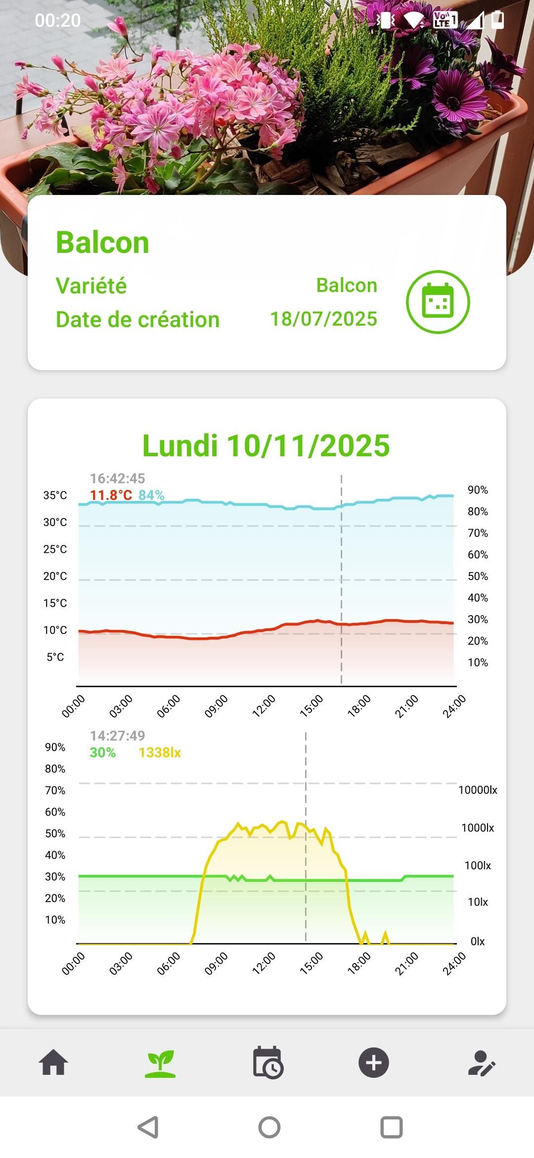

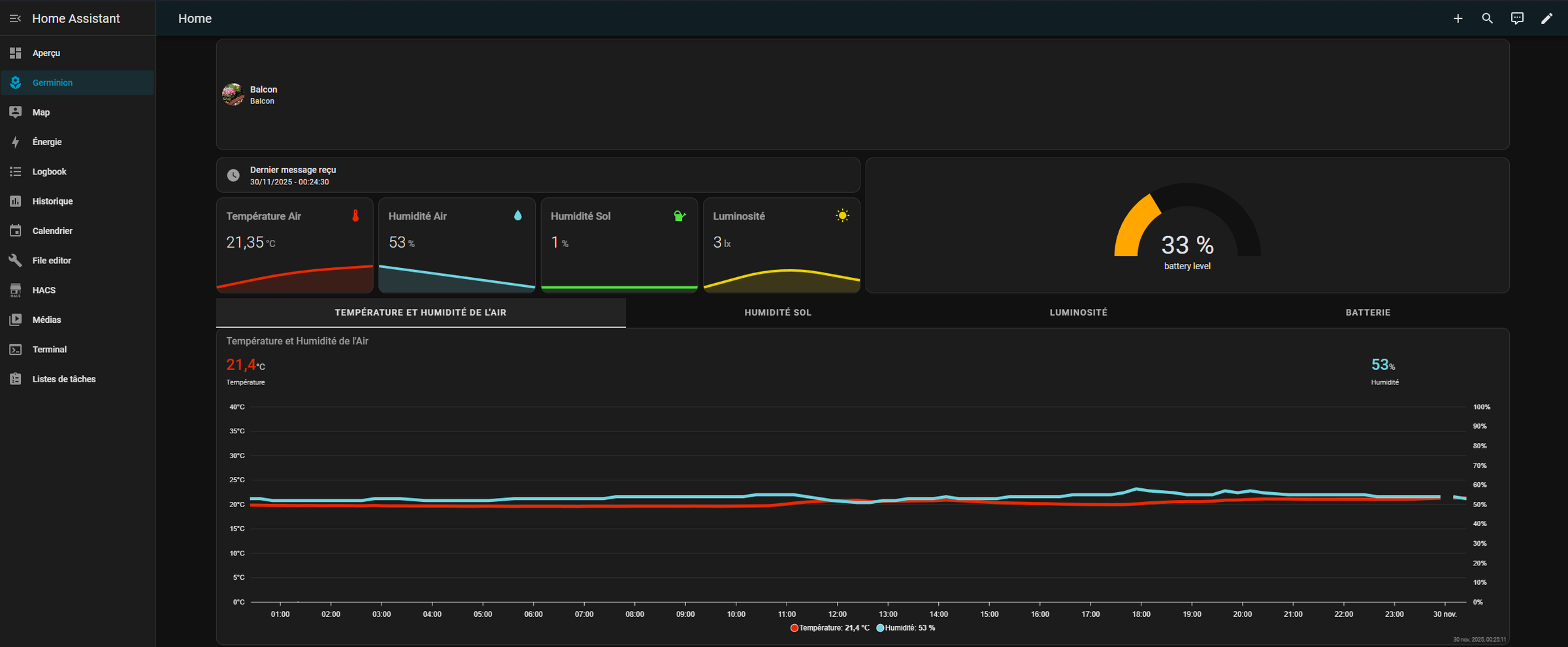

All the data was successfully sent to my Home Assistant dashboard, which runs locally on a Raspberry Pi.
Results

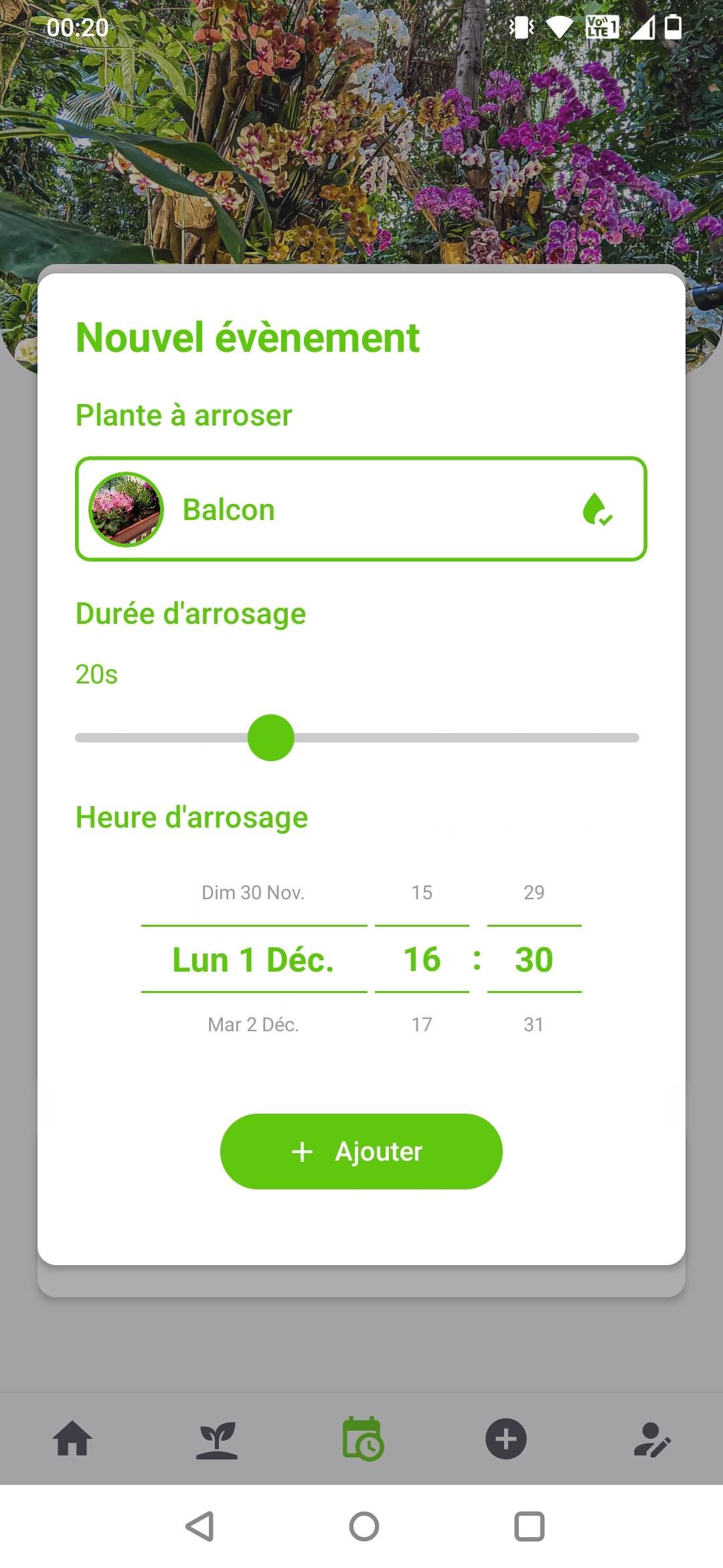

I also wanted to access the measurements from my phone, wherever I was. So, I developed a React Native app that lets me visualize all the data. To make this work, I modified the ESP32 code so it would send data to a Flask API instead of the MQTT broker.
ResultsResults
And I have to say — I’m really happy with these results! šŸŽ‰

Over the two years I spent on this project, I went through several PCB iterations, ran countless tests, and—of course—made my fair share of mistakes. Here’s a short summary of my adventures.
I started with a first version built from easily available modules (DHT22, off-the-shelf capacitive moisture sensor, etc.). It worked, but it consumed way too much power.
So I designed a shield containing all the sensors that plugged directly onto a FireBeetle C2 S6 board. The shield worked great, but I really wanted everything—including the microcontroller and voltage regulators—to live on a single PCB.
After spending way too much time selecting components, studying the ESP32-C6 Mini documentation, and designing the board, I ordered my ā€œcompleteā€ version. And then… after hours of trying to flash it, I discovered that I had wired USB P and USB N to the wrong GPIO pins... Version four finally did the job šŸŽ‰
I also made a dedicated test PCB just to verify the TLC555 setup for measuring soil moisture.
