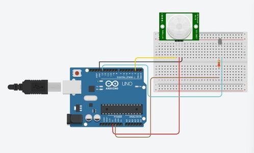

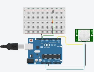

Step 1: Assembling the Circuit
We can create the project by assembling it in website/software such as Tinkercad or physically.
Firs step is to assemble the circuit by placing the PIR sensor, LED, and resistor onto the Breadboard. Then we need to connect the pins from the Breadboard to Arduino Uno board, for the PIR sensor connect the signal to pin 2, VCC/power to pin 3.3v/5v, and connect the ground to GND pin. Alternatively if you are building the circuit physically, you should directly connect the pins to the Arduino uno using female to male jumper. Next is configuring the LED by placing it in different row between the anode(+) and cathode(-) on the Breadboard and connect the resistor leg on either row and on that same row connect a jumper wire to pin 13 and the other LED leg to GND pin.
It is important to adjust the potentiometer of the PIR sensor to modify the timing and sensitivity of the sensor when you are building the circuit physically.
