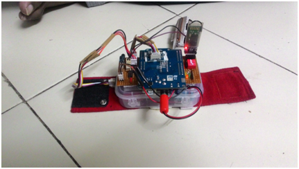

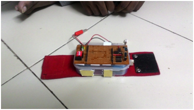

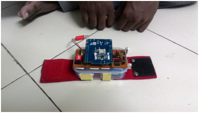

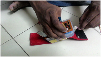

1)Making Shield for Arduino Uno for above mentioned sensors and modules:
2)Mount the Shield on Wearable gadget such as Wrist-Band:
3)Mounting Controller and Accelerometer Sensor (Note mounting position of Accelerometer):

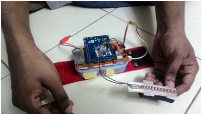

4)Mounting and Connecting Compass Sensor:
5)Connecting Bluetooth module and Flex Sensor:
6)Connecting Batteries and Get ready with wearable gadget:

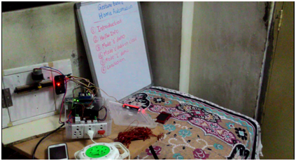

Step 5: Now Let's Begin Assembling Components Together at Edison Side
I am assuming that you are ready with your Smart-Box.
Get 5V power to run the Edison board. Use 7805 as Voltage Regulator in front of the SMPS.
Now connect Modules , Sensors and Relay drivers as follow:
1)Light transmitter At The Door->Pin 2
2)Button for Door bell ->Pin 3
3)Buzzer->Pin 4
4)Port 1 Relay actuator->Pin 5
5)Port 2 Relay actuator ->Pin 6
6)Port 3 Relay actuator ->Pin 7
Now for the motor used for door lock
7)M1 Relay actuator ->Pin 8
8)M2 Relay actuator ->Pin 9
9)Light Receiver At The Door->Pin A0
10)Temperature Sensor->Pin A1
11)Bluetooth RX of edison to TX of BT module and vice versa
12)LCD at I2C pins(Pin A4-SDA,Pin A5-SCL)

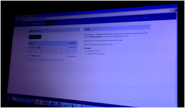

Step 8: Introduction to ThingSpeak Cloud
Once you are done with way2sms.Create
ThingSpeak cloud account and create two new channel .Name Them as Door_Status and Temperature .Name the first field for both the channel as 'field1' .Note down their API keys. You may create two field within same channel instead of two different channels. Follow the Tutorials available on ThingSpeak website for handling channel , Uploading and Fetching data.
Use the following program to transmit data
to ThingSpeak using python script
Enter your API keys for specific Channels in the program
